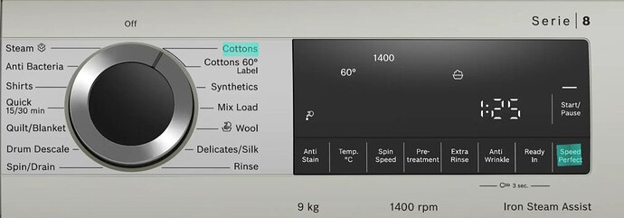

bosch 8 kg series 8

It should have a daily wash cycle. Use that instead of quick wash. On LG’s the equivalent is the intensive 60. You’re looking at a minimum of an hour and it’s only rated for half load
Regular full load on Cottons is 2h30 at a minimum of 40 degrees. Your Bosch will be similar.

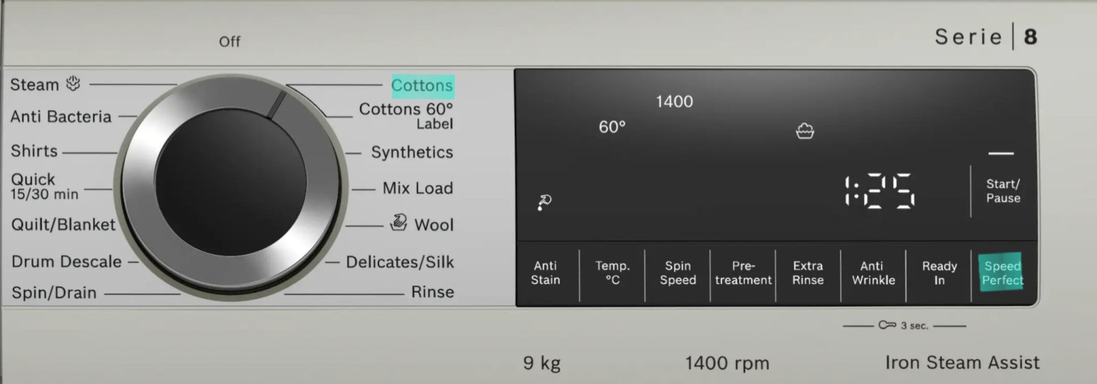

Cottons cycle for normal (enable speed perfect) to heavy soiled (don’t use speed perfect)
Quick wash is for small lightly soiled items so limited in scope
Seems there is no daily wash on series 8. Cottons then with speed perfect for shorter duration (how short?) is what I would use for daily wash with this machine
Wonder if Bosch has weight detect like LG. Does the cycle time adjust automatically depending on load?
