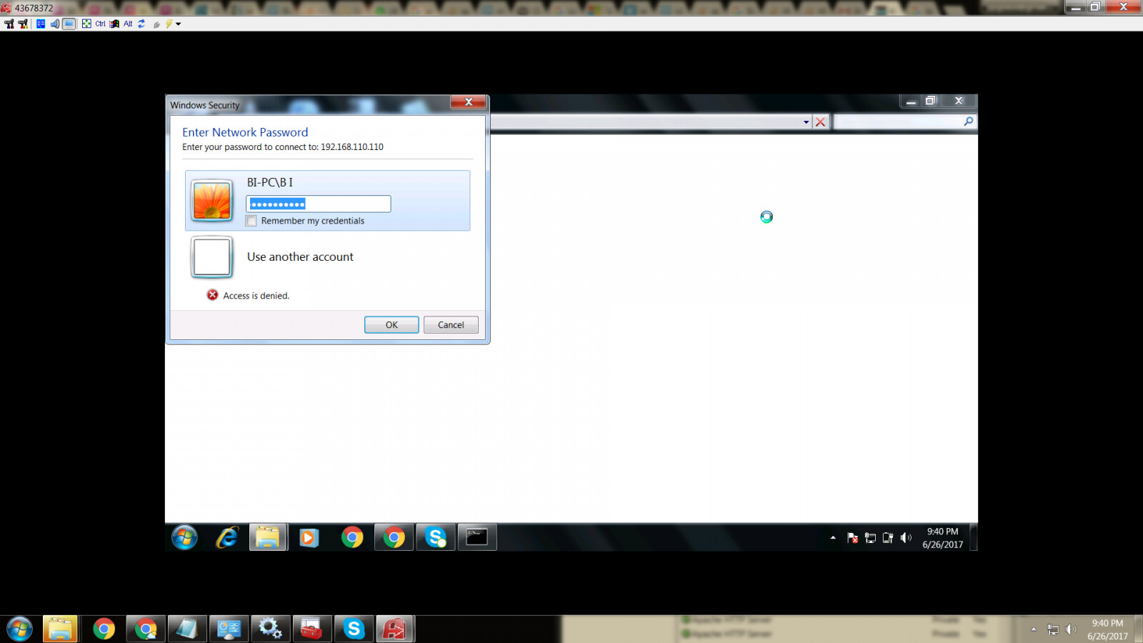

I am using WAMP server to run a local database CRM software. I want to access the database running on my PC from other machines in LAN. I am able to ping each other. I am able to access my shared folder from other PC. However when I try this \ipaddress\c$ , I am prompted for a username/ password window. Though I am entering it correctly, I am getting access is denied error. not sure what is the issue.

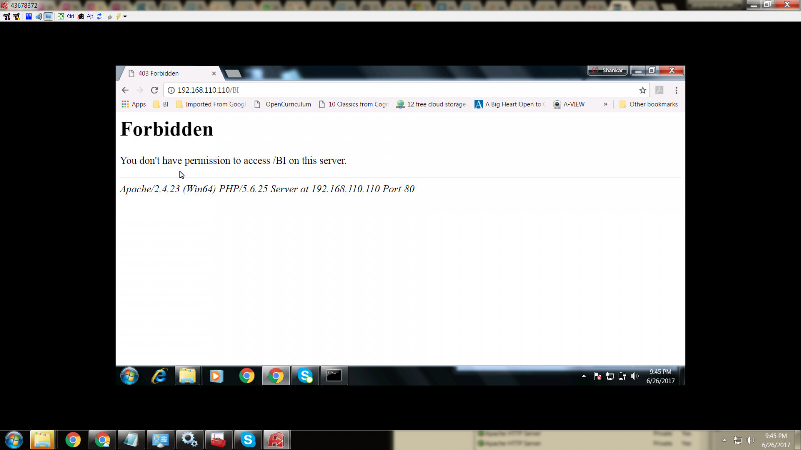

And also when I try to access the server from browser, getting no permission error like below. Any help would be appreciated

Have you tried
http://localhost/wpress
with
http://internal_ip_of_machine/wpress
Does your username have a space?
C://wamp/alias/phpmyadmin.conf > edit >
At the bottom
Allow from all
Allow from all
Edit and save.
Restart the process.

this is my phpmyadmin.conf file, and I couldnot find Webgrind.conf file at all
<Directory “c:/wamp64/apps/phpmyadmin4.6.4/”>
Options Indexes FollowSymLinks MultiViews
AllowOverride all
Require local
<ifDefine !APACHE24>
Order Deny,Allow
deny from all
Allow from localhost ::1 127.0.0.1
Allow from all
Allow from all
</ifDefine>
Post merged on Jun 27, 2017
Allow from all
Allow from all
I did the same with httpd.conf after that "http://internal_ip_of_machine/wpress " works from the same machine. but still fails from remote machines.
https://stackoverflow.com/questions/24005828/how-to-enable-local-network-users-to-access-my-wamp-sites
for WAMP 3.0 and above , need to edit the httpd-vhosts.conf as mentioned in the link. looks good as far as connecting from remote machines. will update with queries,if i have any issues with the application access
the current issue I am facing is, when I access from remote machine using my IP, I am able to access the login page, but when I move to next page, the url changes to localhost and obiviously the site is lost. what is the solution
@@rads @@techygeek
It is something to do with general settings in wordpress. fellow user from the software forum (civicrm) I use helped me . great, completed the task ! thanks everyone for your time and help
