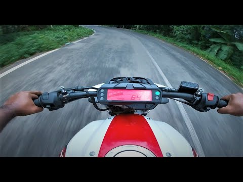

Any resources you can lead me towards to research about aftermarket speedometers?
this looks ass :skull: :sob:
