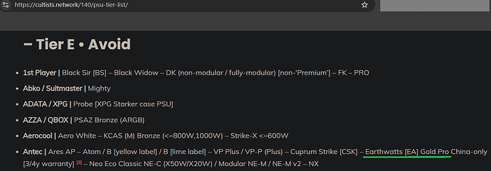

Gold, silver, bronze are power efficiency ratings & have nothing to do with psu overall quality. There have been bronze psu from corsair CX series in the past having overall much better quality than some silver/gold rated psu.

Again, a cheaper & lower tier component might have better efficiency but lesser reliability/life.
If someone is going to use psu tier list like above then mentioning gold. silver, bronze is pointless. If someone is not going to use a list like above then using just gold/silver/bronze might mislead them to buy a poor quality psu. In short, using gold/silver/bronze for psu quality is pointless.
You highlight one model from antec in tier E that happens to be gold rated to base your claim. You do realise they test these PSUs with great scrutiny right? There are outliers everywhere. The same PSU but non-china variant is classified as Tier A BTW so its china doing china thing. Note the warranty period difference, they know.
Look at it from this way, Pretty all models in tier A and tier B are either platinum rated or at least gold with respectable warranty period. Coincidence? I think not.
Also that PSU tier list is rather limited and there are many models which are not available in our market to purchase and many that are not available in their market so they haven’t tested them either. So if I can’t find a PSU thats on their tier A or B list then I will have to go by effiency rating and the general reviews anyway.
Again, I’m not trying to argue and say you are wrong. As long as you aren’t buying a discontinued model (like that one from gigabyte) or a “gold/platinum” rated PSU from chinese no name offbrands with 3 years of warranty you will be okay
