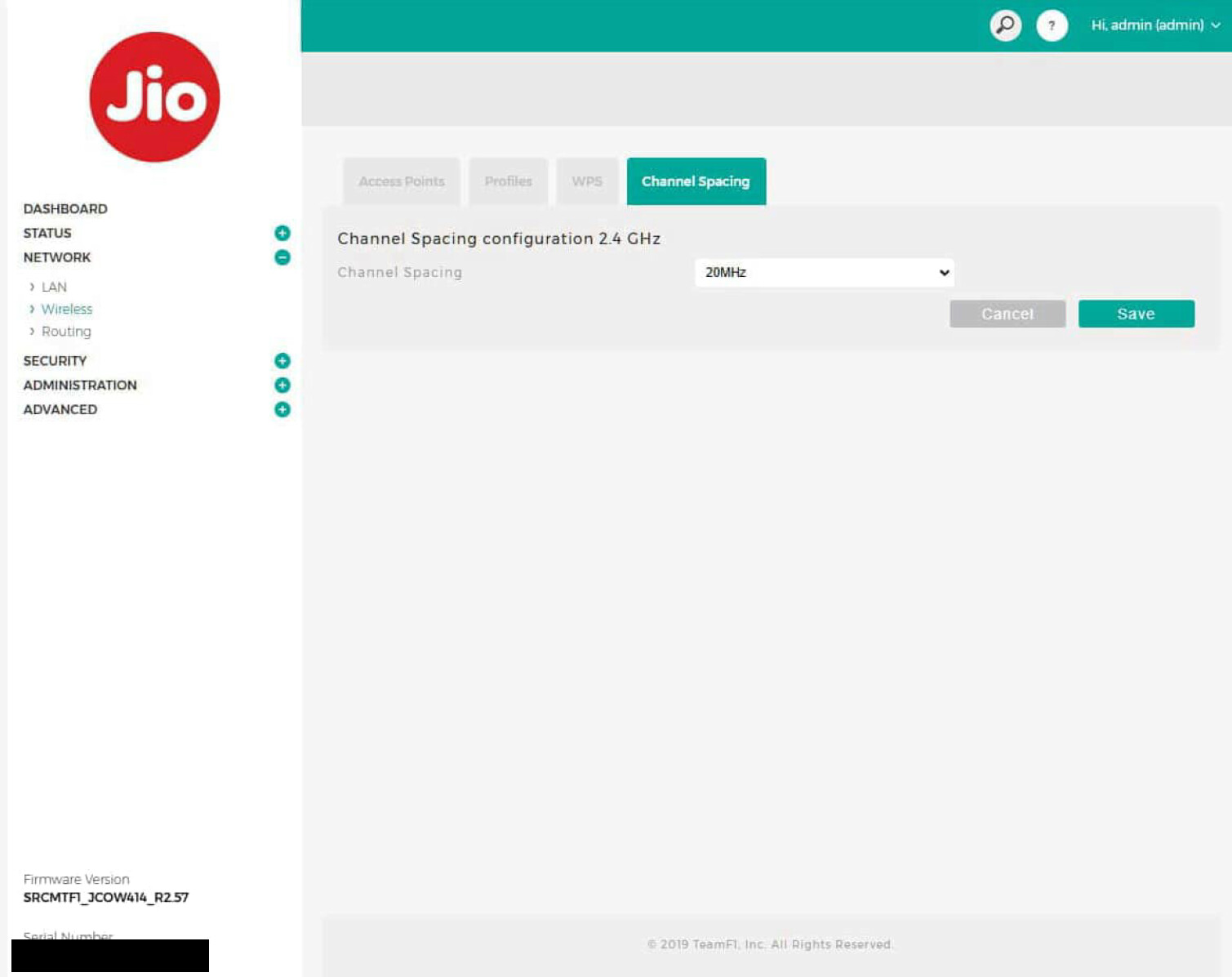

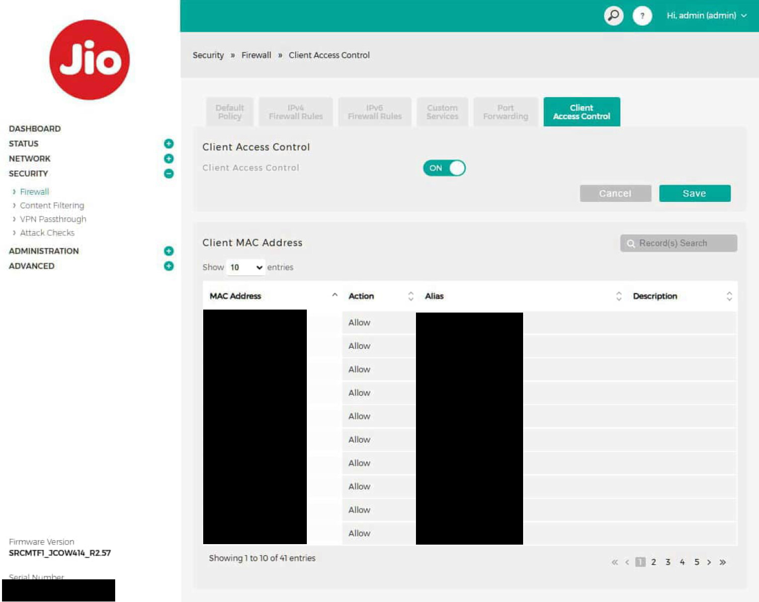

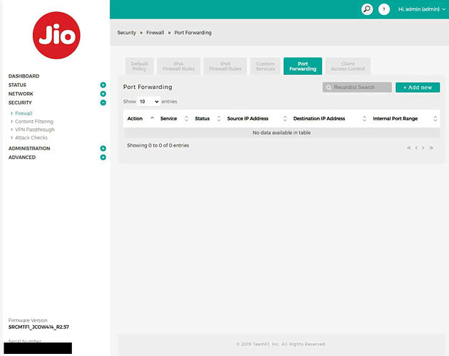

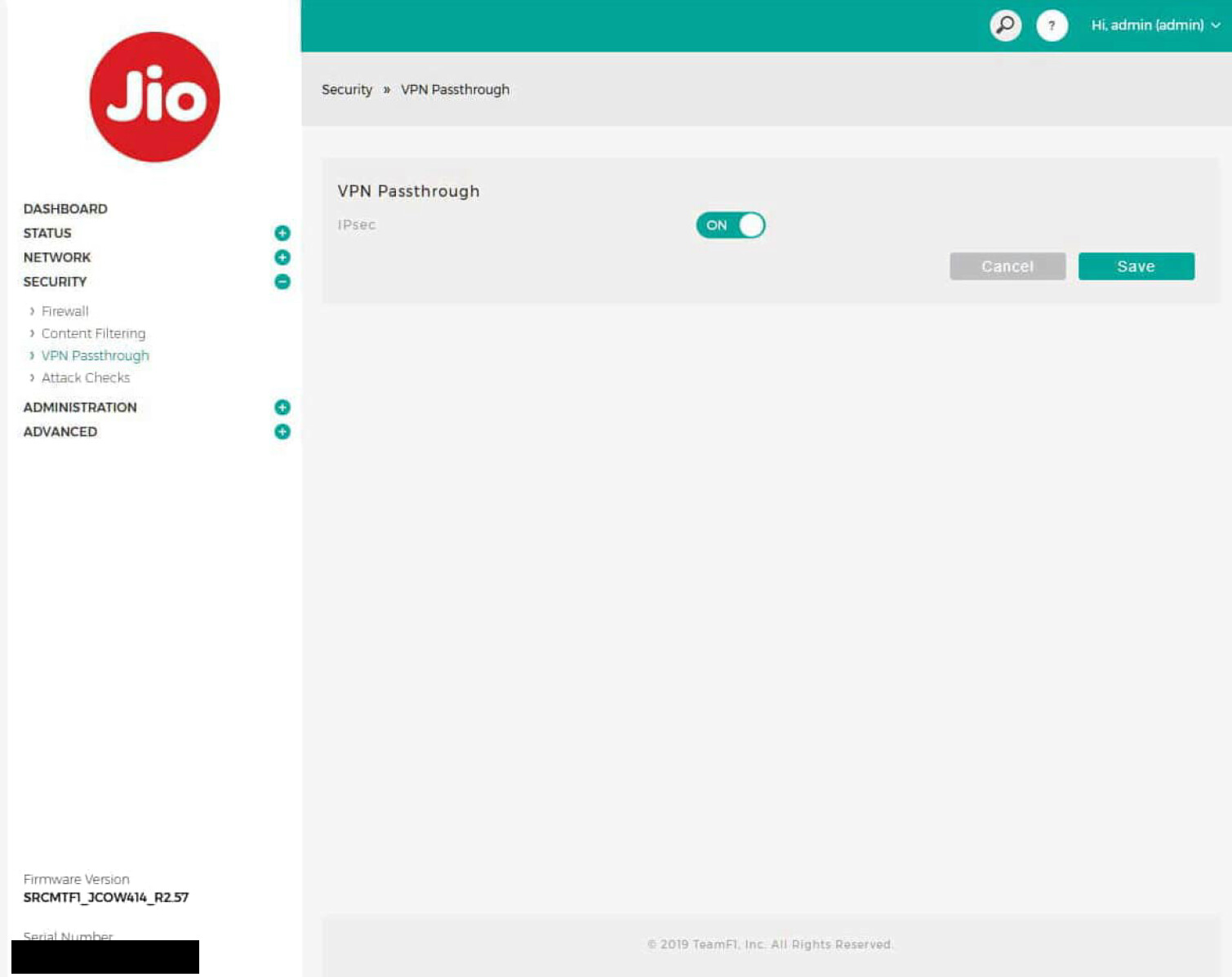

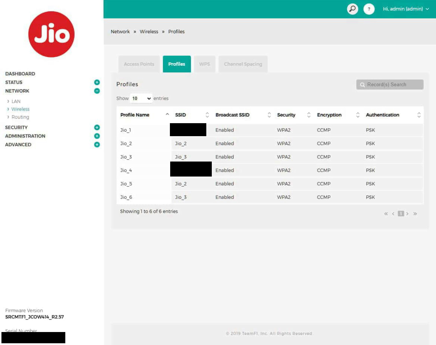

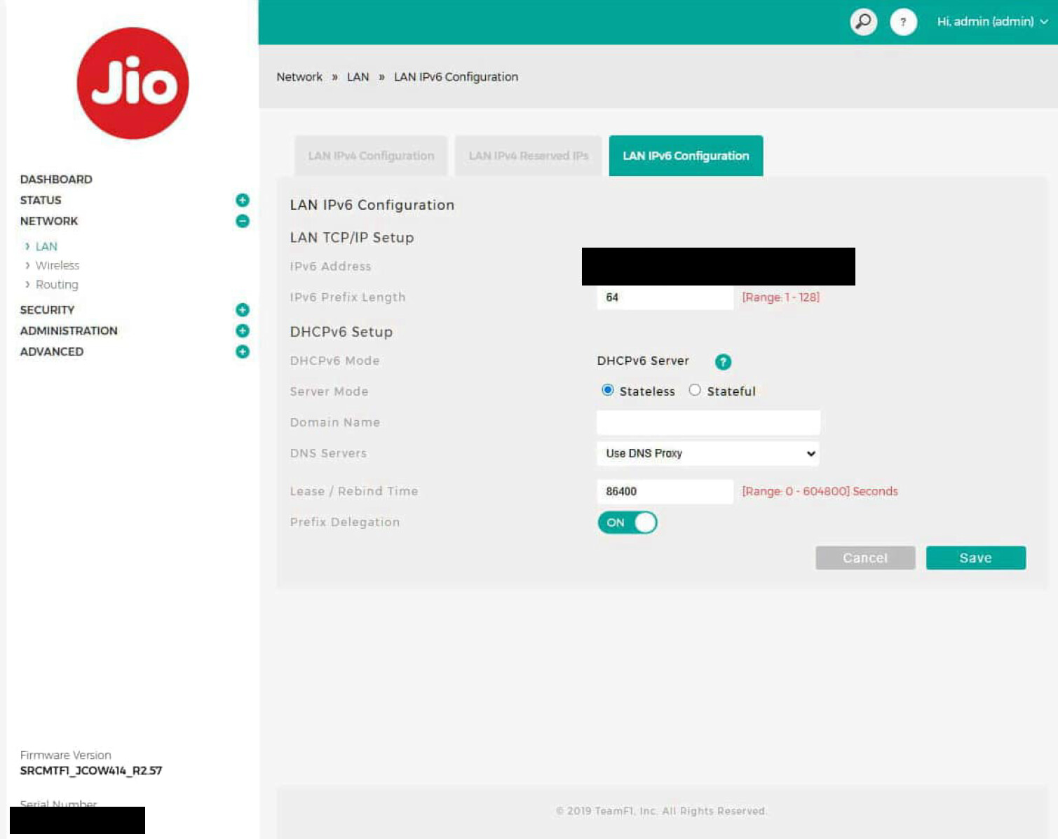

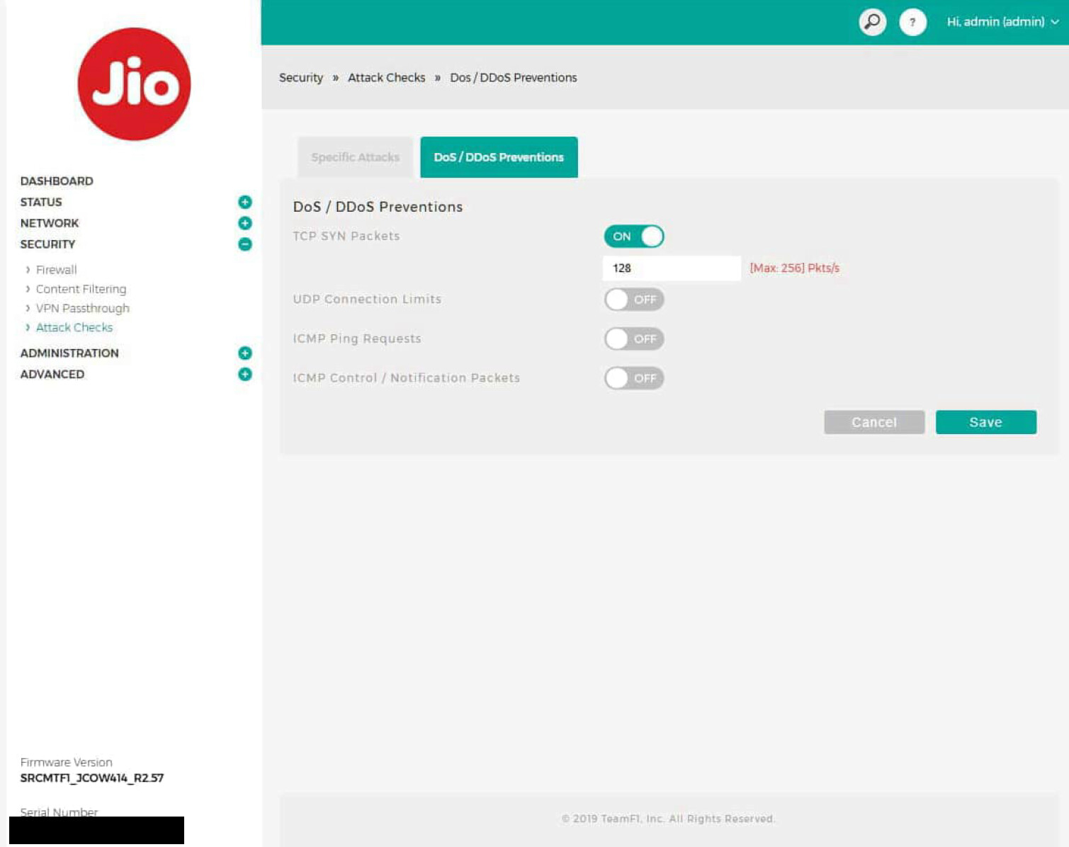

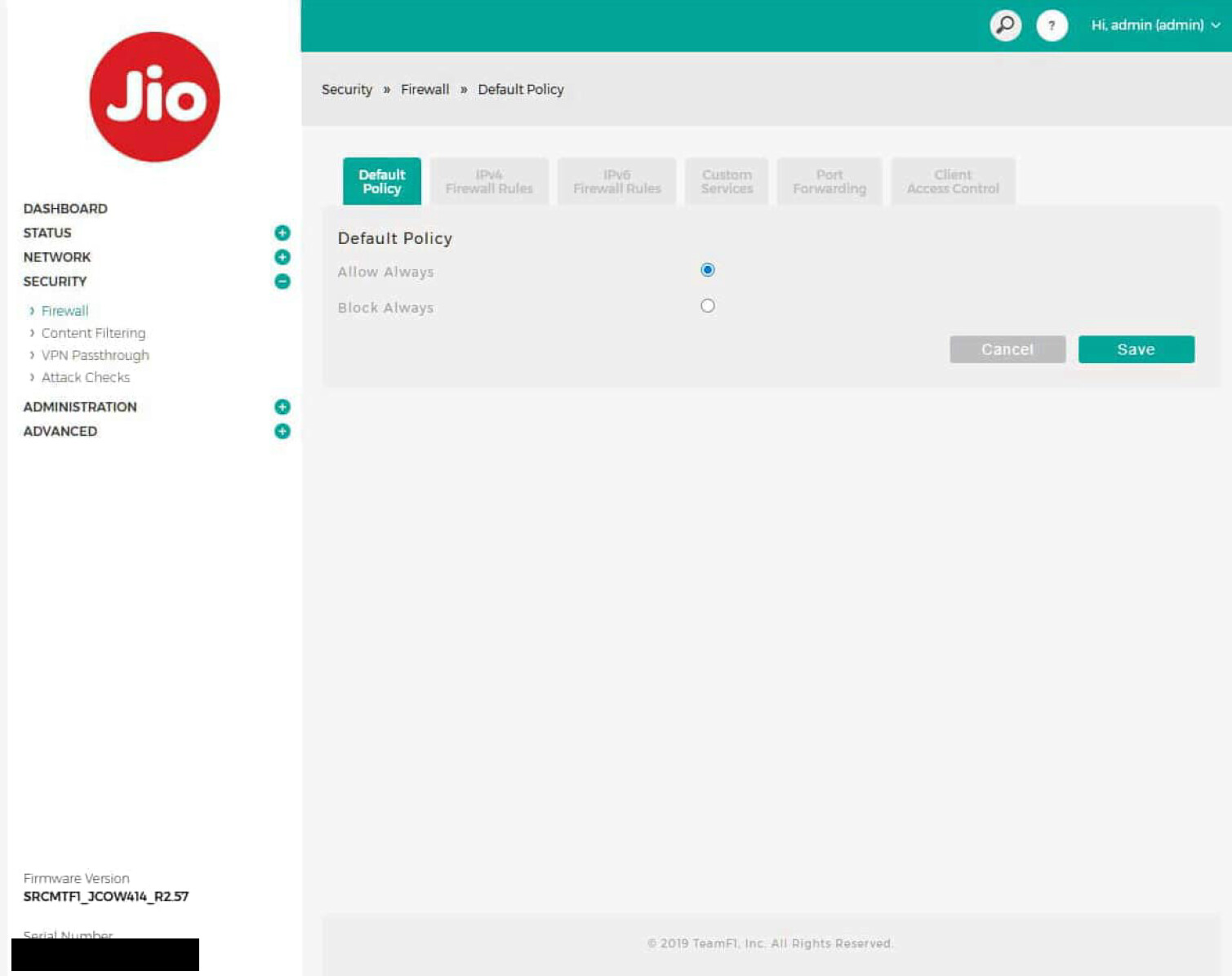

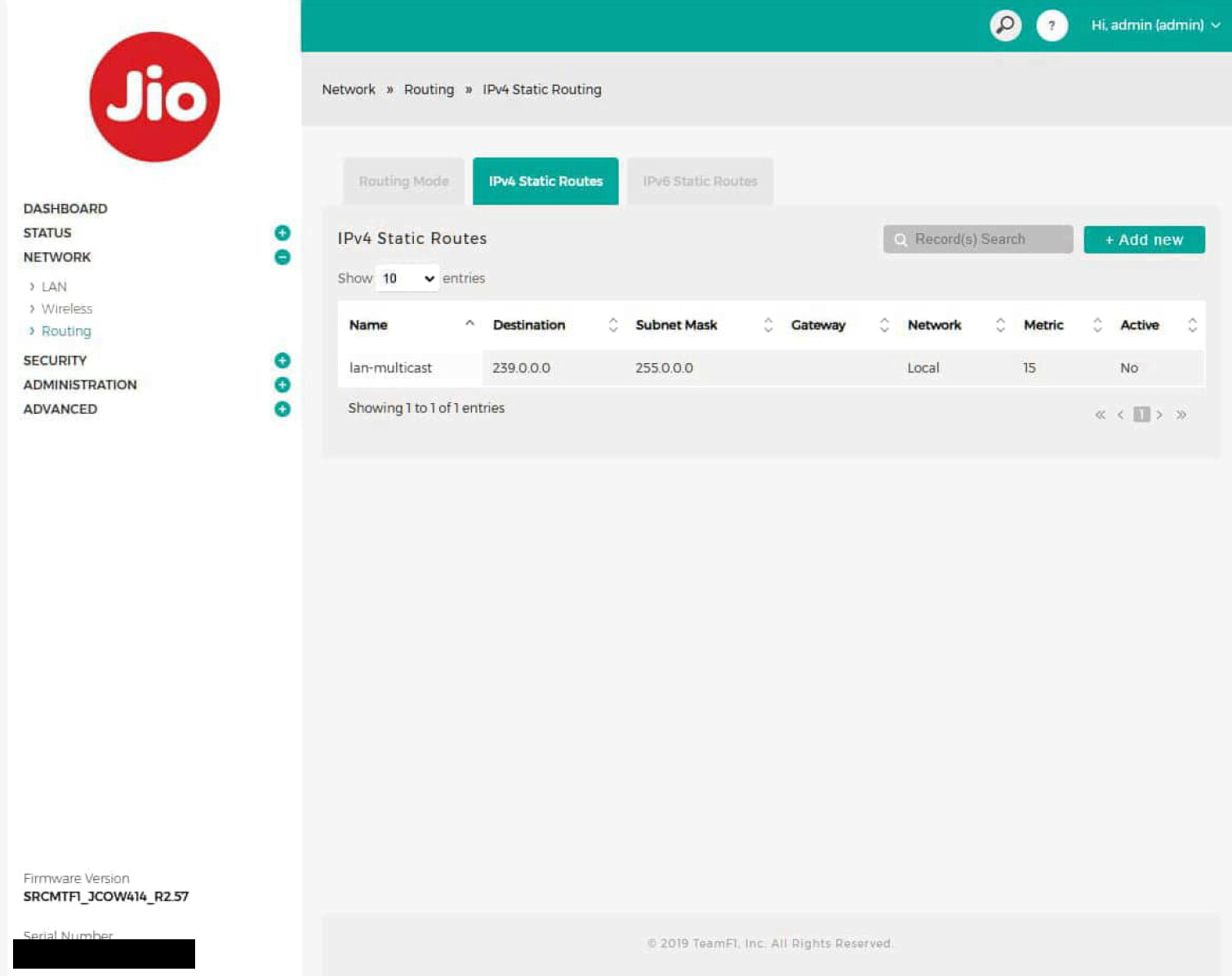

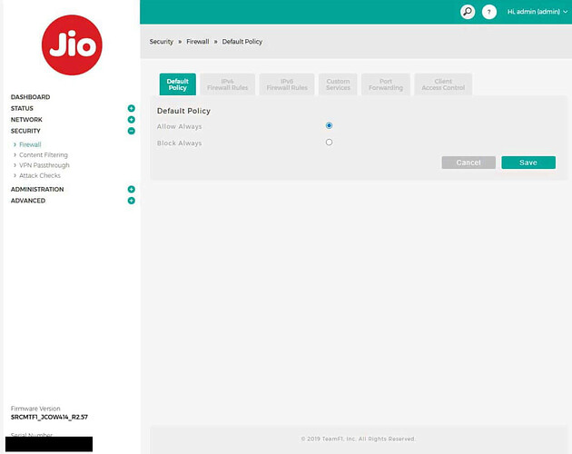

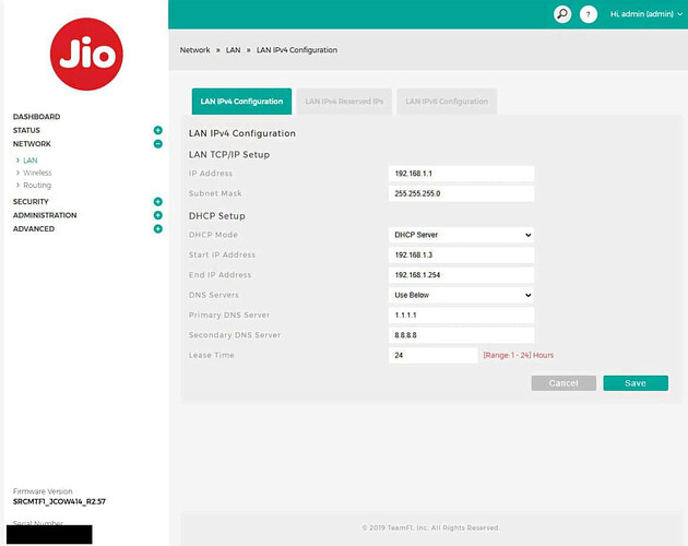

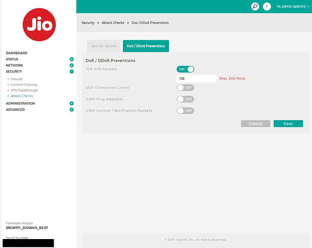

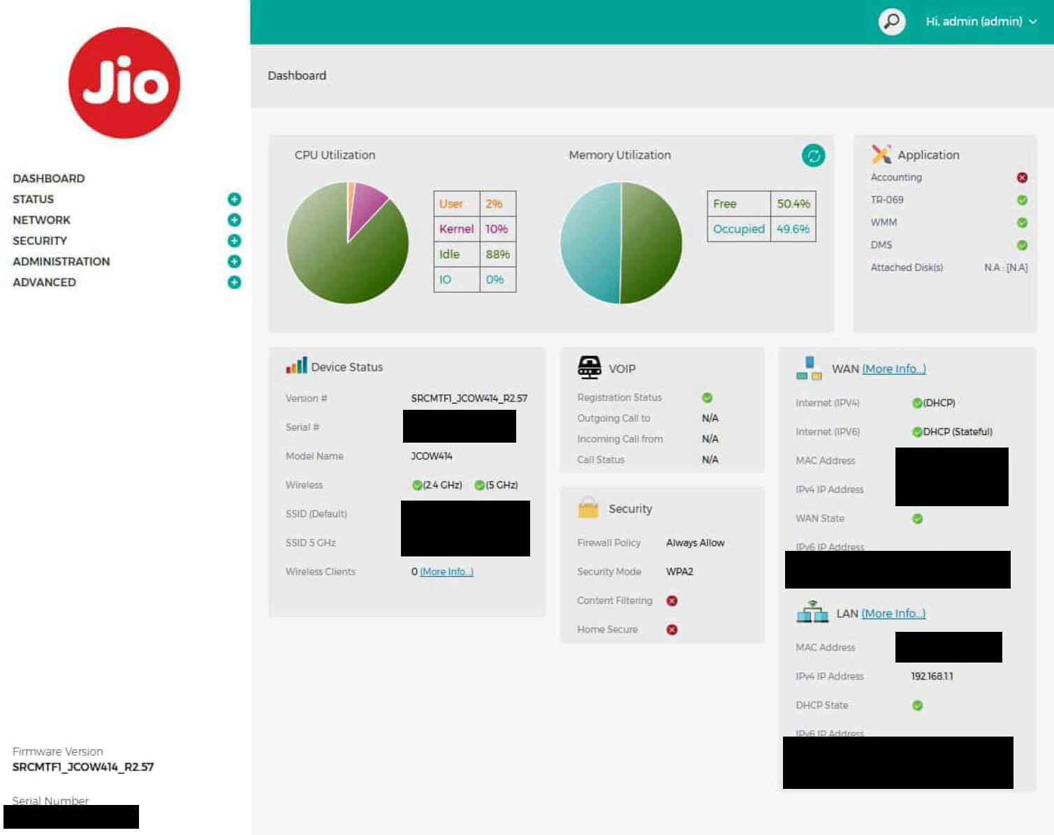

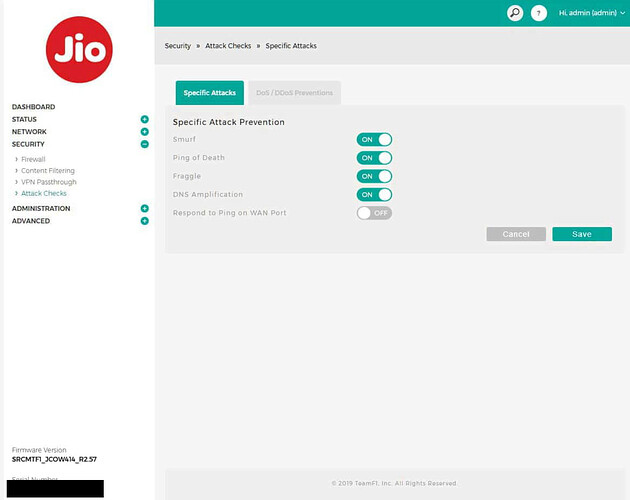

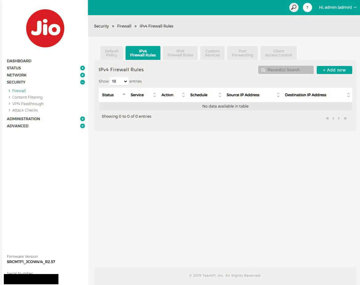

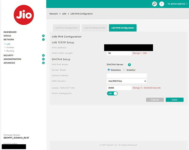

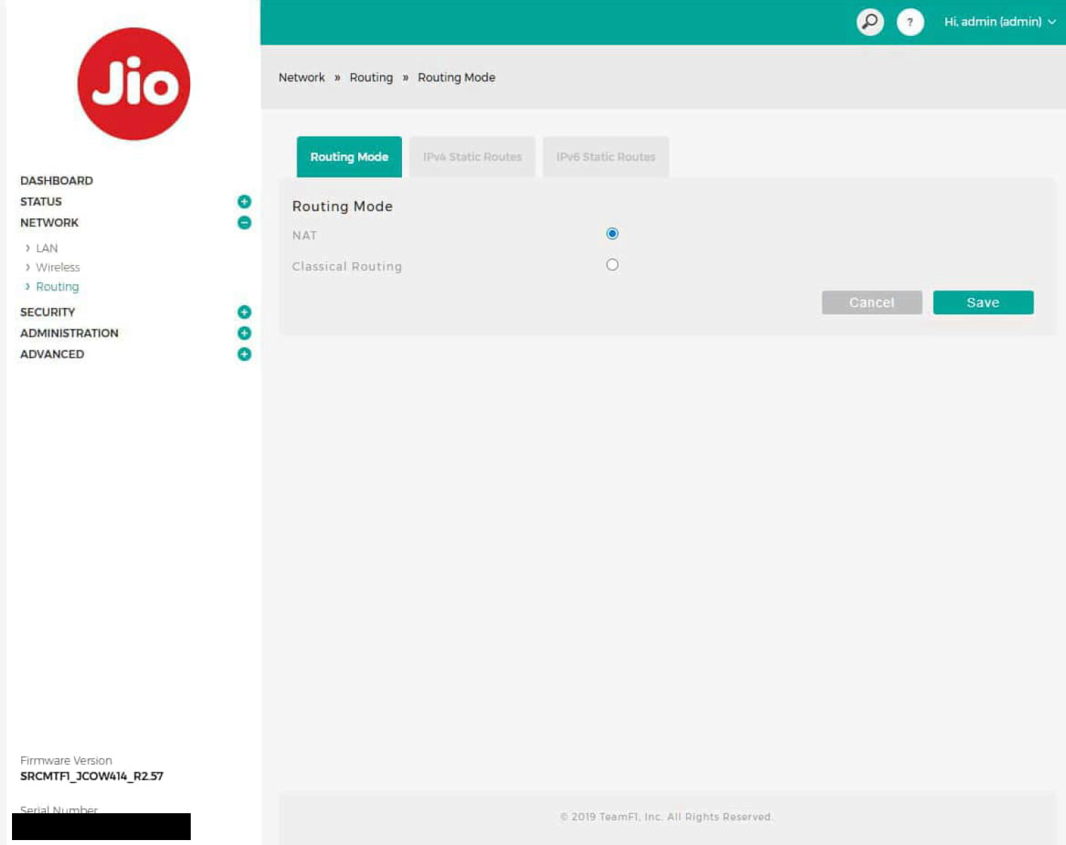

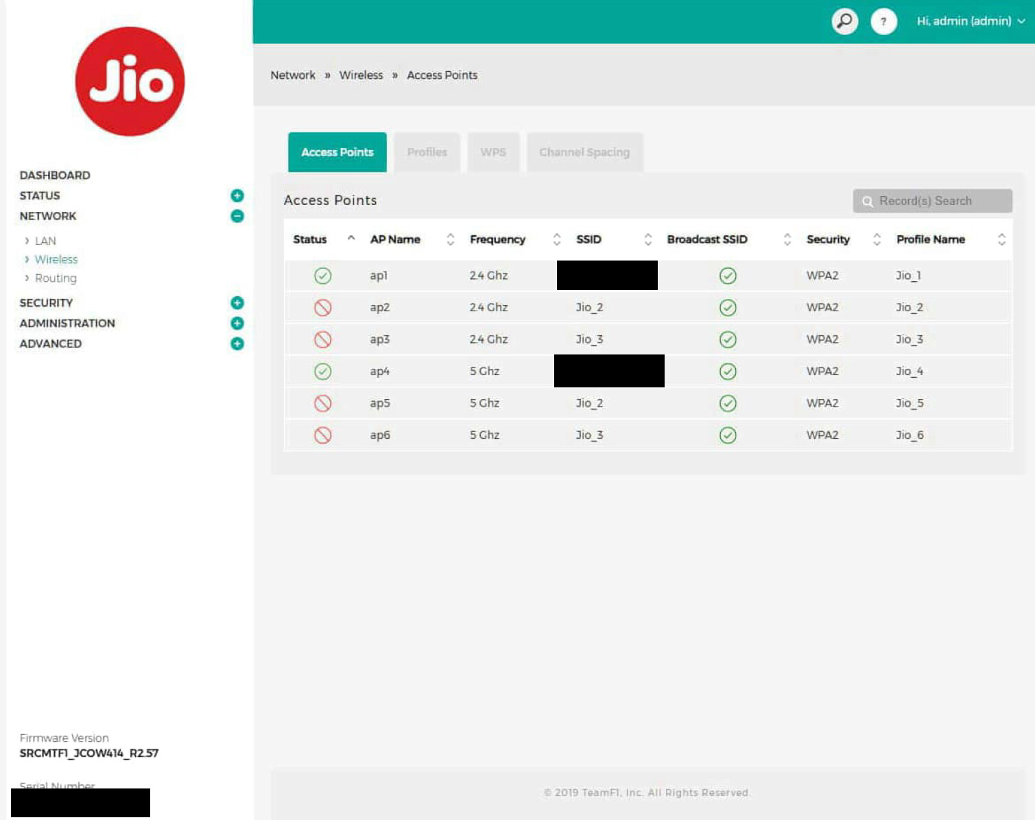

Here are some screenshots I took of my Jio Centrum console (model JCOW414) - there’s a lot of compression artifacts because of the cropping and redaction, but should still be readable. I didn’t include every single submenu, just whatever looked relevant or interesting. Also the LAN and DNS settings are mine, not factory default.
All the stuff @@dash2009 was looking for should be possible, and I can confirm they work: custom DNS, changing LAN address, and WiFi names. I see an option for bridge mode (wish I’d known about that when I was still using my mesh nodes), but I haven’t tested it.
Overall, I was pleasantly surprised when I found out how much control I have - it’s honestly more than my Linksys mesh setup gave me. I didn’t even bother checking it - since I assumed it would be locked down - until last year when my mesh nodes died and I had to switch to using this as an AP and router for the first time.
