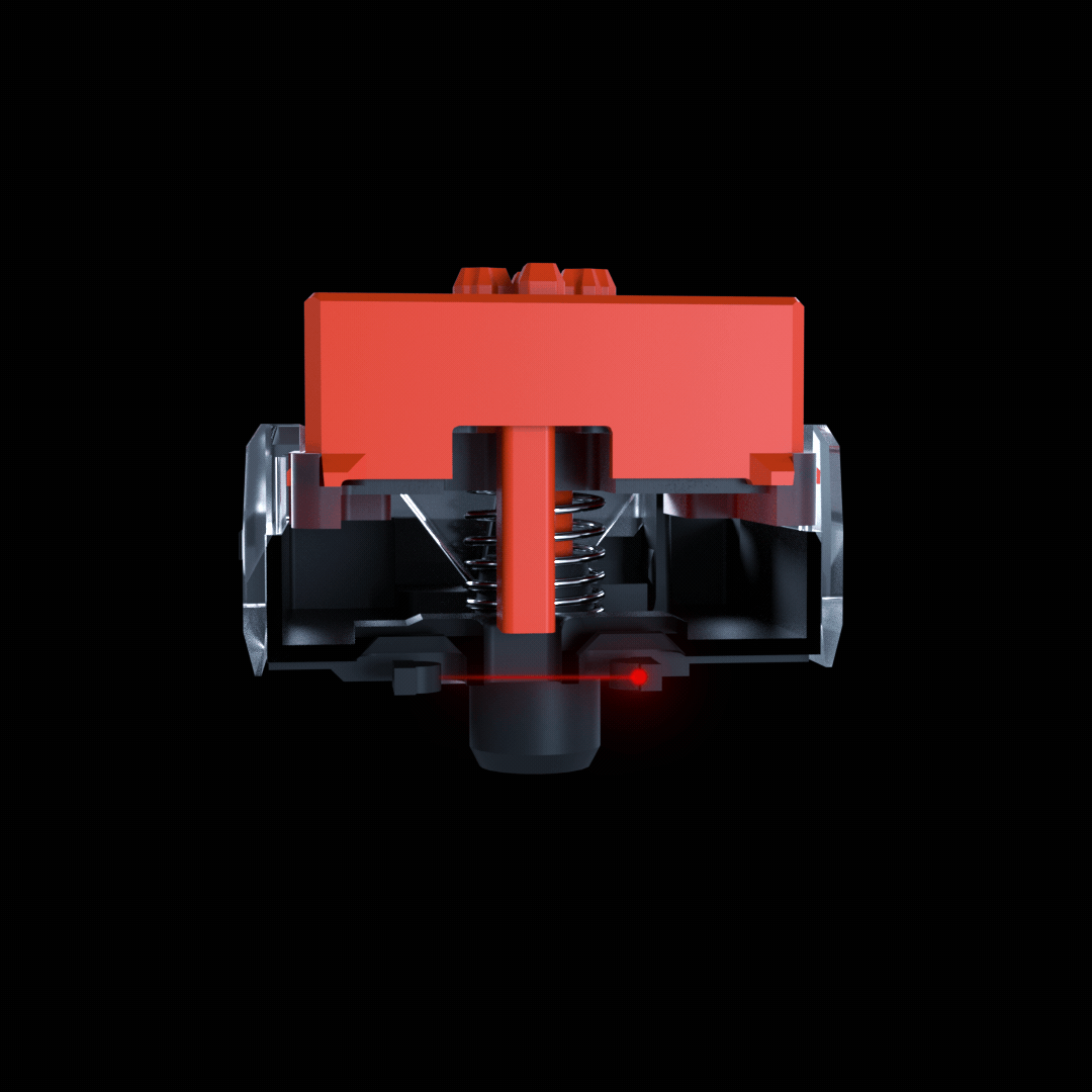

The optical sensor cannot have a double click issue but the mechanical spring does.
Mechanical spring? I don’t think fully optical switches have any such component. This might be applicable to those “hybrid optical-mechanical switch” which mouse like logitech G502 X use.
Not sure about the exact ones being used in each model, but this is an illustration from Razer’s website.
Double click issue is caused by the thin plate like structure in the mechanical switch which gets pressed to register the click. In case of optical switch the registering of click is done by a light beam/laser. The spring in those switches do not contribute to double clicking issue, maybe to the overall life itself like once it malfunction the switch itself will stop working but it won’t cause double click.
