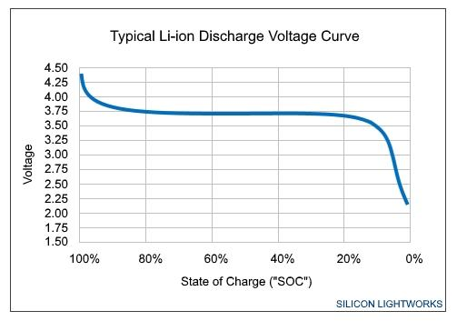

The funny thing is the battery itself has no way to tell you how much charge it has. It can only tell you >> one << parameter which is it’s voltage.
The typical lithium ion battery voltage graph look like this.
The battery voltage between 20-80% is near 3.75v.
The battery itself can’t even tell you how much mAH it is.
All the magic is done inside the fuel gauge IC that is in the BMS of the battery, it constantly monitors the total charge in and total discharge out and based on that it estimates the battery capacity.
All battery metrics that we see in phone and in apps are estimates. Very close to real in ideal conditions.
By ideal condition I mean long charges and discharges, the fuel gauge IC demands this once in a while to map the battery stats.
But here is the trouble, if we start apply our own optimizations of charging and discharging like doing 40-60 or 20-80, it throws off the fuel gauge IC little bit overtime. Cause it never finds out the full capacity of the battery.
So once in a while one full 0-100 charge and 100-0 discharge is recommended to keep the stats accurate.
