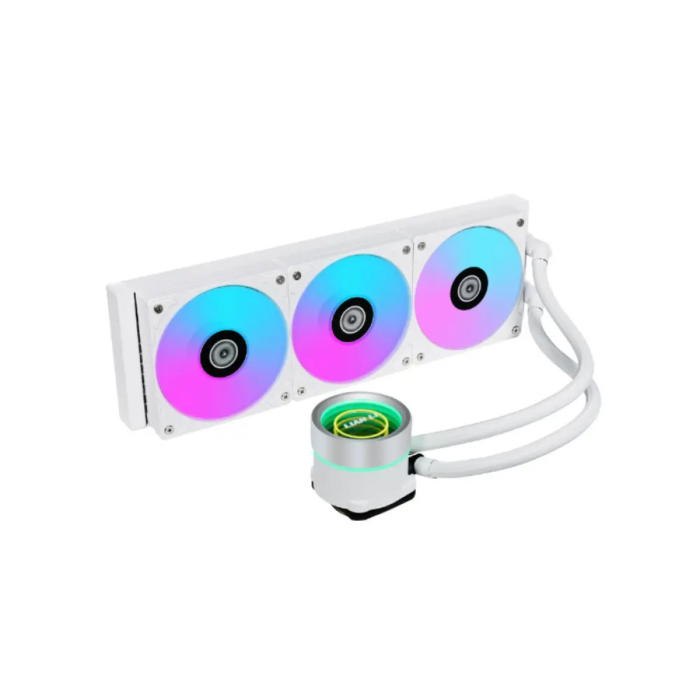

I have found and was quite impressed with Lian Li Galahad II 360 Trinity Performance considering its benchmarks, static pressure, etc. I ordered it twice from different websites but sadly its out of stock from every I could search.

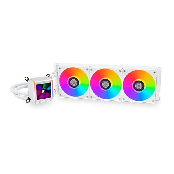

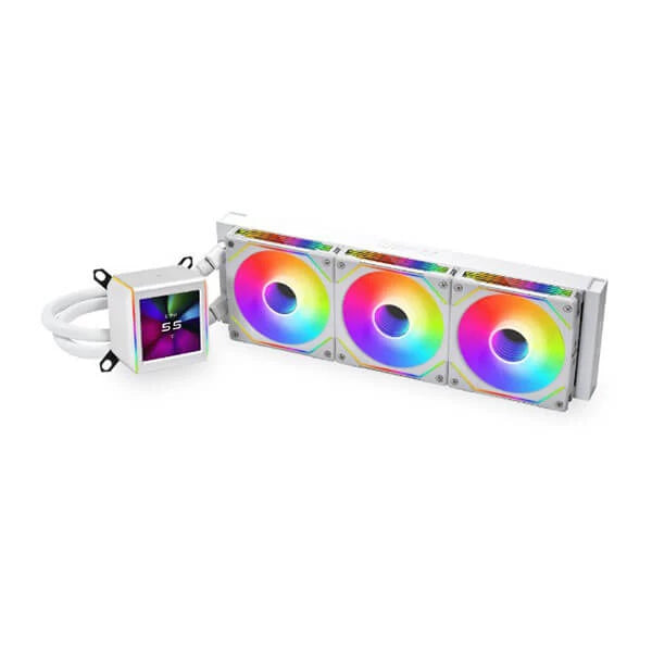

Also as to the Lian li AIO’s only the LCD version has the latest Asetek gen 8th pump.. all other models have different pumps.. they should be fine in performance aswell tbh.. but asetek has been imporving on there desgins for so long now.. if i was in your situation i would get the LCD variant and be satisfied that i have the best possible solution.. i dont think the price difference will be that big.. you can clearly afford it since you already have top of the line config.

Thanks. Too late now. I just ordered lian li galahad ii trinity performance. Should be coming in few days
