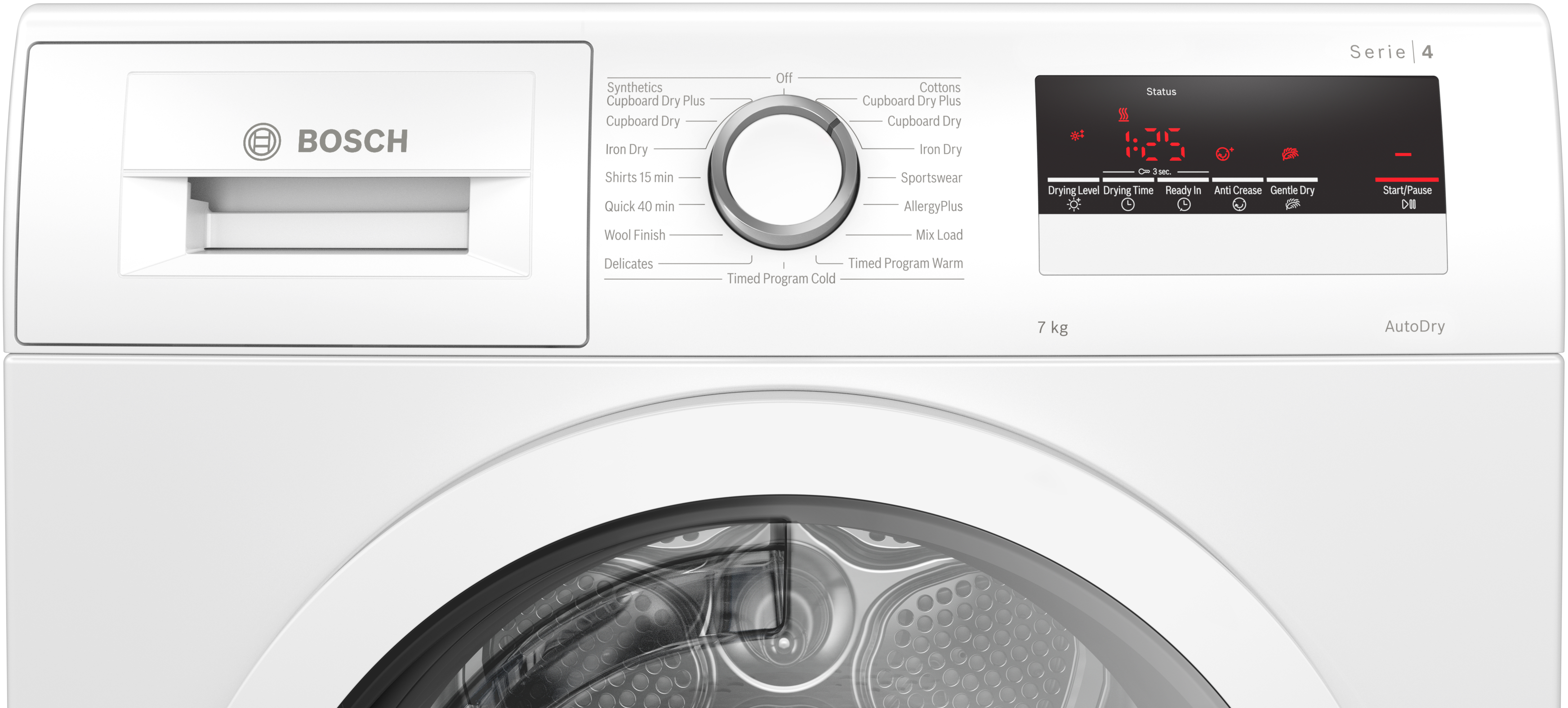

[Condenser type](’
Condenser tumble dryers | Bosch
That’s the cheapest they have. 7kg means a smaller load compared with larger sizes.
