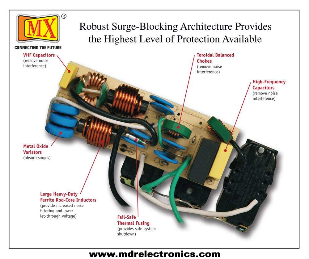

Here you go -
MX 6 SOCKET UNIVERSAL SPIKE SUPPRESSOR WITH INDIVIDUAL FUSE, SWITCH & CHILD SAFETY SHUTTER 6 Socket Surge Protector (Multicolor)
https://www.flipkart.com/mx-6-socket-universal-spike-suppressor-individual-fuse-switch-child-safety-shutter-surge-protector/p/itme7kz7gak9mfj7
https://www.amazon.in/UNIVERSAL-SUPPRESSOR-INDIVIDUAL-SWITCH-SHUTTER/dp/B00H7YVUVA/ref=sr_1_4
^the flipkart listing neglected to include an extra graphic which the amazon link had. This is critical.
See where it says metal oxide varistors. That is what absorbs the surge. Question i asked earlier is how do you test its integrity. Because once it goes you have no protection left and you have no idea when that happens. I’m not sure if the entire unit stops working when that happens or not. A good design would have those varistors replaceable instead of soldered in

View that MX device. It says MOVs absorb surges. Does it provide a number? Of course not. Only honest recommendations include numbers. But they cannot lie in specification numbers. So how many joules does it ‘absorb’? Hundreds? Probably a thousand. Surges that tiny are routinely converted by electronics into rock stable DC voltages to safely power semiconductors. Better protection is already inside appliances.
Effective protectors (only recommended by the few who actually know this stuff) harmlessly dissipate hundreds of thousands of joules. rdst_1 described what is found in every facility that cannot have damage. gspaul80 accurately demonstrated what plug-in protectors really do.
Again that MX device. Notice a thermal fuse. That would be missing on homemade (dangerous) protectors. Since it has such tiny joules, then its thermal fuse must trip as fast as possible to disconnect those MOVs absorbing too many joules. And leaves that surge still connected to appliances. No problem. A surge that destroys protector parts is also made irrelevant by superior protection inside appliances.
Sometimes that thermal fuse does not trip fast enough. Just another problem with tiny joule protectors that are not connected low impedance (ie less than 3 meters) to earth ground: https://i.redd.it/e34962ah06q11.jpg
