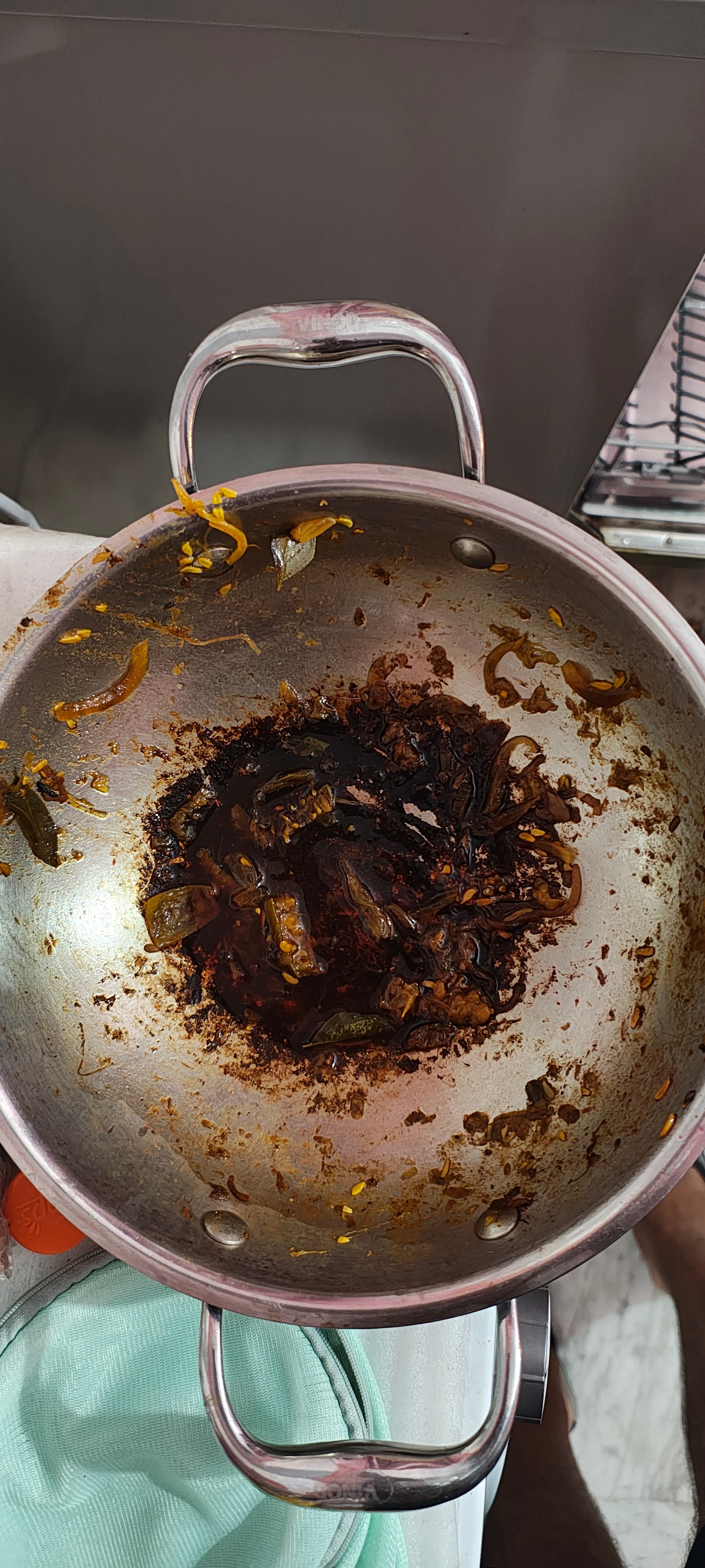

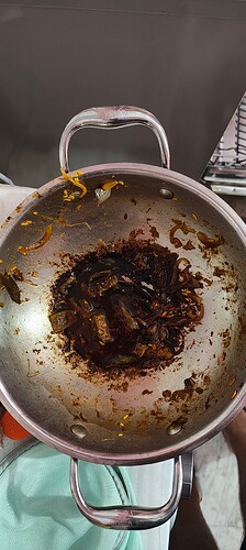

I’ve always had to rinse hardened residue, like those from a kadhai or tea pan after lots of boiling. They’ve never gone away even using the “Intensive Kadhai” mode. So I pre-rinse and lightly scrub them off before loading, and the dishwasher works just fine in a single load after that.
I’d like to find out just how much harderned residue is too much for a dish washer because half our utensils are like this.
It would be hard to quantify that, but I’d say I do it with 1-2 of our utensils at most (typical north indian cooking), and that too once in a while. I don’t need to do that for 95% of utensils. By hardened residue, I mean when things get burnt and form a hard black layer at the bottom of a kadhai or other utensils, or when you boil tea or milk a lot and it forms a brown/black layer that’s caked on. So stuff that would take some effort, even with a scrubber.

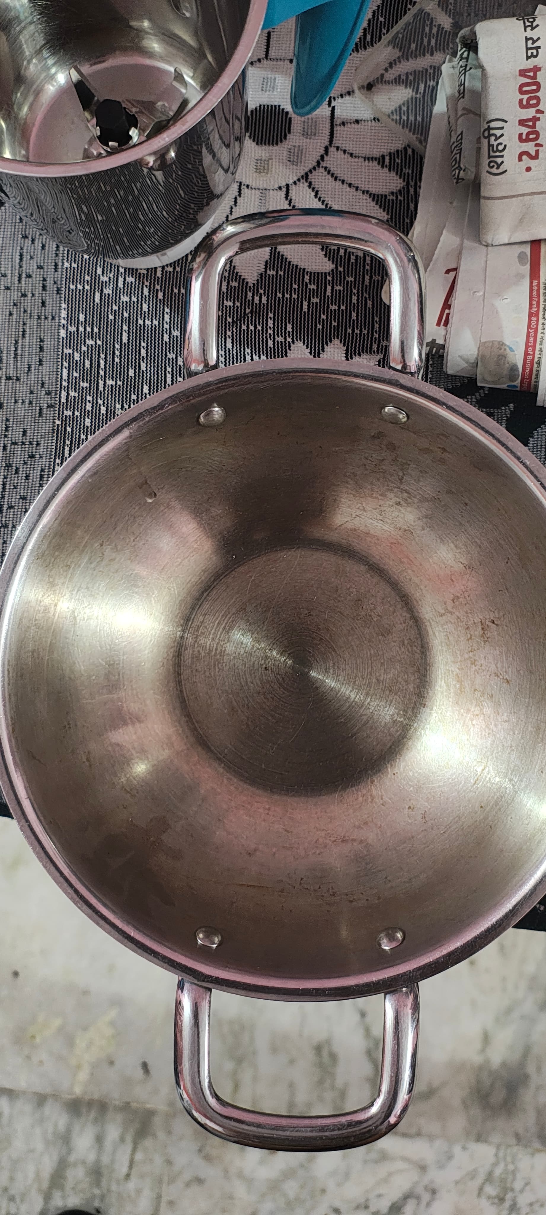

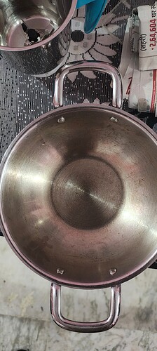

I can show you a before and after picture the next time

Here you go.
