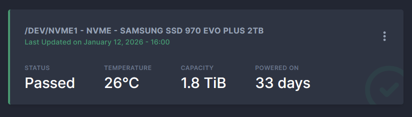

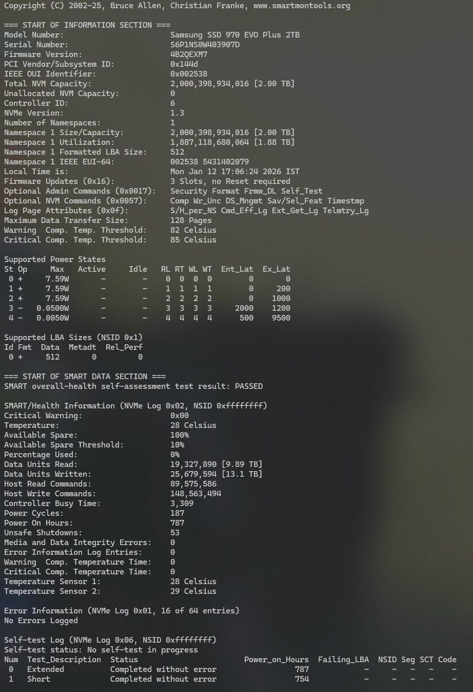

Latest report from scrutiny (Last Updated on January 12, 2026 - 08:00)

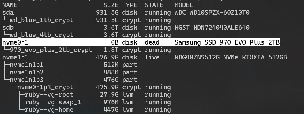

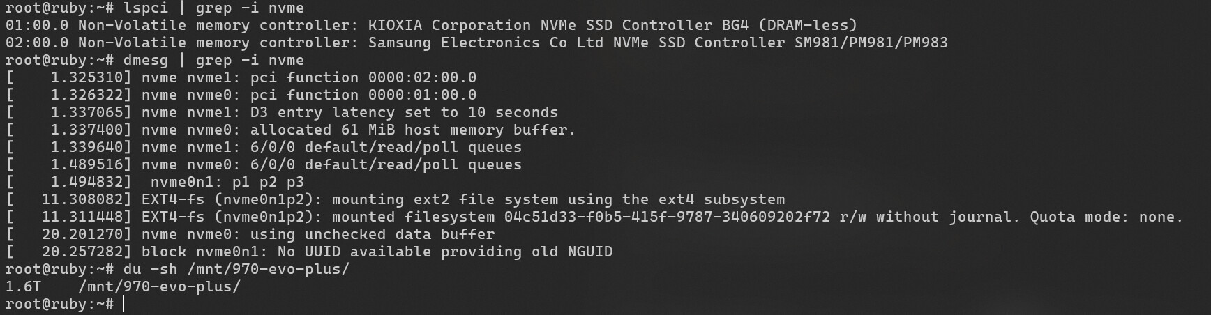

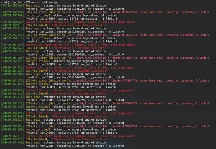

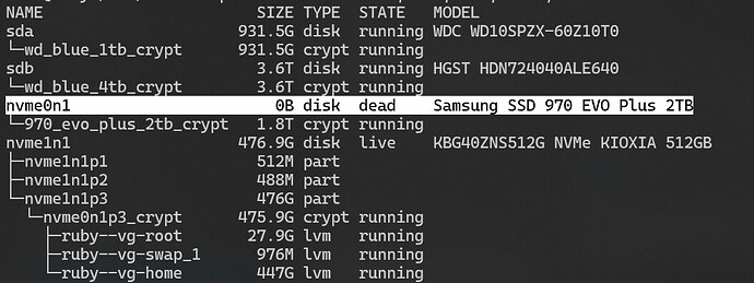

The NVME controller has failed. You can see the kernel sees the NVMe namespace as 0B and marks it dead.
Which is why in the second pic you’re getting fuse.read: attempt to access beyond end of device errors.

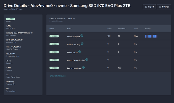

The Scrutiny report in last pic says “PASSED” because your SSD’s NAND chips are fine - 0 bad sectors and 100% spare area.

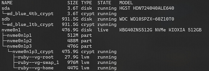

After rebooting, the drive was not visible under lsblk, and there were errors in dmesg.
As a last attempt, removed the SSD, cleaned its contact pins, and reinserted it, and it worked.
At the moment, I don’t see any errors in dmesg. I will back up all data to an external HDD in some time.

I ran long S.M.A.R.T test and it passed. And there are no errors in dmesg

One thing I noticed is that the power-on hours for this SSD increases very slowly. For ref, when I got this SSD, it had 17 days of power-on hours, and now, after more than six months of use, it has increased only to 33 days. My mini pc is running 24/7 except when there is a power cut.
