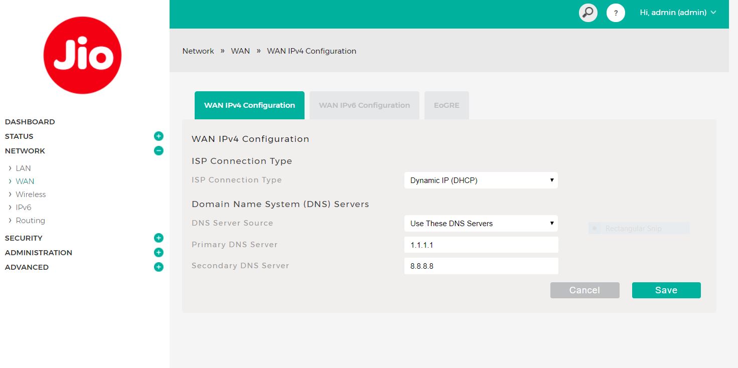

Maybe a proper vlan id is required.
Can you show the Wan settings page too. I was wondering if a vlan is required and what is the protocol for connection.
Ah, it is a plain dhcp connection. Most likely they are registering the mac address of the router at their end.
My suggestion would be to clone the mac address of the primary router to the secondary router. That way once the bridge is setup the ISP end will still see the traffic from the mac address registered with them.

You may need a VLAN ID. Here for MTNL, I have a VLAN ID set up in the modem while putting it in bridge mode and my Asus router dials a PPPOe connection. But considering the fact that Jio uses CGNAT (Carrier Grade NAT) where everyone shares the same WAN IP, it is pointless to have Bridge mode setup as you will not be able to port forward correctly. There is no solution to this really apart from taking your own private static IP. This was the scenario back in September. However after commercial launch og JioFiber, has this scenario changed is yet to be seen. Too little info and we have to rely on everyone’s trial and error posts.

In bridge settings Jio ONT has a VLAN ID. To enable bridge mode and have internet, you need a router that supports VLAN tagging for WAN port. I know Firewalla Gold has this feature, but not sure about any consumer router having this. Prosumer routers would have this facility.

As per the above screenshot, the VLAN tag needs to be set to 0 in the other router (TPLink, Asus/Netgear). In Netgear, go to advanced settings, VLAN / Bridge Settings to set up WAN Vlan tagging.

you can get vlan Id from Ont and set ont to bridge mode as per the screenshots in this link.
once the ont is in bridge mode. Connect your router to the lan port you configured bridge mode for.
in router wan ipv4 set dynamic ip / dhcp as way to obtain isp ipaddress. Also clone ont wan MAC address to router.
you should see a ipv4 address and dns received from Jio on the router wan status.
that is where the good news ended for me. Have not been able to get an internet connection via the router. Seems like Jio backend checks for something more.
