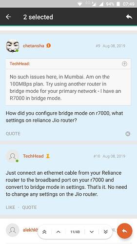

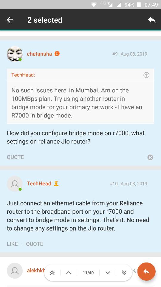

https://techenclave.com/community/threads/reliance-jio-fibre-dth-1-month-later-what-to-bargain-mumbai-2500-inr-deposit-first-free-for-3-months.190009/post-2183193
Post from other thread - reg bridge mode
Bridge mode doesn’t work. Net just stops working after selecting it. A simple LAN connection to other router works though (not from WAN port, but through LAN port).
That post is talking about changing the netgear ROUTER to bridge mode not the Jio fiber modem :slight_smile:
