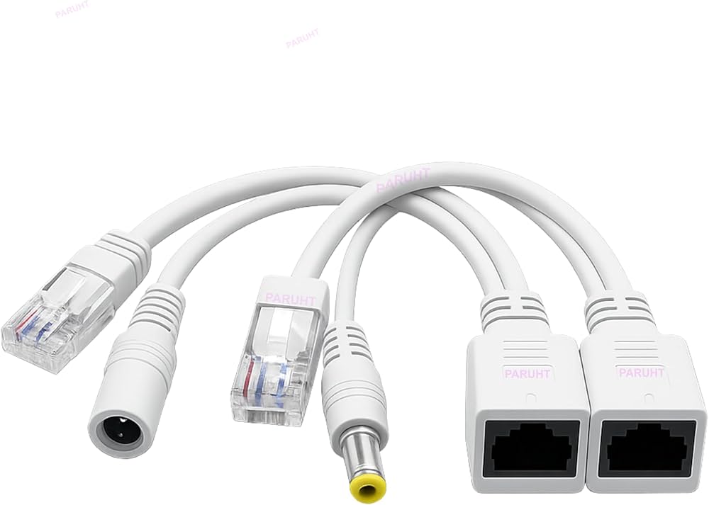

Can these type of passive POE injectors and splitters used to power VIGI cameras(they support 12v input along with POE) . I dont want to purchase POE switch for just one camera.
Those are passive injectors/splitters and are typically limited to 10mbit or 100mbit.
Some VIGI cameras will work with passive poe, you’ll need to look at the specifications for your particular model.

They support 12v input, So even if it wouldn’t work with POE at rj45, it must work at 12v port?

Can I buy 10/100 Switch or just use this splitter method
Yes, you can buy a 10/100 POE switch, if you don’t want to connect an access point to it in the future. It will work fine for your CCTV needs as they expand. I would recommend buying at least an 8-port switch as they are a little more costly than 4 port switches, but have double the ports.
This will work, it’s what I used with one of my TAPO cameras. You’ll be limited to 50m or so.
Then I bought a 4 port POE switch.
