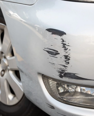

We all know and have experienced such scratches on our car esp. bumpers at sometime or other or even frequently. Mostly, thanks to bumper-bumper city traffic and premium add-ons of bikers rushing in between those tiny gaps.
We know how much it hurts as it looks too much ugly esp. on white or light colors.
While a paint job is the most viable option, it does comes at a price and who even wants to get the entire bumper painted for just a scratch.

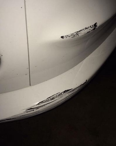

So, I thought about opening this thread to discuss and share on techniques people use or know esp. some proven tried and tested methods to fix such scratches at home with minimum efforts and tools. Esp. getting rid of these black marks or covering the black paint with the original color etc.
I have a white car, and it pains me to see those annoying little micro scratches caused (mostly) by bikers. Helpful tips would be appreciated.

No matter what you do you can’t restore the condition unless it goes back in for a paint job. This just won’t look as bad and won’t be immediately eye catching.
These scratches are huge, nothing can be done at home. If they were in small dot form, then you could do touch up with a very fine tip brush.
You have to go the denting-painting guys, they will fix it up. Avoid the service centers for these kinds of issues.
These are deep scratches. 1 layer of clear-coat and 2~3 layers of actual paint are gone. As long as it’s not metallic or some exotic paint, you can do a fairly good repair job at home.
  1. Wash affected area with detergent to degrease it and cover the unaffected area.
  2. Sand down with 180 grit sandpaper. Clean the area with IPA. Sand again with 320 grit sandpaper and wipe down with IPA.
  3. Spray a coat of primer*. If using brush, then wet sand with around 1000 grit sandpaper after the primer has dried.
  4. Apply first coat of paint and after it has dried, check for any undulations. If required, smooth it out with around 1000 grit sandpaper**.
  5. Apply 2~3 coats of paint with proper drying time in-between.
Smooth out hard edges by uncovering the surrounding area a bit and feathering in the new paint. Use sandpaper. As the surrounding area still has the clear coat intact, you need to sand it lightly to allow new paint to smoothly merge into it. You can judge this step by look and feel.
  1. Remove cover from the unaffected area and apply a clear coat on the newly painted area. Wet sand with around 3000 grit or above sandpaper to merge clear coat with old paint.
  2. If you can splurge, apply compound and polish at this point to help remove any haze.
  3. Wax the car after a few days of observing how the new paint is curing.
*Get appropriate primer to use on plastic and metal.**Thin coats and proper sanding help in reducing the orange-peel effect.
