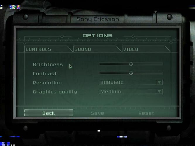

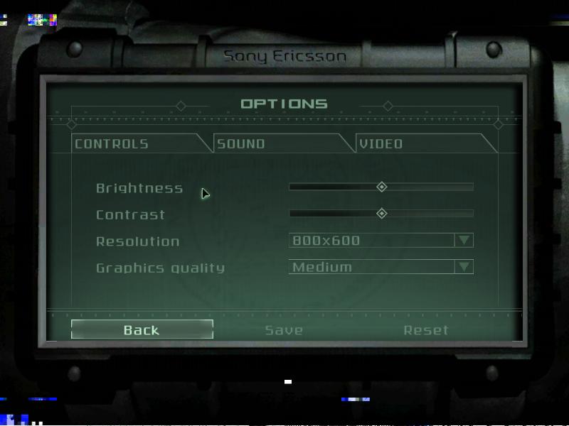

1)It sometimes displays artifacts or something that should not be in games.But this afternoon for sometime it i think was not showing artifacts etc for sometime,not the whole time.

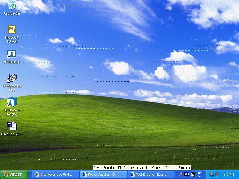

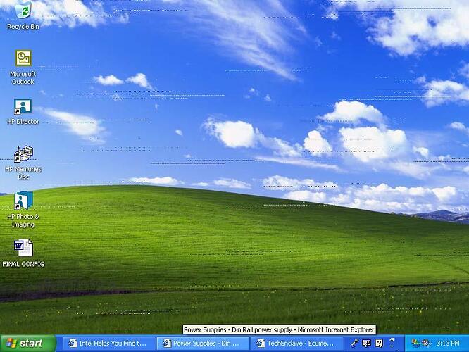

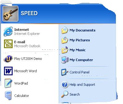

2)The text appears distorted or cut sometimes and often when another thing is dragged over it , if even it is highlighted by the mouse the distortion goes.
3)Sometimes the monitor becomes pinkish and sometimes flickers pink like i think so probably.
Once when comp was starting , the bios text was pink and something otherwise written in yellow maybe ,‘energy’ or something i think appeared orange like.
4)Sometimes the screen has dots of different colous and sometimes they go by opening a window if they are in the taskbar for example but if they are in the desktop screen like wallpaper they may not go.
