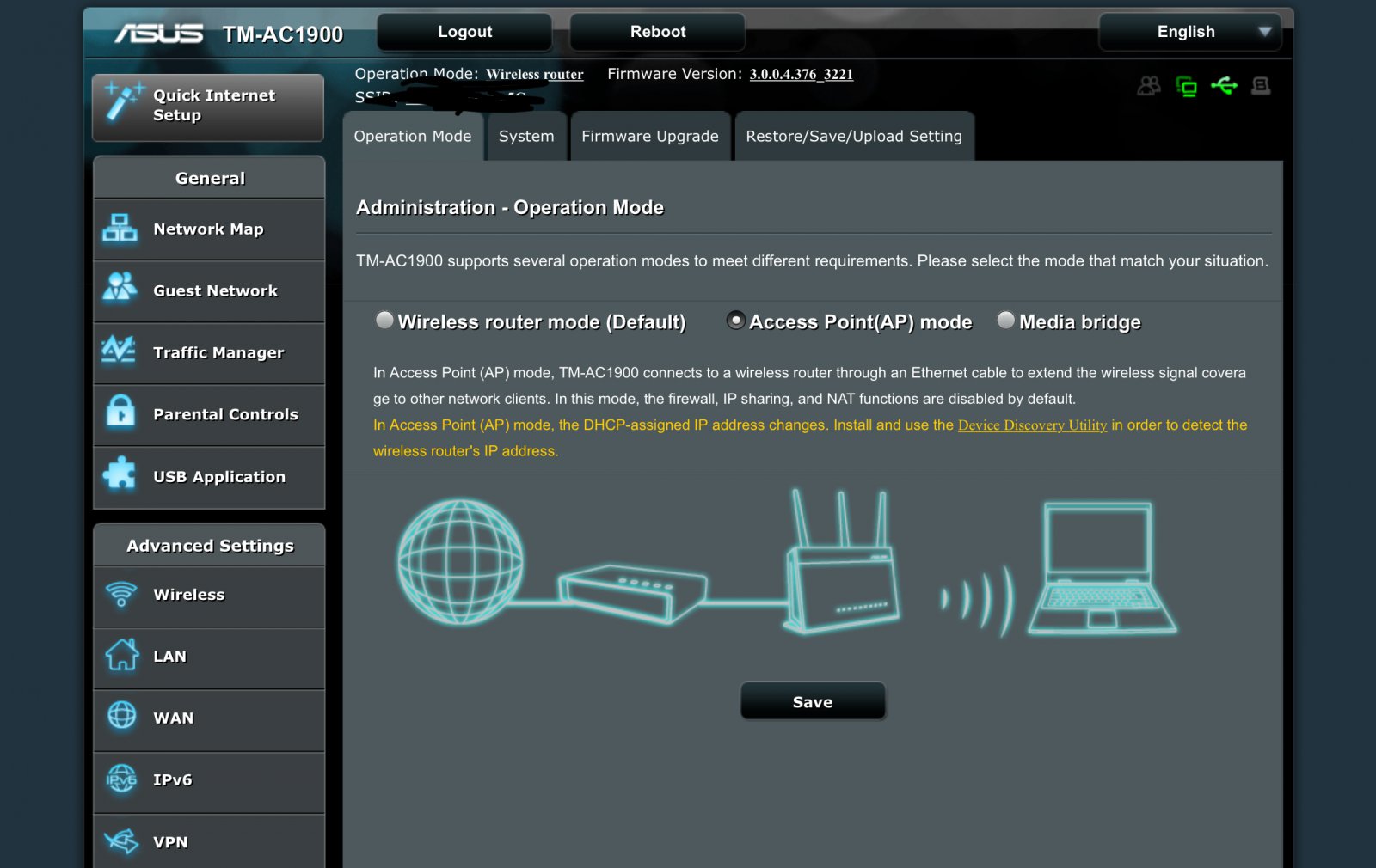

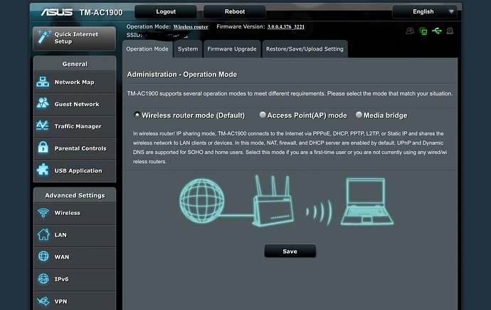

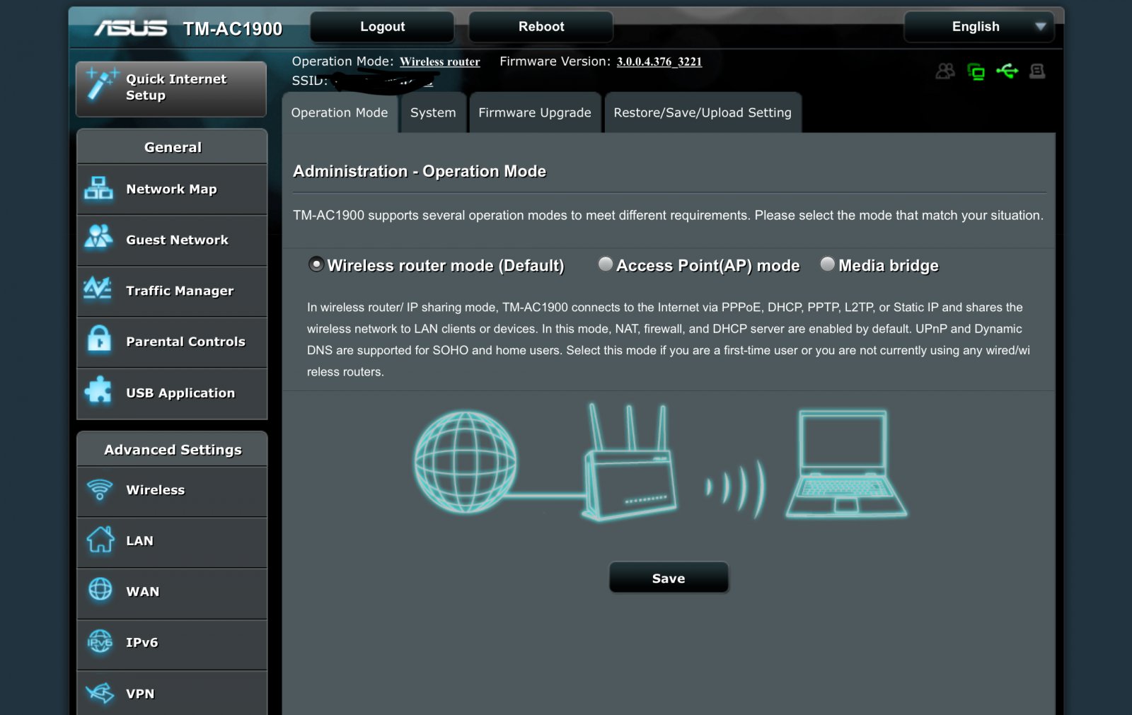

I think i found out something, check the pic. The ASUS router is operating in regular router mode as that is selected.
I guess I need to select the Access Point option as below (haven’t saved yet and will try tomorrow)

Ah, I forgot ASUS comes with AP mode. That will do the trick! Been a very long time since I used ASUS
Some routers dont have the AP mode, so we manually set the IP, disable DHCP and use a router as a make shift access point.

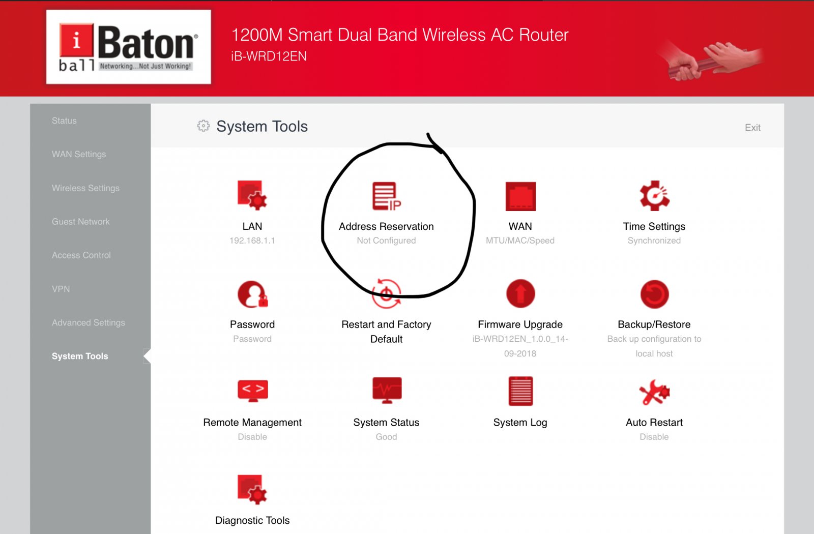

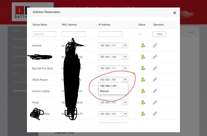

Yes seems here I have to do the address reservation in iBall router..
Thank you everyone that helped. I did exactly how I was told.
  1. First manually assigned 192.168.1.2 in my iBall Router as static IP to my ASUS router.

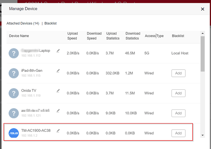

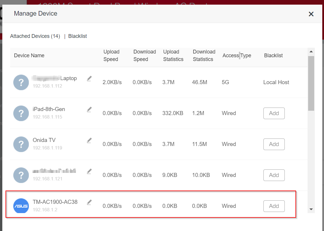

One thing I noticed that now irrespective of what wifi I am connected, all the house wide devices that are connected show in both the routers.
Here is screenshot of my iBall router where it shows me list of devices connected. All the devices directly connected to the iBall router show whether they are connected to 2.4Ghz or 5Ghz frequency but the devices connected to ASUS show up as WIRED (like the Onida TV or my iPad) and traffic flow on the ASUS router always shows 0 KB/s. I don’t mind it but just wondering.

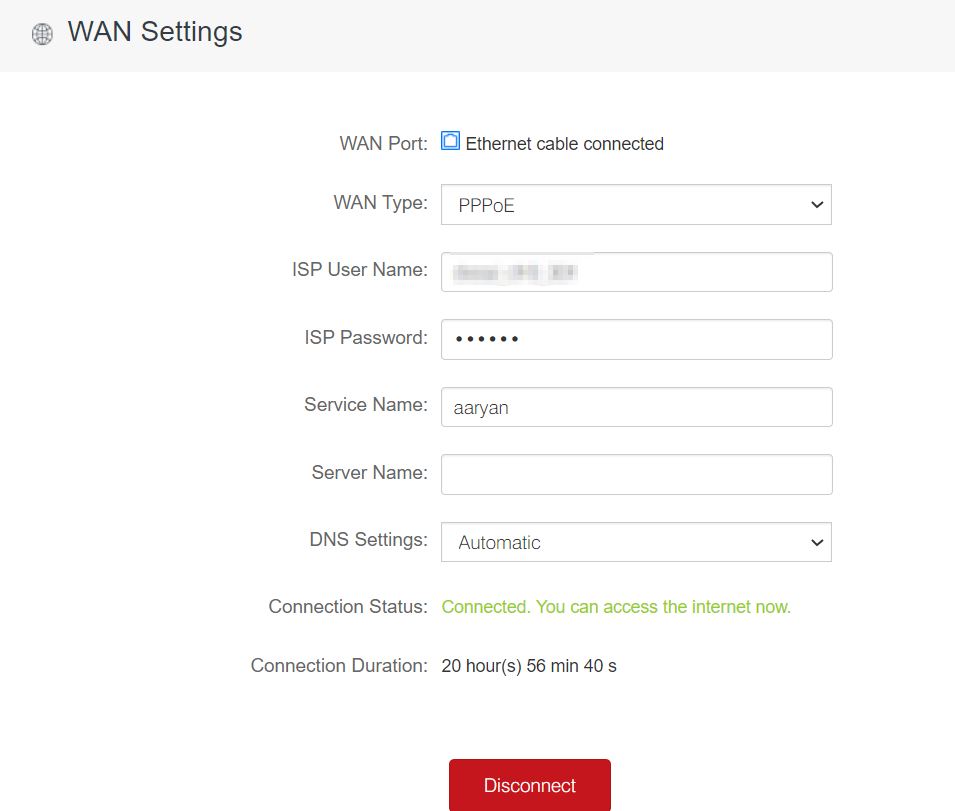

You are right that ASUS does have a MAC Clone feature. I will definitely try that as soon as I find some downtime at home as internet is being used 24x7 (have a family member working night shift). Say if this does not work, can I just put the iBall back in original place and all will work? Also in my iBall router, the setting is like below screenshot, will it still work?
Yes, configure ASUS, switch everything off, swap iBall with ASUS, turn everything on. AC68U takes around 5 mins to boot. If it doesn’t work, you can always place iBall in its original place.
Yes, you can configure PPPoE in WAN settings in ASUS.
