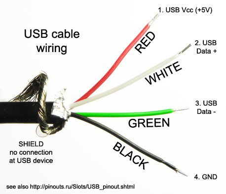

By convention, the red wire is the positive wire, the black is the ground, the white is the Data + and the Green is the Data - . However, there is no standard and this may vary between manufacturers.

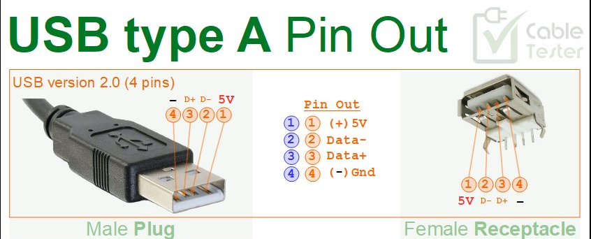

To identify which wire is which, we will have to use a multimeter set to continuity mode and test the wire from the USB-A plug to the cut end. Below is a diagram showing which pins are which signals. This is standard across all connectors.

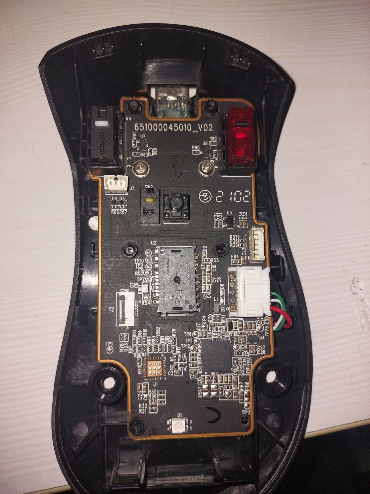

Once you have opened up the mouse, you should be able to see something like this:
At the bottom of the picture, you’re able to see a black wire that splits into 4 smaller wires which are connected to a PCB. This is the USB wire. You will be able to trace it to a small hole through which it leaves the body of the mouse. Now, you need to cut the wire an inch outside the hole (Out of the body of the mouse). The reason for this is that we want to have some slack with the cable while also giving us enough room to correct any mistakes we may have made.
Once the wire is cut, we need to remove the PCB from the body of the mouse. They are either held in by screws or by friction. Check for any screws, if you’re unable to find any, then they are probably held in by friction (like the example above). When removing take care not to damage the sensor below the PCB. It is of 2 parts, the sensor itself and a piece of plastic lens. Both of these are important, take care you don’t scratch them by mistake.

However, if nothing is marked on the wires, you can still find out how, just that it will take some extra time. You need to probe the USB-A connector against the cut end of the wire to find out which wire is which. For reference,use the image linked above. and again here below Do this stage patiently. It’s okay if you make sure twice instead of just once. We don’t want a blown mouse or even worse, a blown computer. (A very real possibility when you mix up wires)

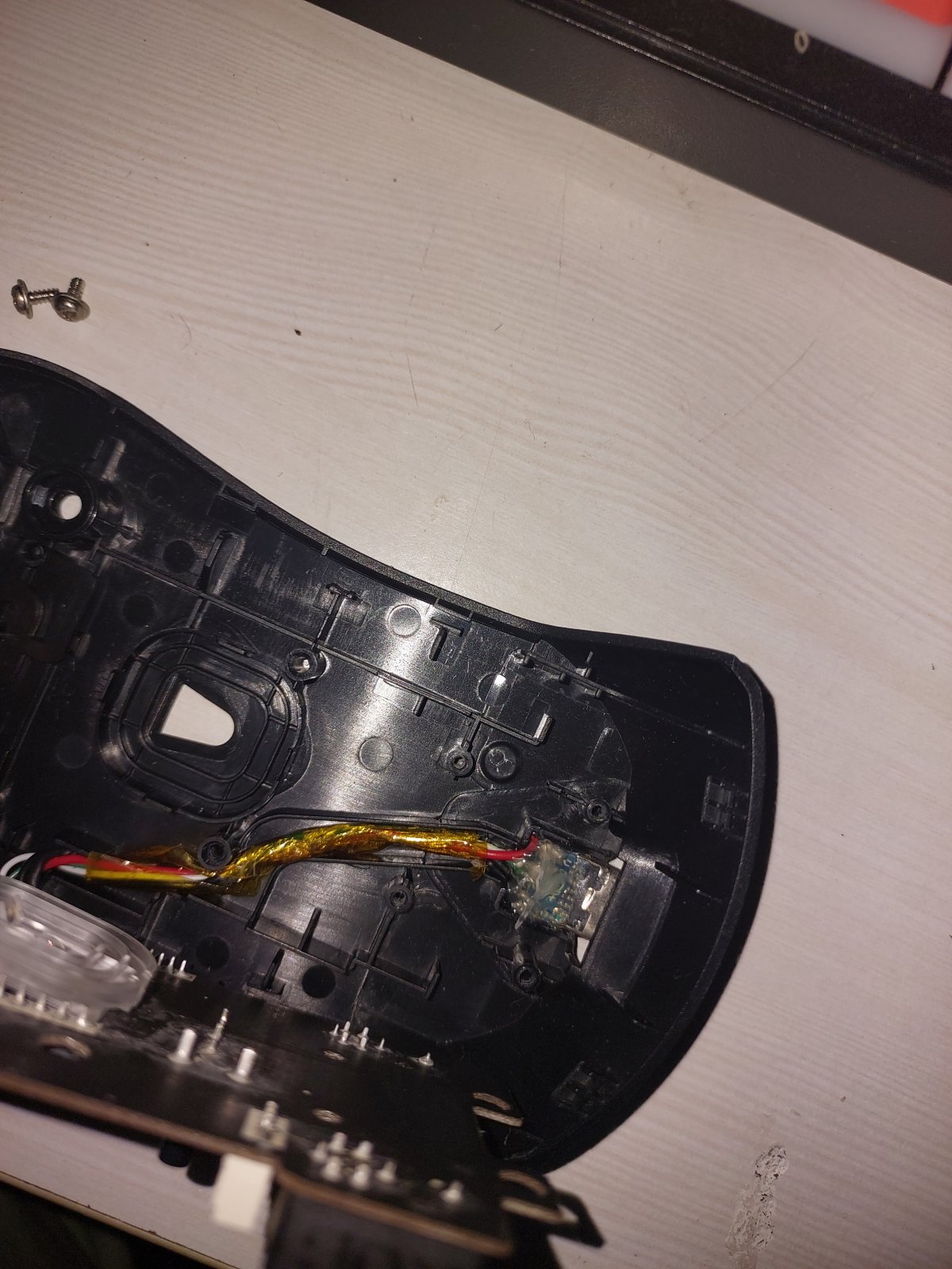

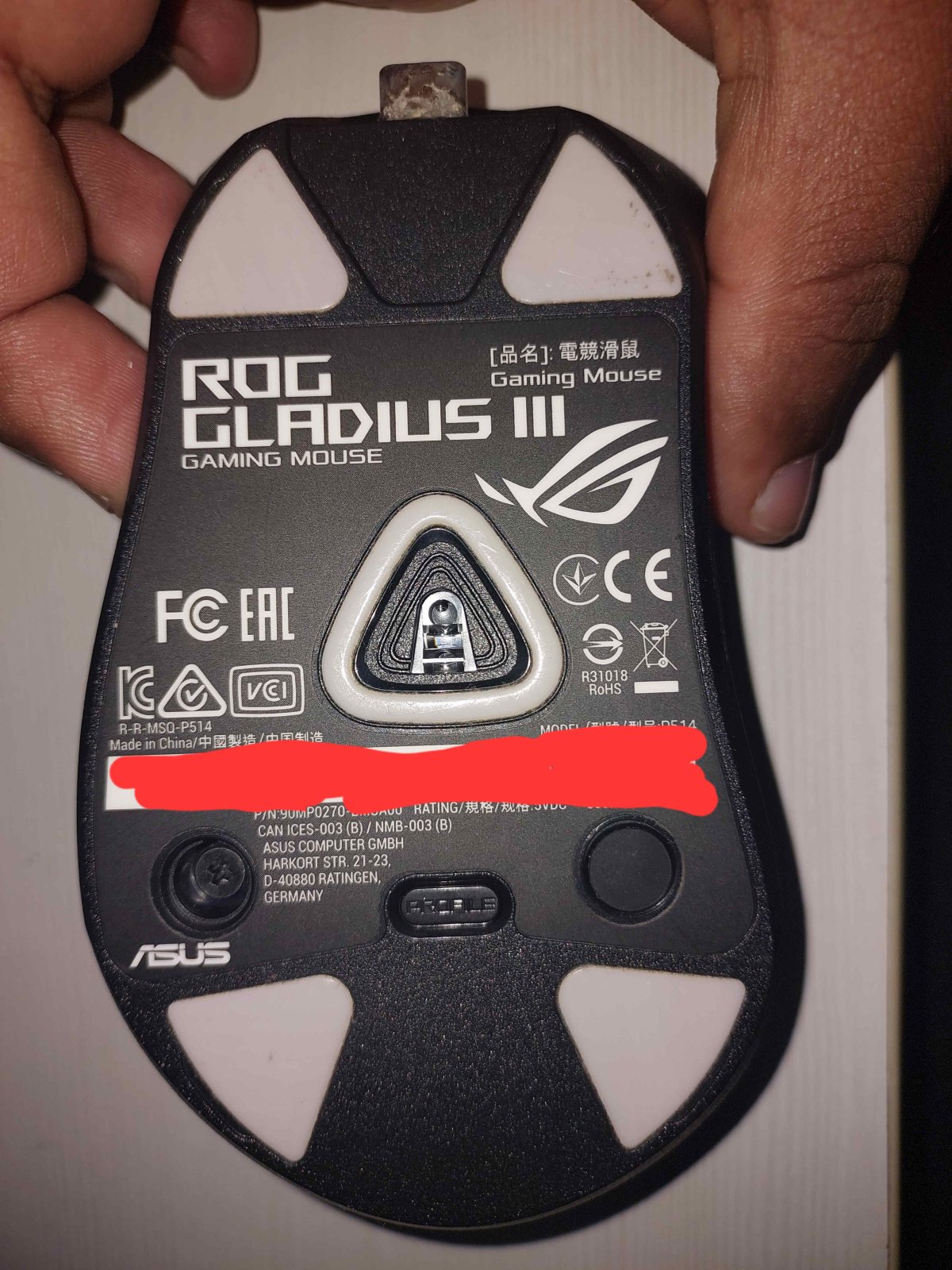

These are the images of the mouse I modified.
As seen, the USB-C female plug is jutting out on mine, but it doesn’t affect the functioning of the mouse in any way and I am more function over form, hence this doesn’t disturb me.
The USB-C breakout board with the base PCB (The mouse wheel is removed in this picture)
The USB-C breakout breakout board fixed with hot glue.
The yellow tape is Kapton tape. It acts as a insulator between the base PCB and the wires, preventing short circuits. This came standard with the mouse. You can add this if you want to, but the tape is extremely costly.
