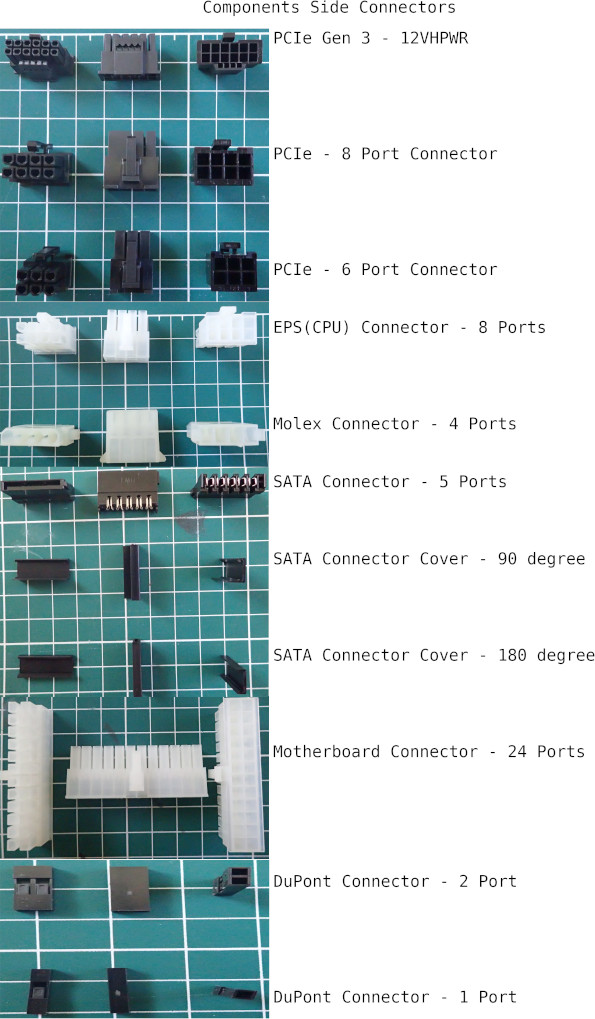

Option 1: New set of cables, based on the requirements all of the cables(Motherboard,EPS,Molex,PCIe,SATA) can be made new.

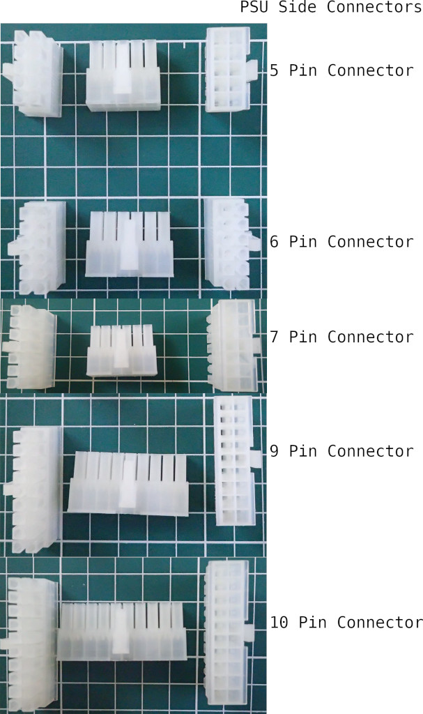

Option 2: Customizing(Reducing the length/Adding more connectors(on Molex/SATA Cables Only)) the existing cable. If you send the existing(OEM) cables then, it can be reduced in length as per your requirements. One end(PSU side) of the cables will be trimmed and re-crimped to achieve the reduction in length.

1 24 Motherboard 18 18 For +3.3v AWG 20 is recommended but to keep it uniform I use AWG 18
2 8 EPS(CPU) 18 18
3 4 Molex 18 18
4 4/5 SATA Power 18 18 SATA V3.2 dropped the +3.3v requirements, that’s why we have 4 pin sata cables, but if you need +3.3v let me know
5 6/8 PCIe 18 16 If you prefer AWG 18 instead of 16 then please let me know.
6 12 PCIe Gen 3 Power Wire 16 16
7 4 PCIe Gen 3 Signal Wire 28 28 If you want to use a higher gauge wire, let me know

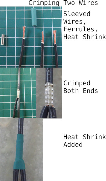

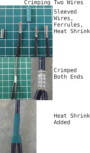

[HEADING=3]How I join the wires[/HEADING]
  1. Select an appropriate size ferrule.
  2. Remove the plastic sleeving from both wires.
  3. Crimp the wires.
  4. Use relative colour heat-shrink tubing over the ferrules and wire to prevent short circuit and to keep the wires in place.

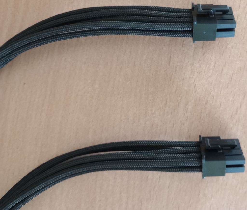

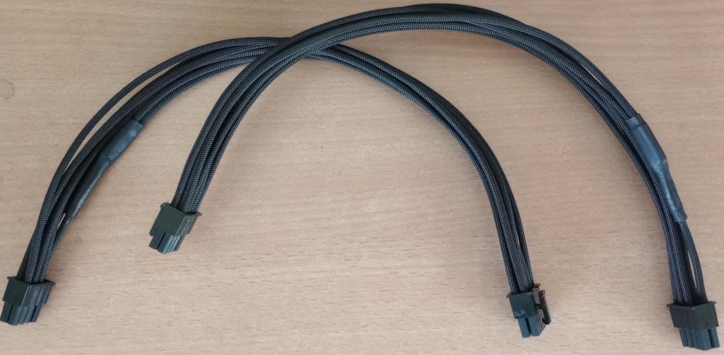

Recently did a custom pcie 8 pin cable job for @@rajch2002, Attaching the pictures as I have not uploaded any previous works.
Cable Specification: 2x8 pin PCIE with black sleeve(black paracord)

Good work! You should be able to use less heat shrink if you solder the two wires instead of using ferrules. Look forward to seeing more custom jobs.
