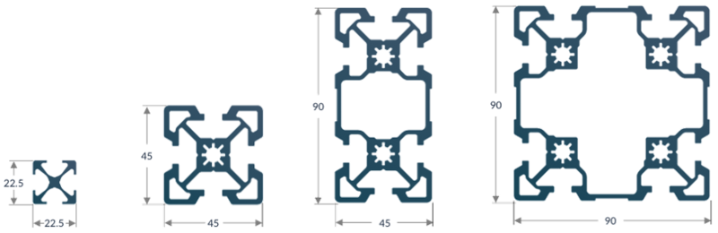

I’m building my own 45U open frame server rack! The frame will be made out of 4040/2060/2040/2020 extrusion, this is actually my second rack. The first is all covered up in the background, since I (temporarily) ran out of budget for that project — that one is “work” related while this one is for personal use.

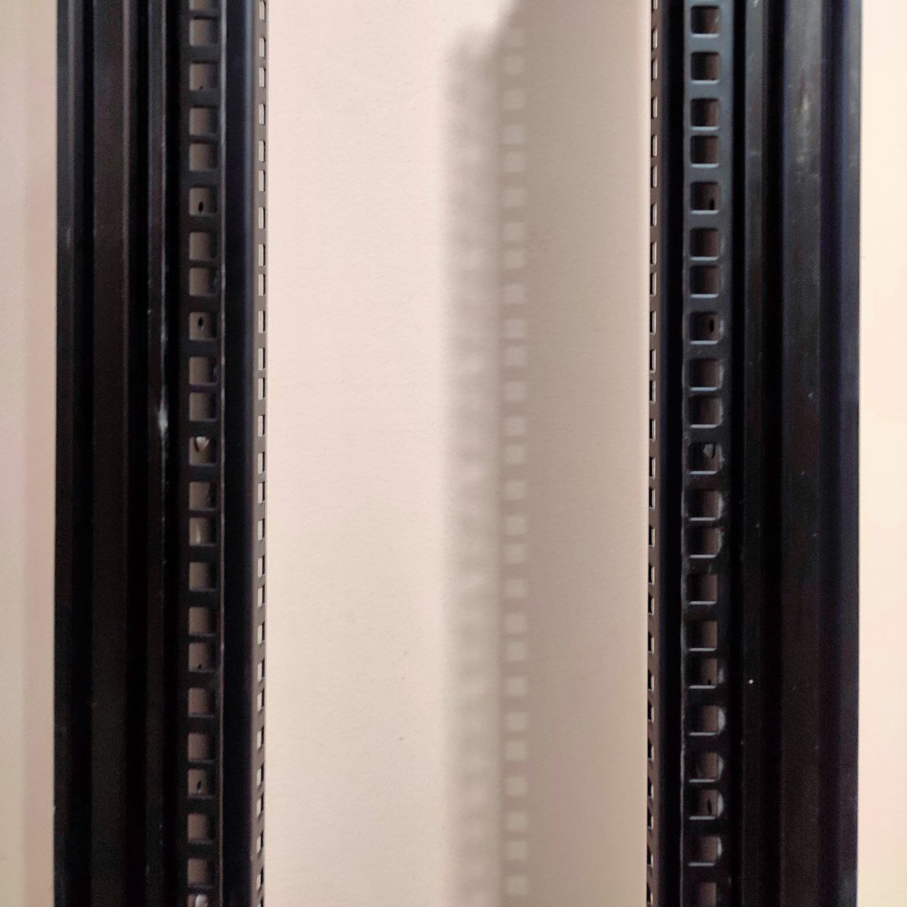

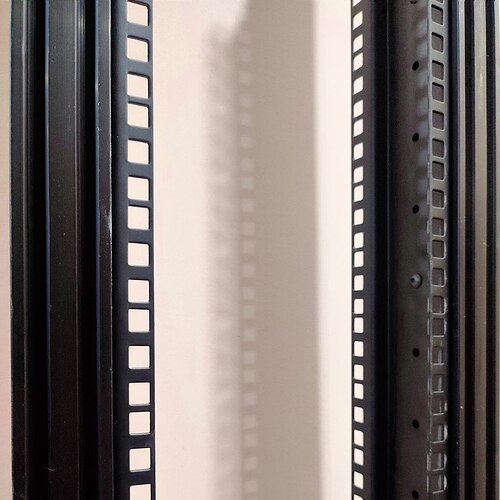

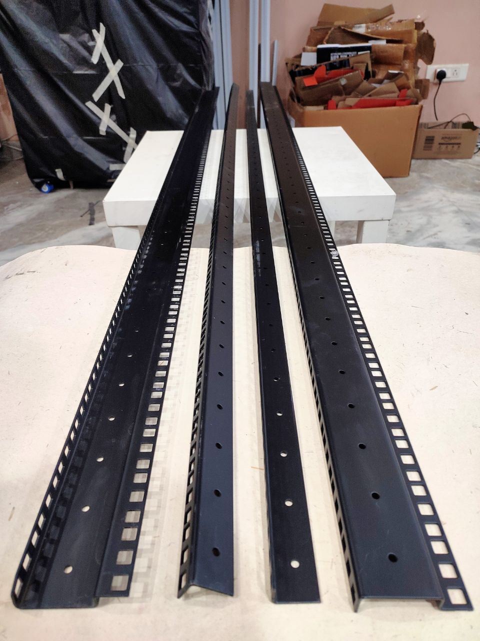

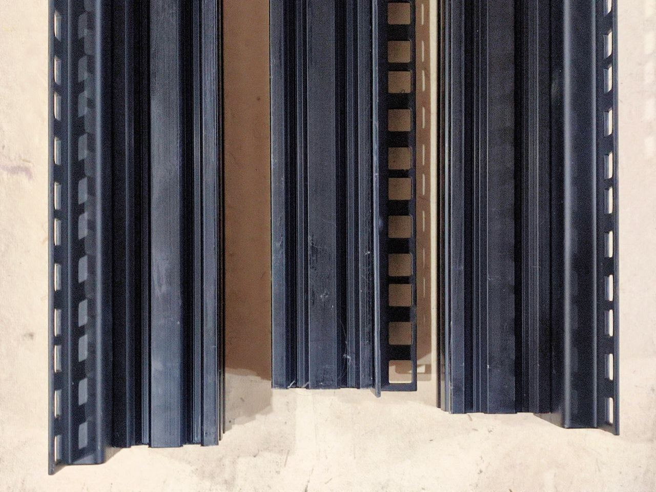

If you want to do something like this, keep in mind that these rails are actually slightly taller than 45U — the double rails are a few mm longer, and the regular rails are twice as much. Buy the rails first, measure them, then buy the extrusion. Maybe I’ll make a build log out of this one.
These are from Penn Elcom on Amazon, the double rails will be in the front and the other two in the rear. I probably should’ve gotten double rails for all four corners since it was like just Rs 100 more per rail. I’m assuming the double rails help with rigidity when mounting equipment that don’t extend all the way back and instead have extra mounting points on the sides behind the ears. Or maybe they’re for 0U PDU’s?
I’ve never even seen a server rack in person so this is all very exciting for me, I’m loving the high-quality matte black power coating on these — most rack owners probably don’t say things like that, haha.

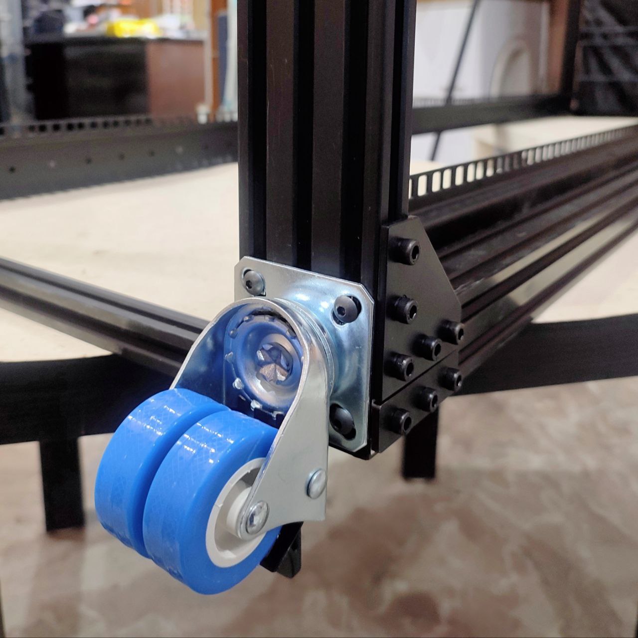

The castors I’m going to be using are these:
https://www.amazon.in/dp/B08CC9441R
They have 40mm wide mounting hole pattern which is perfect for a 2060 extrusion that I’ll use as the base. They’re rated for 60kg per castor, so 240kg overall. I’m not intending to use any actual rack mount servers though, there will be a rack mount UPS that’s 10KG, a battery pack that’s 70KG, and maybe one or two full sized desktops. Maybe a patch panel, a router, a switch or two, and shelf or two holding a few tiny pcs. The 240kg limit might end up being a factor later though I’m not sure how I’ll overcome it — the design of the rack in my head is a basically a wireframe cube with castors on the bottom four corners and no solid panels (for now).

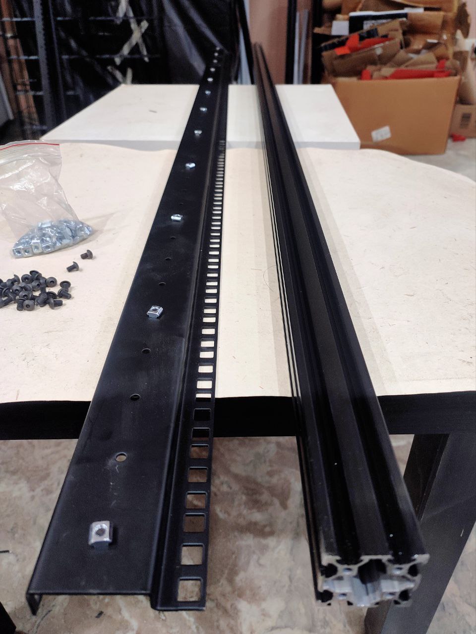

So a build log requires you to do actual building, haha. I’ve got three of the four rails attached to the extrusions and then I ran out of fasteners — more are on the way, should arrive in a few days.

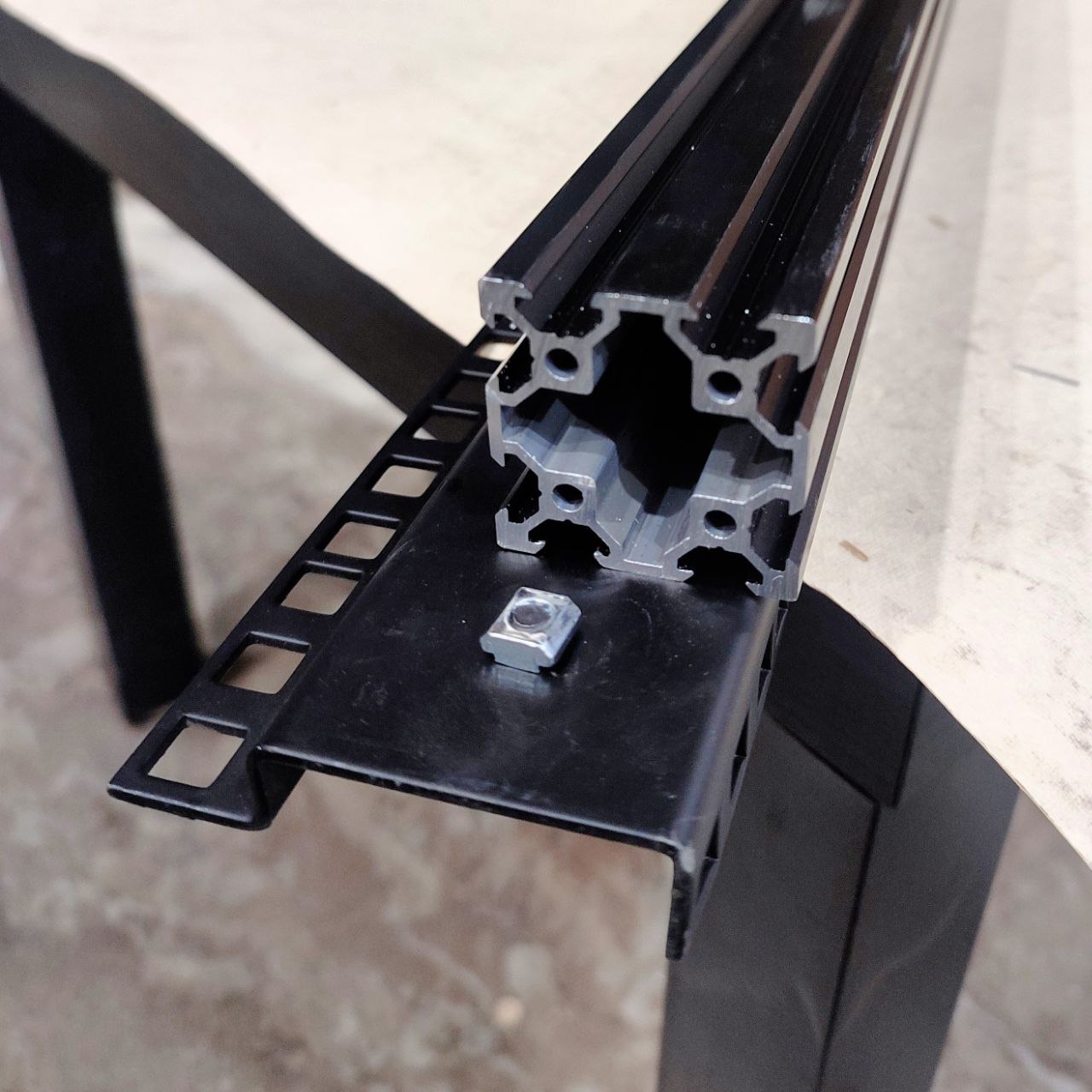

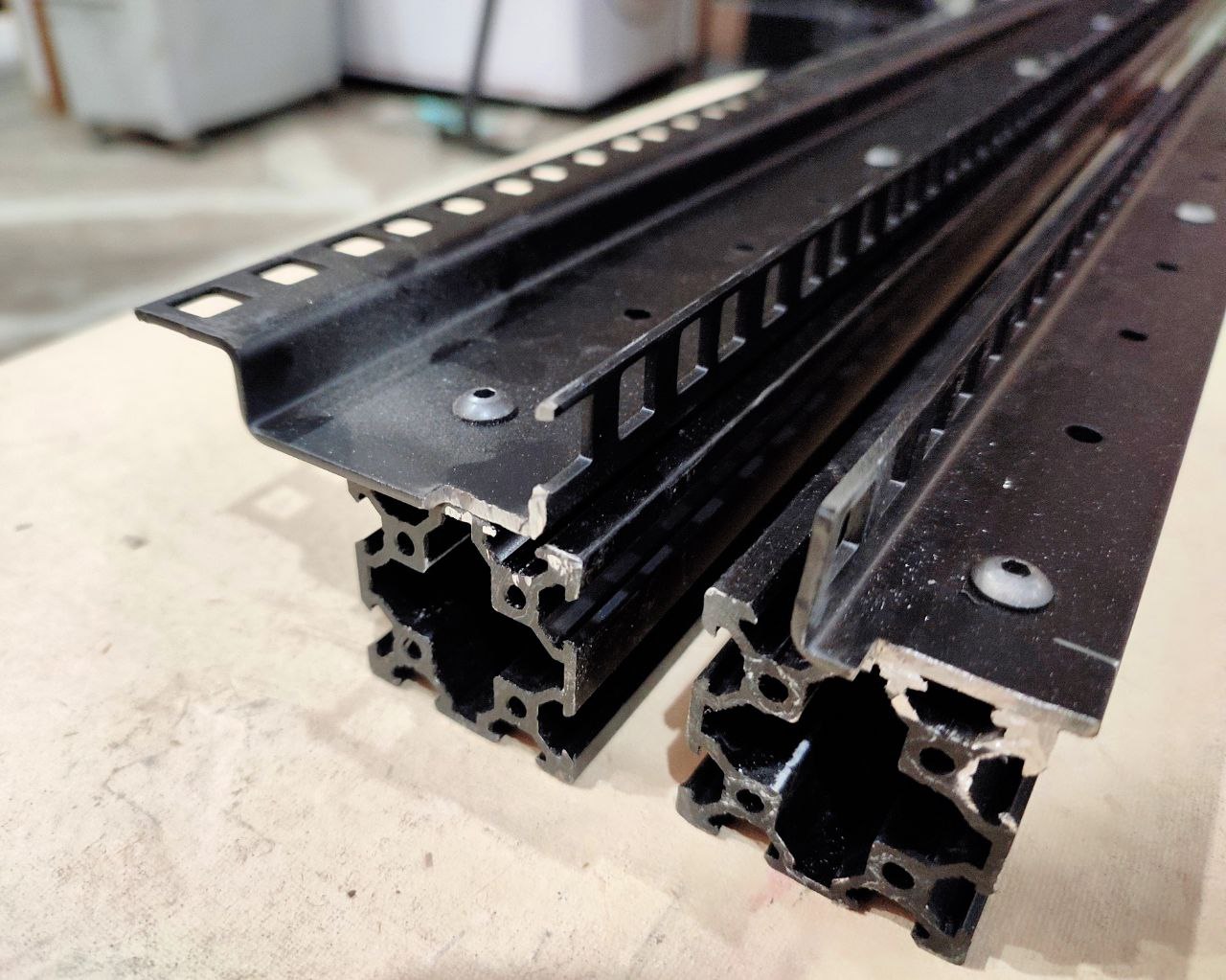

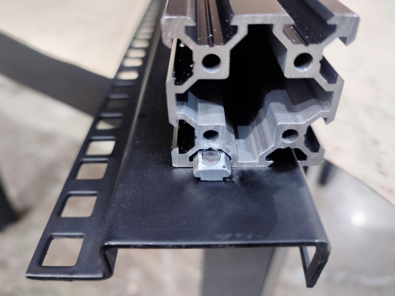

Started by putting in sliding T nuts loosely screwed onto M5 x 8mm button head screws, spaced three holes apart on the rail. That should be fine and is probably overkill with how heavy these rails are.
The extrusion is then coaxed over the sliding T nuts, the double rails went on smooth but the single rails were slightly warped so it need some light hammering with a mallet.
If you’ve never seen how T nuts slide inside extrusions, this is how they fit. Once fully slid through, I tightened the first and last screw, then every one in between to make sure the rail as straight as possible with the extrusion.

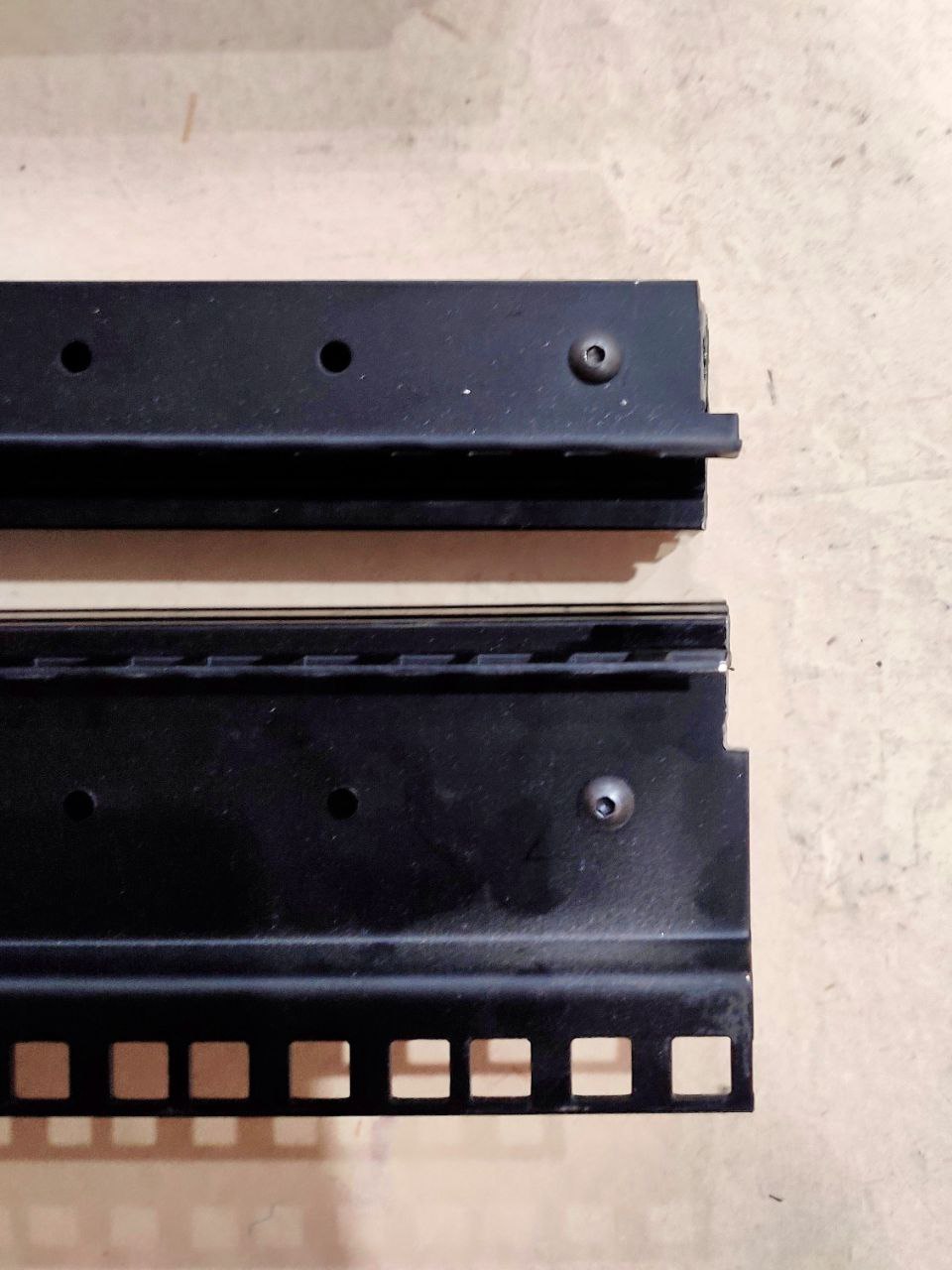

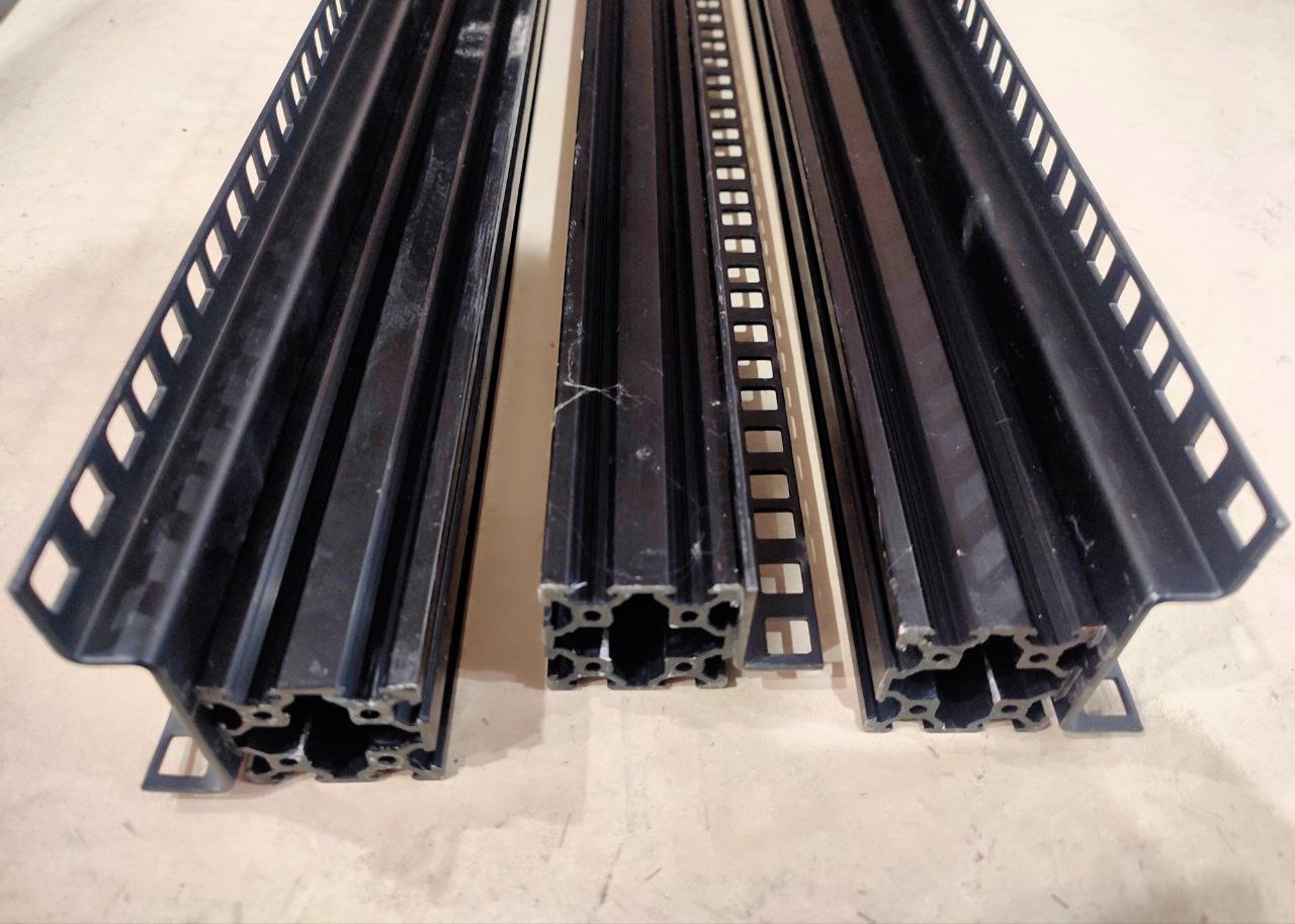

Here you can see how the rails are ever so slightly longer than the extrusion. There wasn’t much I could do about this, novo3d.in has the best prices for 4040 extrusion and they only sell lengths up to 2 meters.
Another angle of the overhang, I’ll probably end up grinding/cutting away part of the excess which would limit what I could put in the topmost 1U, probably a blanking plate or vent or some kind of status panel.

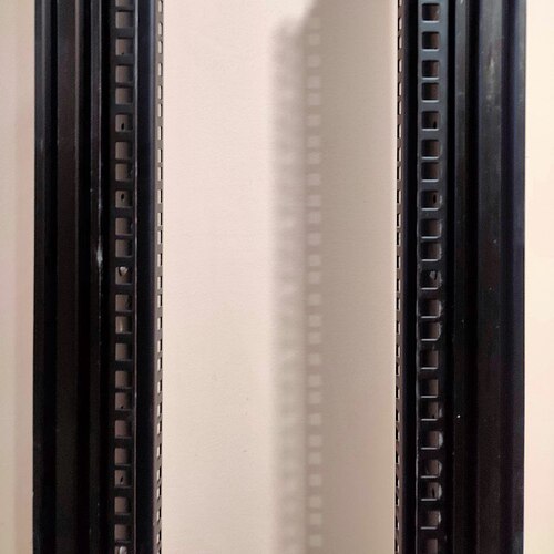

Standing them up makes It almost feels official, haha.
A better angle after I realized that that last photo wasn’t very good.

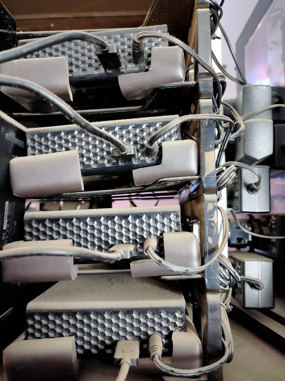

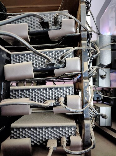

I have these stuck to the four corners of the external drives I have:
https://www.amazon.in/gp/product/B08DDSYGGC/
The drives are placed on the shelves of a letter tray:
https://www.amazon.in/gp/product/B07VZP19F5/
And the letter tray is on top of a cupboard. They’ve been this way about two years now, I haven’t shucked or dusted them since connecting them up to USB hubs.
They’re this way because I’ve avoided spinning disks for over a decade now and I don’t know how resilient drives are so I took all the precautions that I could.
I’ll probably shuck them after the warranty runs out next year.

But the rails ended up being longer than expected, and they needed to be cut/grinded down to match the length of the extrusions. So I did my best to channel [This Old Tony](’
https://www.youtube.com/@ThisOldTony/videos
)'s work ethic and managed to get some cuts in with a rotary tool, I’ve never actually done anything like this before but it turned out alright:
I actually cut the wrong side of the single rail, I should’ve cut the side with the square holes.
But the cuts were clean, so I’m happy with how it turned out.

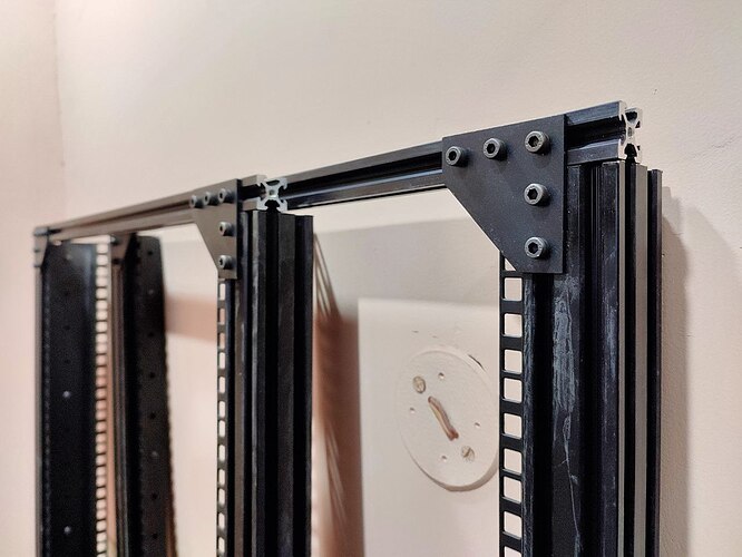

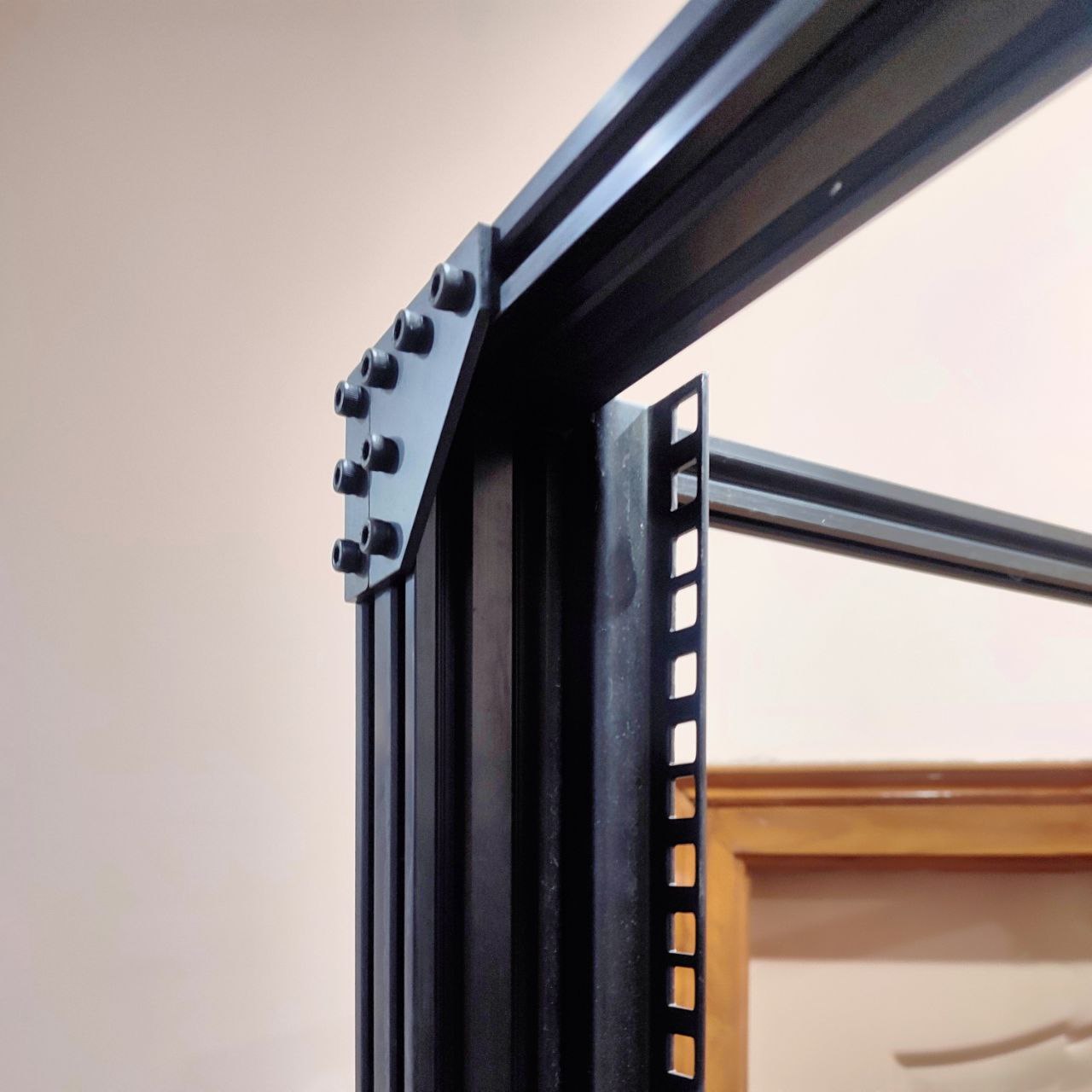

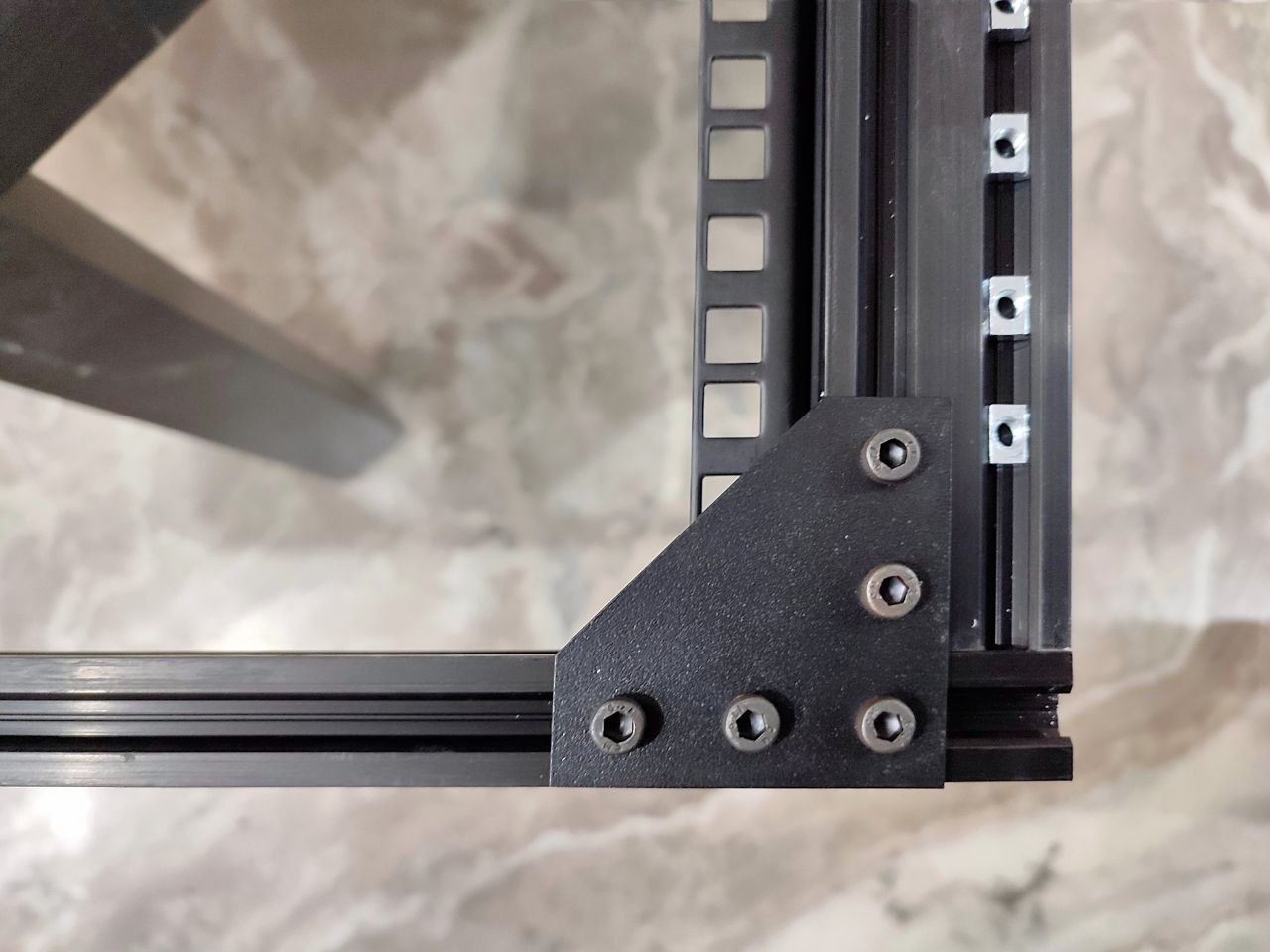

The first of the joining plates, connecting two of the pillars together on top and bottom. I might not have access to the first and last 1U, that’s okay, there’s plenty of space left and I like how these joining plates look instead of the regular L shaped ones. There’s another joining plate to be added next to this, a straight “I” shaped one.
That’s the front and the rear of the rack half-way done for now
The front and back will be connected to each other with 2040 on top and 2060 on the bottom.

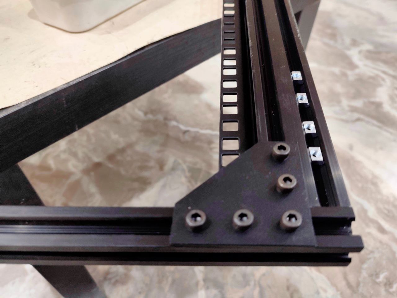

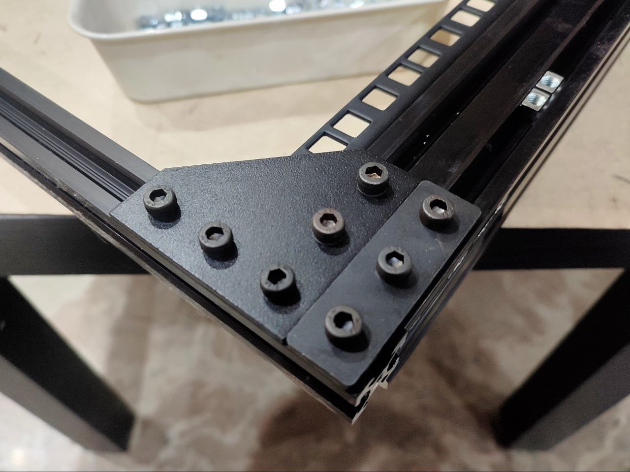

I usually use 4 hole straight “I” joining plates from novo3d.in but they’ve been out of stock for a while now, so I settled on 3 hole plates from robu.in and it turns out they’re made for M4 screws, not the M5 I prefer. So I had to find another source of these plates, or source M4 screws along with M4 T nuts… or spend most of the night drilling out the holes for M5 screws.

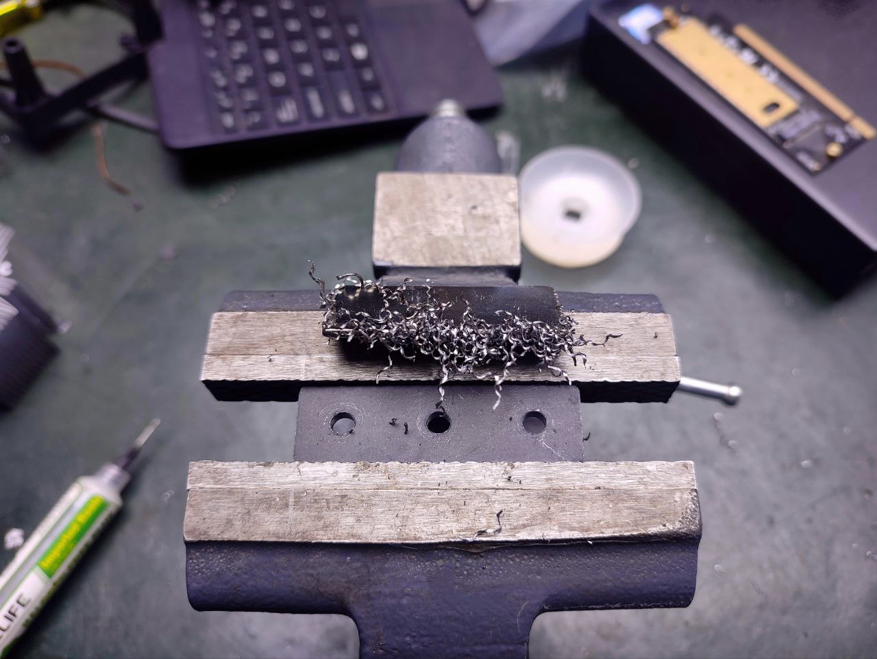

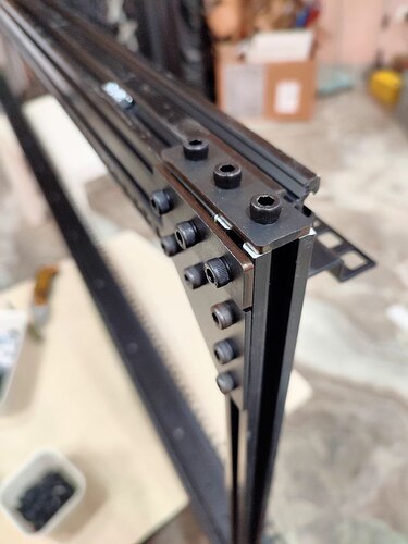

So the night just ended and here we are. I used a file to sharpen the bit I had to make it easier, but it took a while to drill out nearly 50 holes, three at a time. I remember a tip I saw on a machining video on Youtube a while ago, that’s placing a strong magnet nearby to catch the shavings so you don’t make a mess of it all:
And with the plate attached:

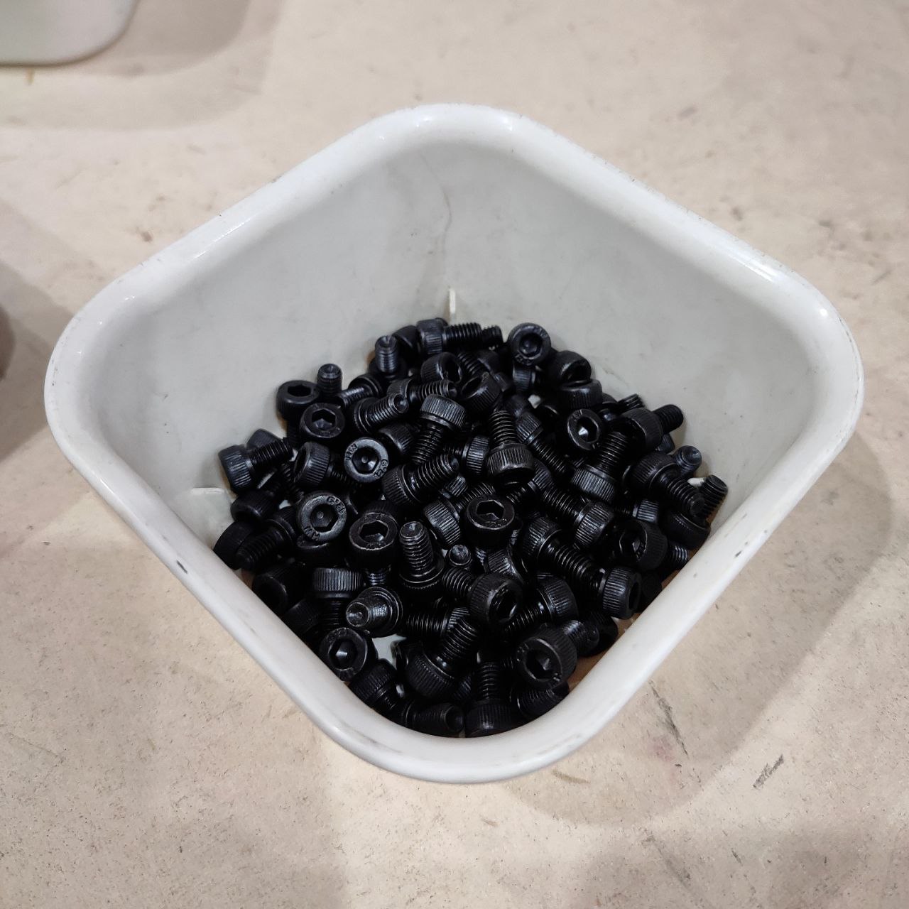

I remember a lifetime ago, I was critical of modders who used socket head screws like these in their scratch builds instead of the more sleek button head or flat head ones. But now, years later, I think I finally understand why everyone preferred the more prominent/hardcore/imposing/extreme appearance of socket head fasteners. They just look so serious and overbuilt.
I might be some kind of weird fastener afficinado, earlier today I was happy to receive a pack of flat stainless steel spring washers. My family thought I had gotten a promotion with how happy I was.

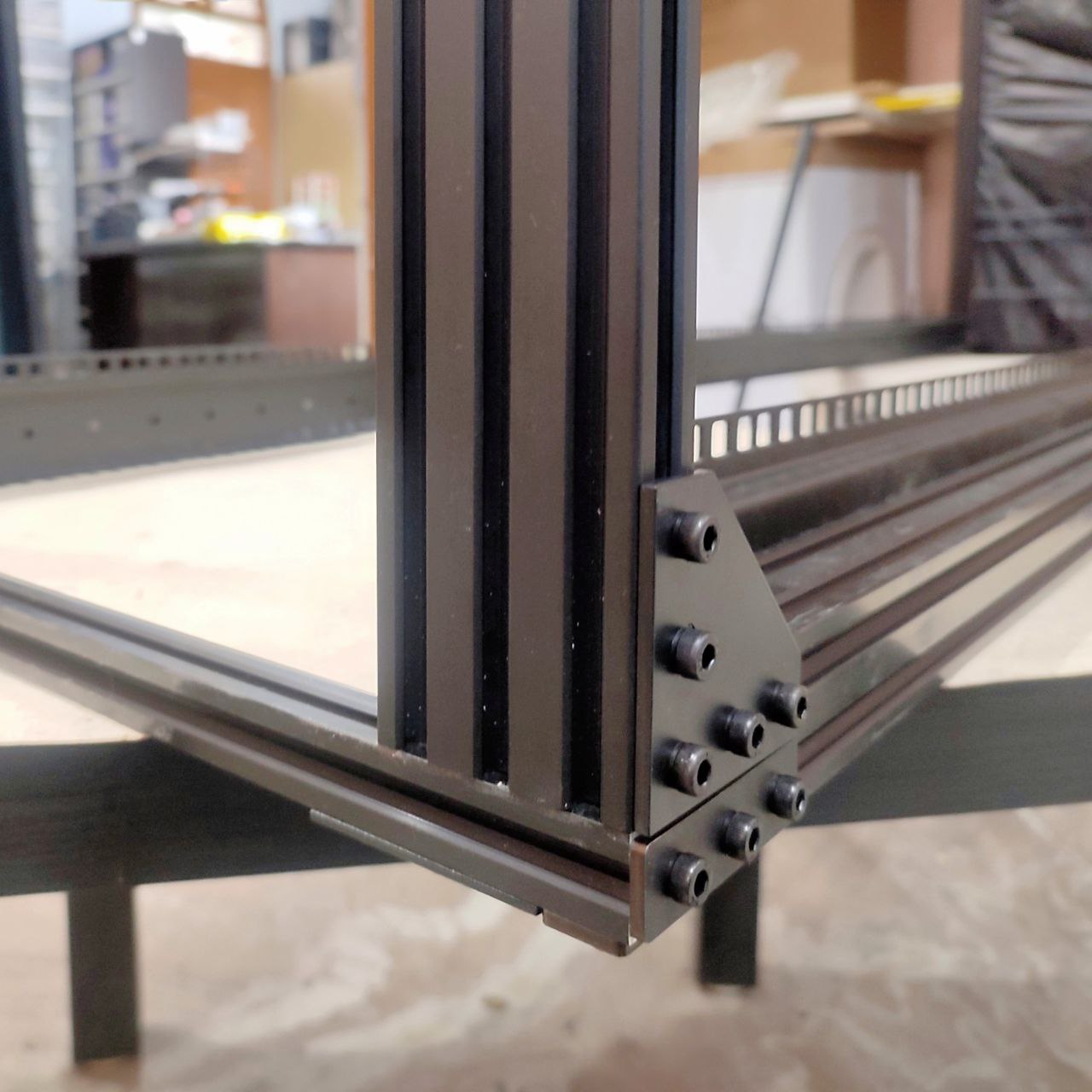

So any way, that’s the general idea of each corner, an “L” shaped joining plate next to an “I” shaped joining plate. Four corners per side and four sides, so that’s 16 plates each. this adds up to 128 fasteners and 128 sliding T nuts.
Nothing planned for the top, but the bottom will have a castor on each corner.

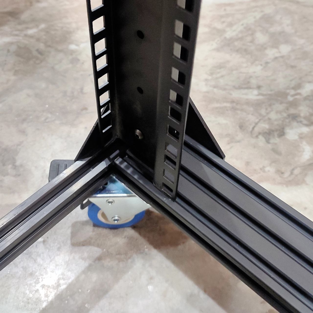

The fasteners are here! Look at these freshly oiled beauties:

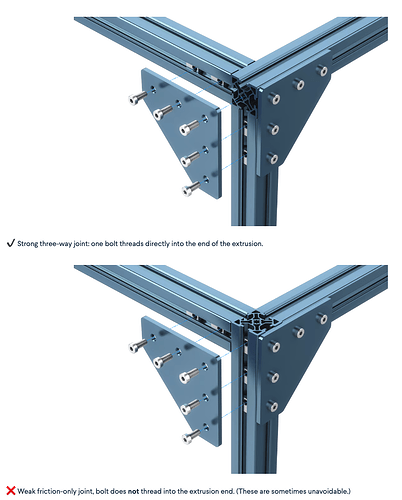

It’s actually 120, eight of the fasteners thread directly into the ends of the 2020 extrusion like this:

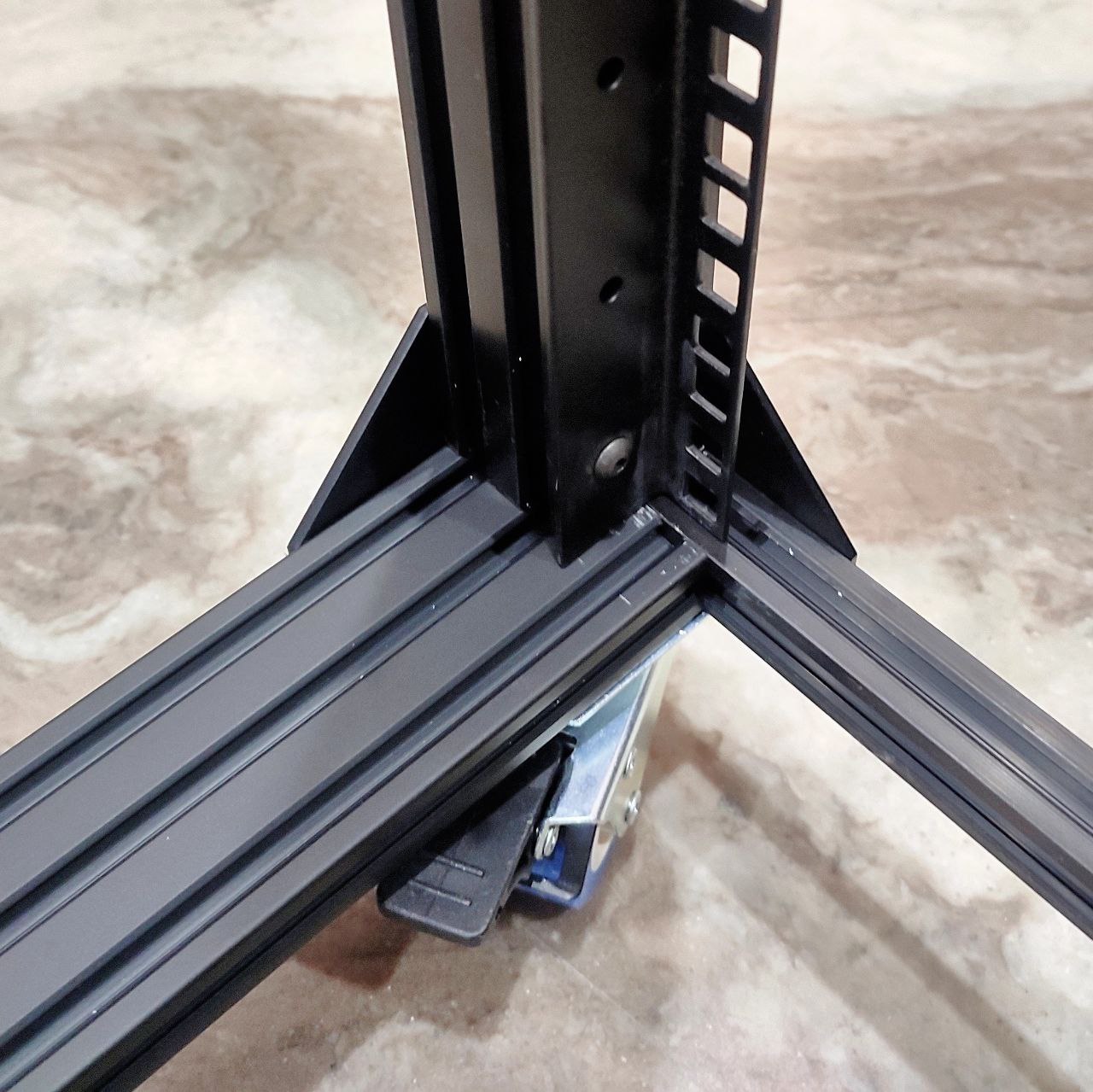

Rotating that a quarter turn to attach the 2060 pieces for the base:
And then attaching the castors:
I could’ve used socket head screws here, there’s plenty of clearance.
Front bottom inside corner looks like this:
Rear bottom inside corner:

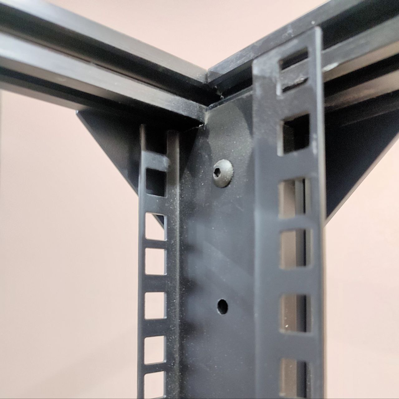

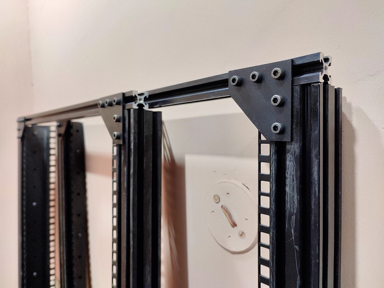

Front top inside corner, with the cut I made in the rails:
This gap is intentional for future side panels and/or cables:

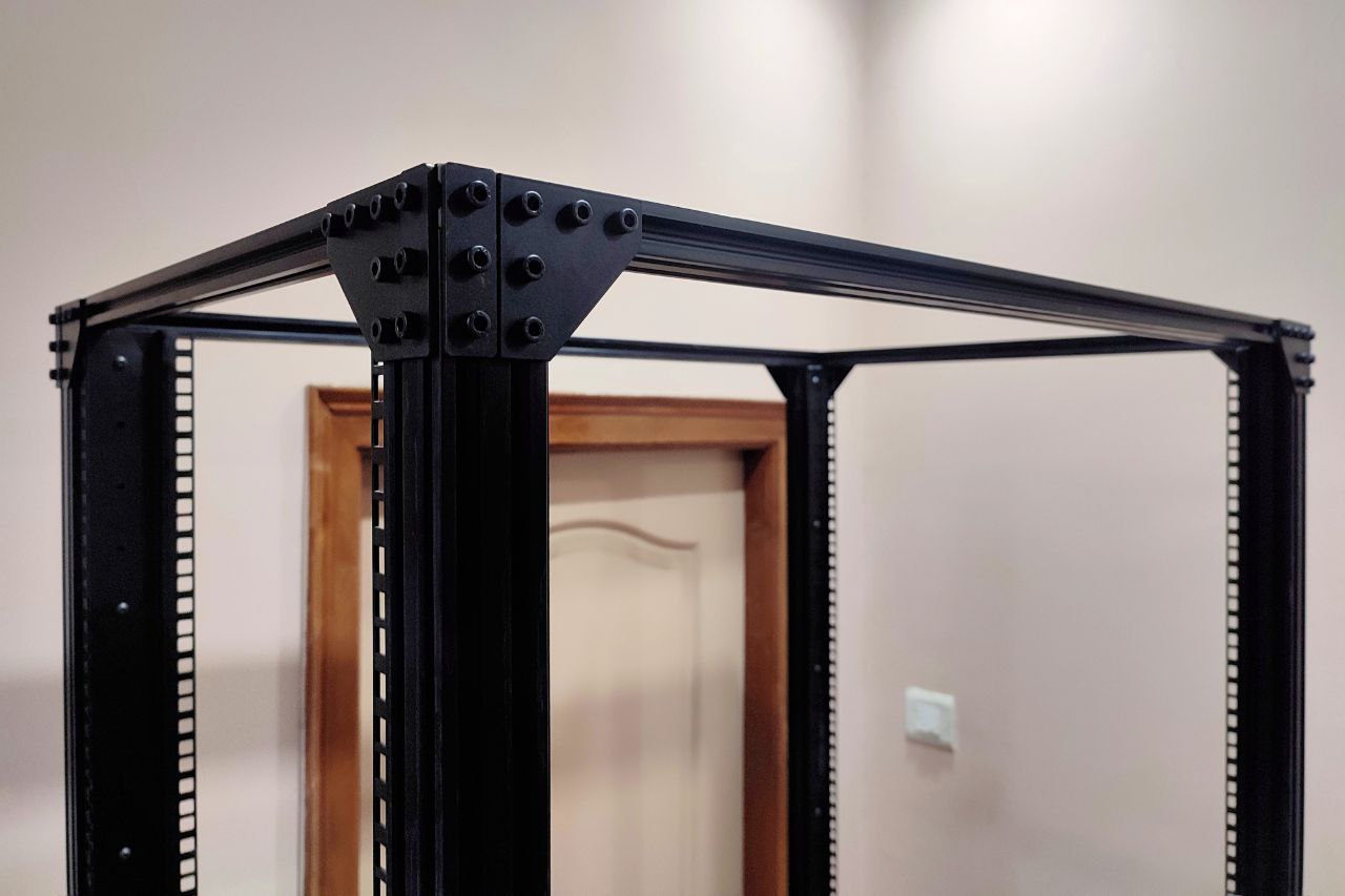

Top of the completed rack:
Bottom of the completed rack:

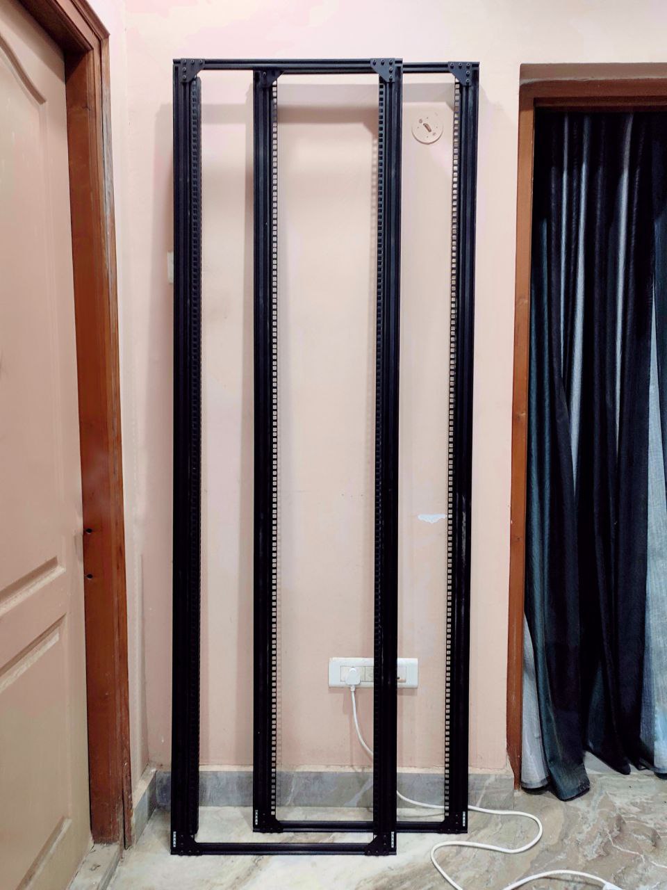

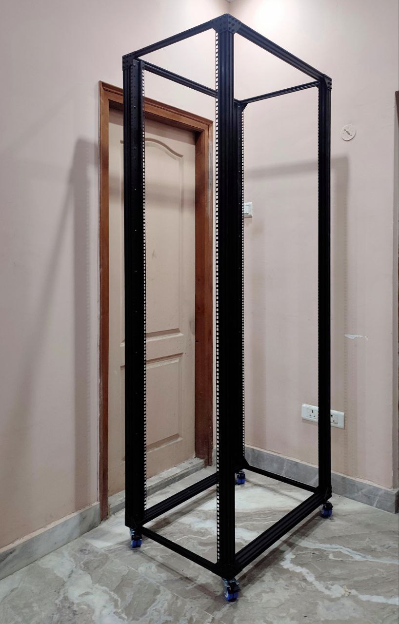

And finally, the finished open frame rack:
The 4040 extrusion actually ended up being 38.5mm on each side so there’s a 3mm extra inner space between the front and the back, which isn’t much of an issue in this design since it’s all open.
I estimate this would’ve taken about three hours if I had all of the fasteners I needed and there was nothing to drill out and/or fabricate.
Total cost was around Rs 25k.

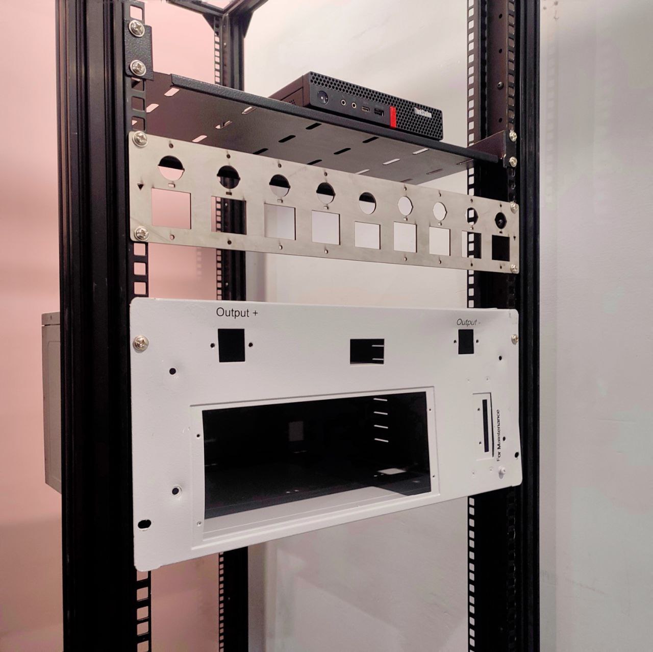

@@rahuljawale kindly offered to send over some cage nuts and screws so I was finally able to mount something in this rack:
Top to bottom are:
  1. A [10" shelf from Mass Rack](’
Amazon.in
) on Amazon, purchased two years ago in anticipation of this project — finally put to use!
  1. Front panel of a 2U Tasmota based energy monitoring PDU that I’ve been working on.
  2. The remains of the mangled [MuscleGrid](’
Teardown & Rebuild of a MuscleGrid LiFePO4 Server Rack Battery - PC Builds, Modding & Overclocking - TechEnclave
) enclosure because why not.

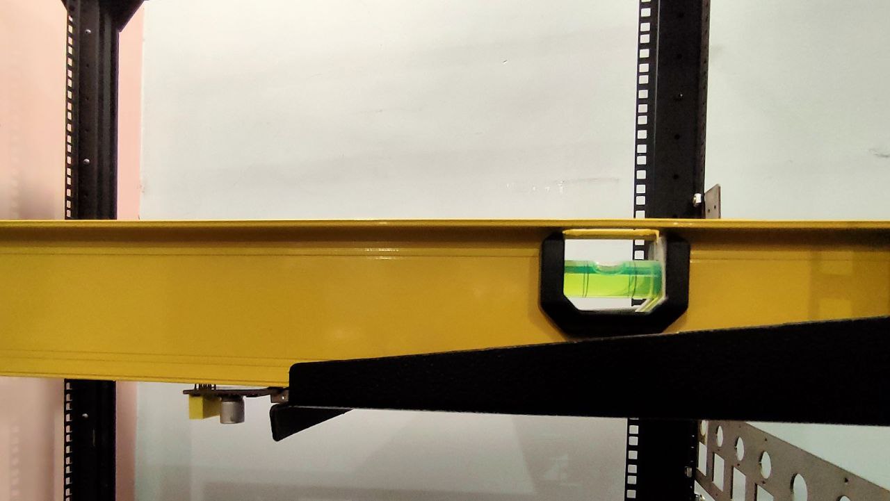

Does it bend with the Tiny on it?
A little, I propped this level by 7mm at the far end with a USB flasher to make it level:

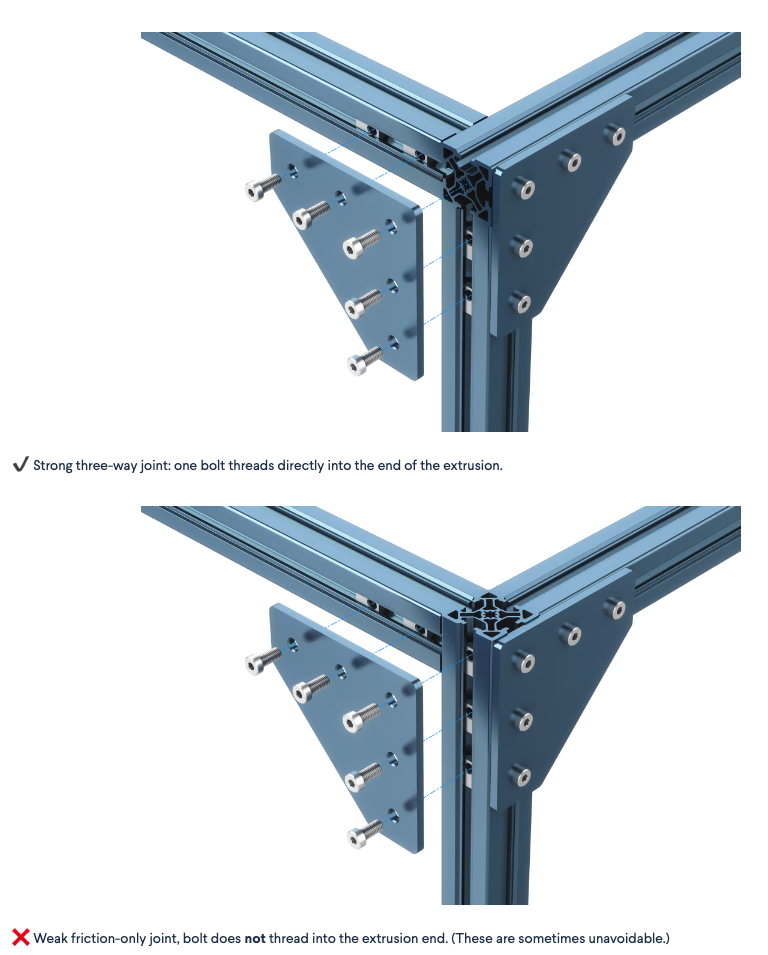

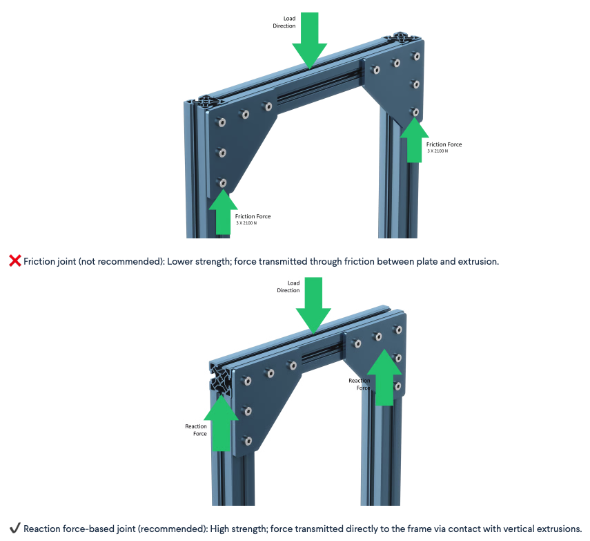

When I came up with this, I followed Vention’s guidelines for best practices:
I’m attaching summarizations here:
In my design, the rails are attached to the vertical pillars, which then transfer that weight down directly on the castors — this was a conscious decision:
So the weight limit of the anything mounted to the rails is directly related to the weight bearing capacity of the castors, which is 60KG per or 240KG. The rack it self is 25KG.
Any equipment mounted to the rails will also serve as cross bracing between the 4040 pillars, the existing 2020 lengths serve as just spacers, there is no appreciable load on them.
You’ll need to use 2060s for the bottom with at least three casters in the front and three in the back, preferably four (eight in total). I’ll probably end up doing that when I get more equipment in mine.
