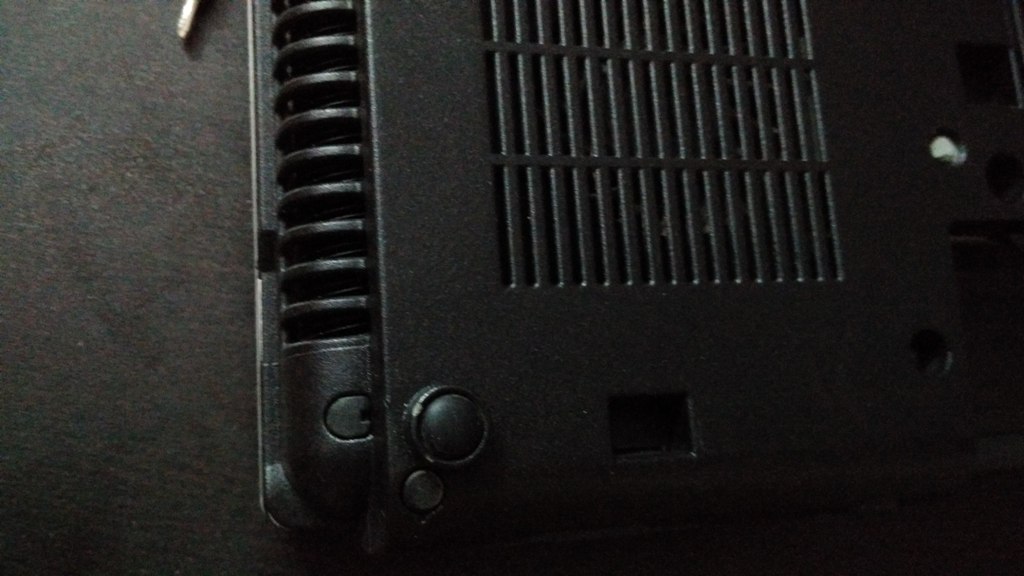

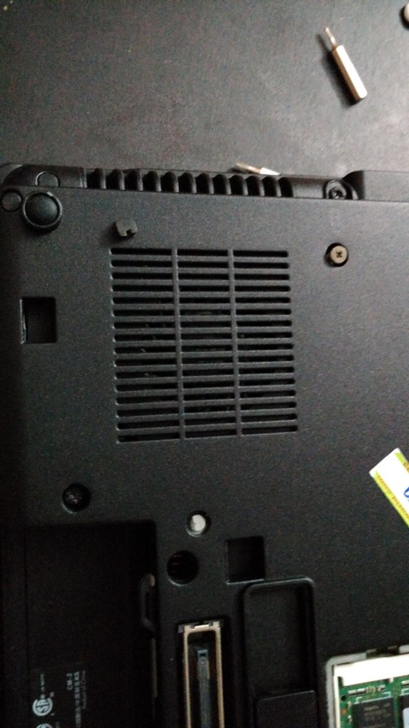

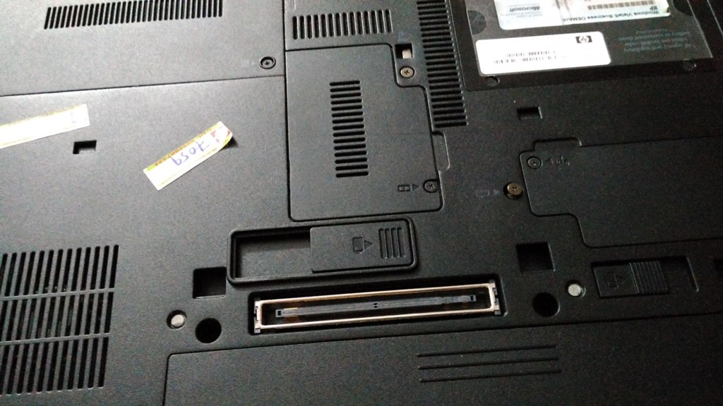

2 at either extremes of the panel covered with rubber cork. like the one below. i was too lazy to pay attention to this and ended up breaking one of the screw threads!

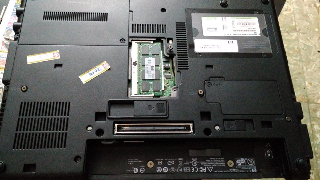

two under the battery compartment and one beside the battery compartment. super idiot that i am, i again ignored that neat little flat screw damaging one more thread.

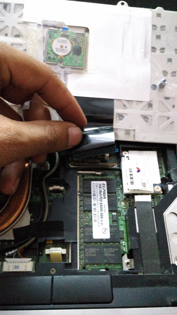

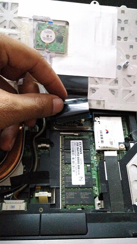

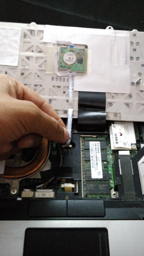

once you are done removing/loosening these screws, you would have to remove the keyboard gently. sorry i do not have the pics of the same. keyboard is held in place by few notches on the sides - you can see these if you observe carefully. you can pry it out- make sure you don’t pull it out at once because there are couple of flat cables attached to the base. below pics. both have push and lock type couplers.

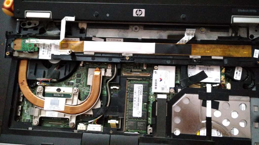

after this carefully pry out the top silver panel which houses power and other touch buttons. even this is connected with couple flat cables which is easily visible.

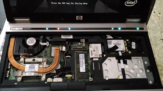

[before removing]
[after]

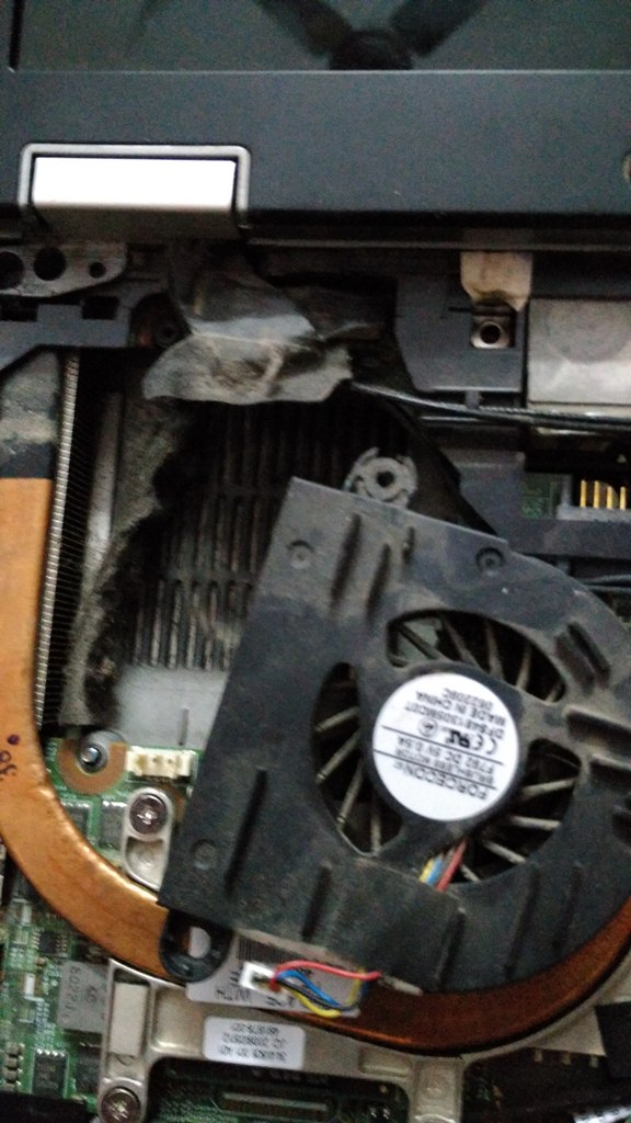

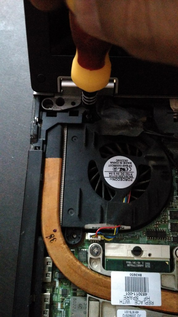

now you have access to fan!! it is held in place by a single screw. easy peasy.. just unscrew and it frees itself. make sure you carefully remove the power cables for the fan.

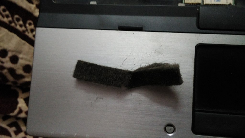

there you go!! the treasure of dust! it has formed into a nice piece of foam which was also acting as an insulator!!
closer look of the treasure find!!
clean the fan seat thoroughly and also the fan itself. after all this carefully put it back!! make sure your laptop is powering on and keyboard is working before power fitting all the screws!!
