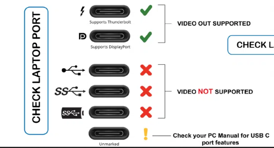

Better to buy a USB C hub and get LAN , HDMI , USB , card reader etc - but when buying laptop with USB C port always check whether it has display out or not
All USB C ports in laptops are NOT DISPLAY OUT
speed is DEFINITELY compromised lol, barely as fast as my wifi
Wait, if all ports are not display out then should one even bother to still check lol.
I have a 2 year old HP company laptop (Elitebook) and it has display out via USB C port. I connect it to a dock and I get power, display, and network from that one connection.
So it depends on the model.
Exactly i have a Acer which has no PD or Video out , have this SS marked port . Learnt all this hard way after buying when i wanted to use USB C for HDMI out
Check your port first -

I hope the info is given on the specs chart.

Video over usb c is a minefield. There is no standard. There is display port and hdmi based standards. Most generic docks will not work. Best to get a dock guaranteed by the laptop manufacturer as compatible
