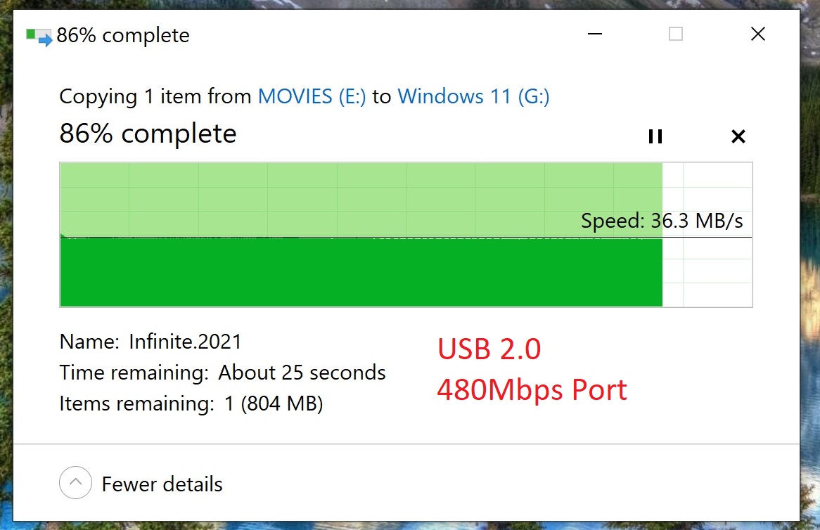

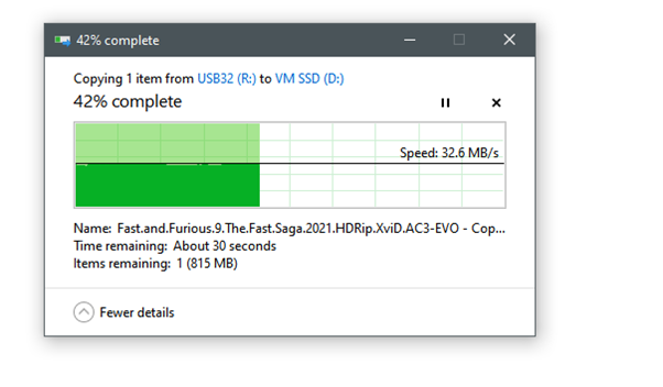

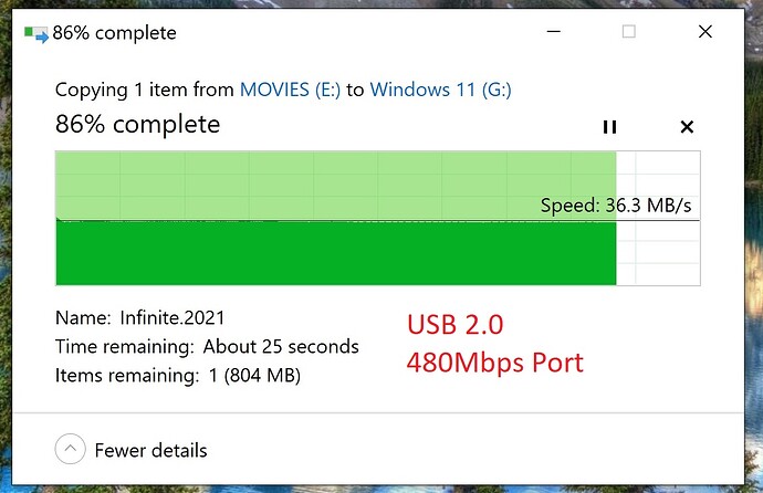

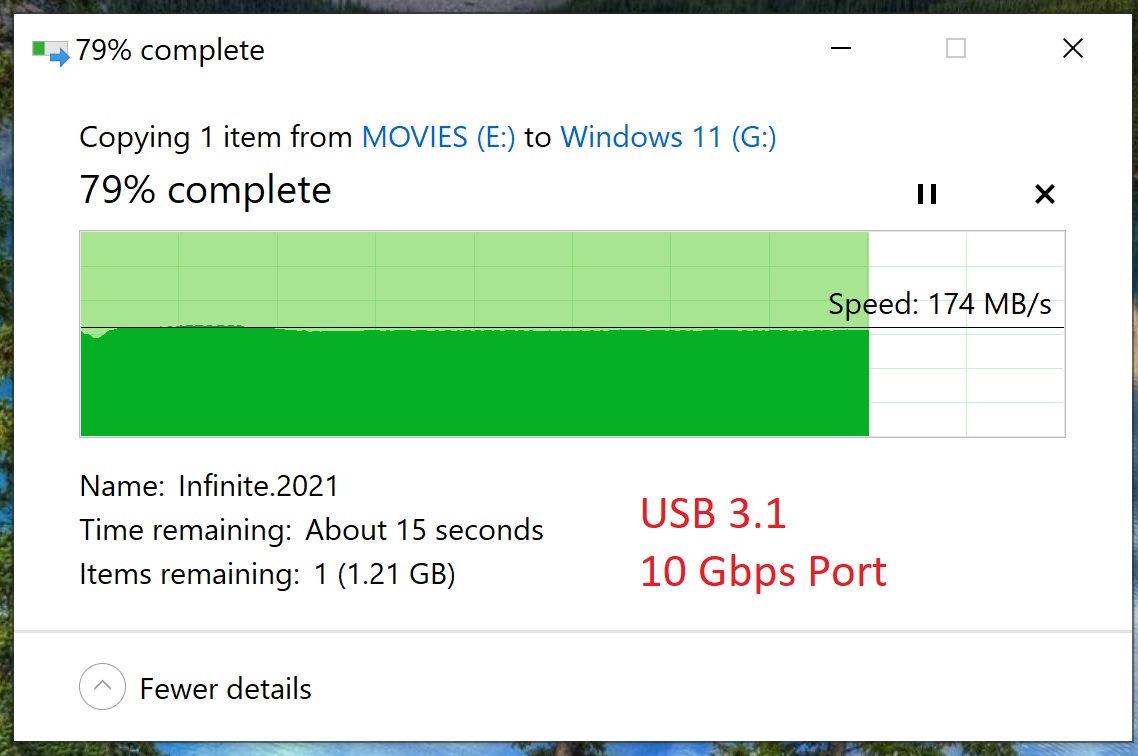

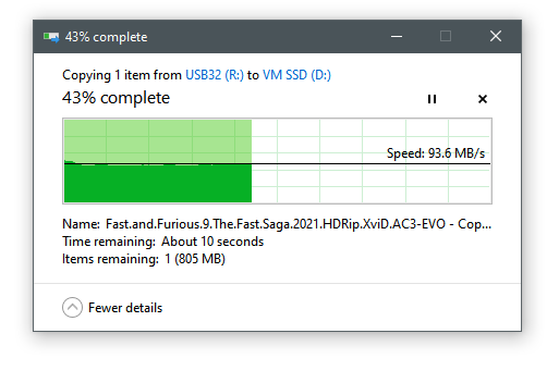

Here are speeds on my system..
USB 3.0 DRIVE ON USB 2.0 PORT
USB 3.0 DRIVE ON USB 3.0 PORT

The answer is** NO**, it will not reach 60MB/s on USB 2.0 port.
I tried copying same file on Sandisk Extreme 64GB USB 3.0 Drive from Samsung 970 Evo Plus (Absolutely no bottleneck here)
These are the write speeds on both ports.
