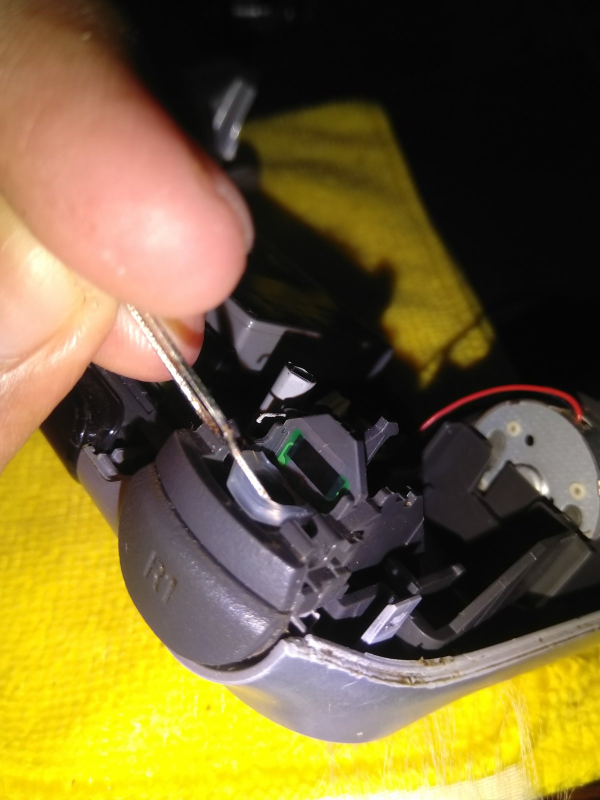

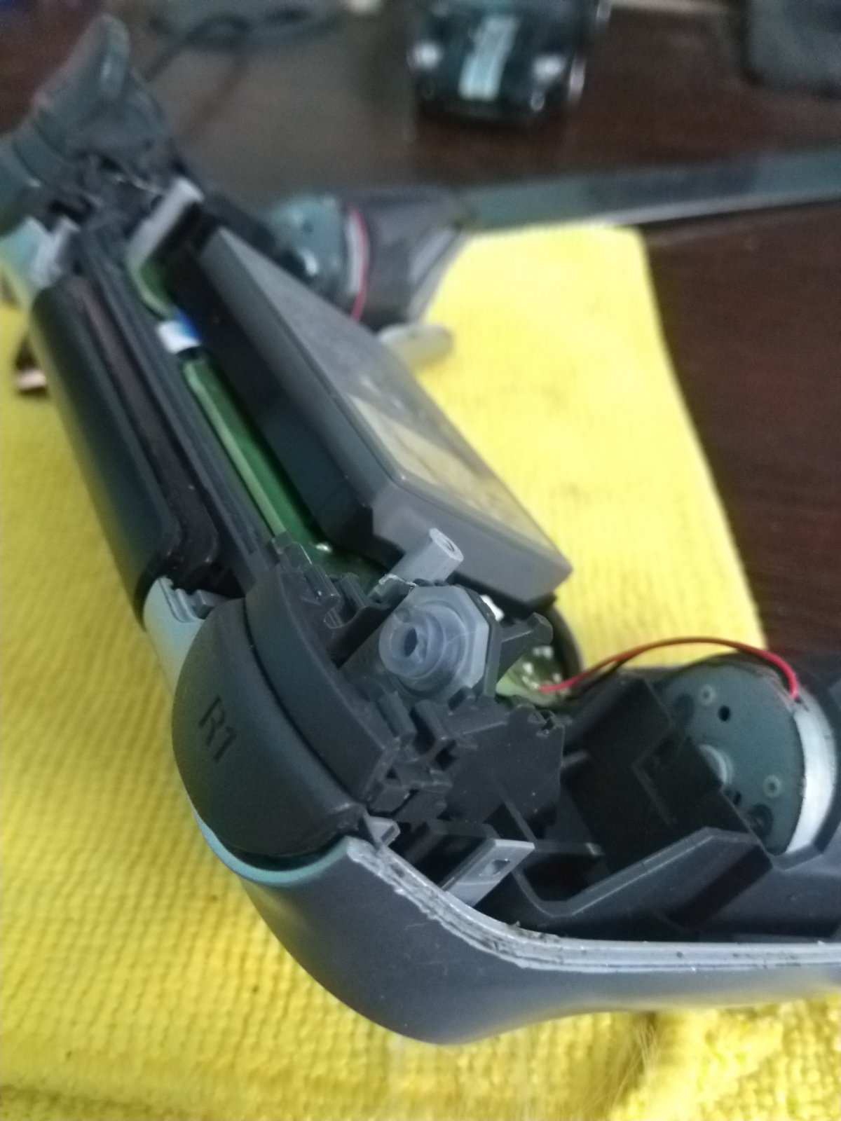

Can you share a picture of the actual rubber pad and the electronic pad. There are several internal model of the internal pads.
Most controllers can be repaired unless you actually break something [including the ribbon cable]. Ribbon cables and other pads are available but they are pricey and again vary a lot.

Images down below!

Thanks for the pictures brother. But that’s NOT what I was asking for.

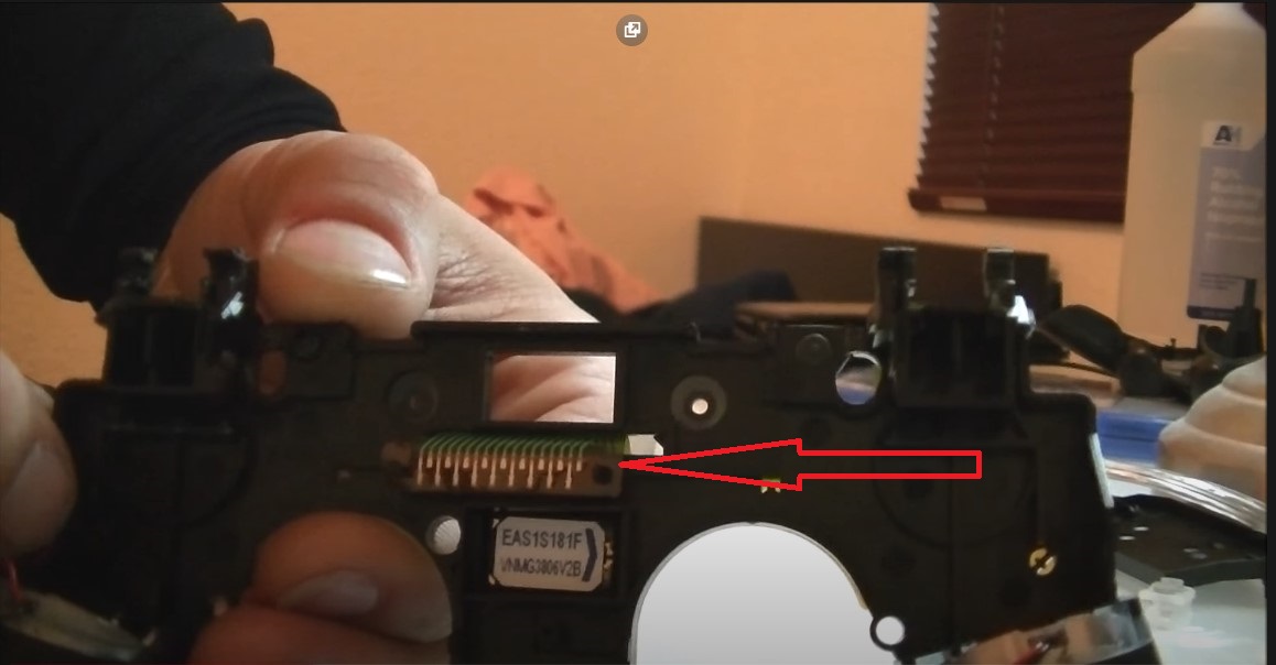

Remove the battery cover and a single screw will be holding the black plastic cover. Remove that. Then remove the blue ribbon cable gently, as it is a fragile cable [refer picture]. There will be a MODEL number written on the front face of the controller. Like JDM-050 / JDS 055 etc etc. We need that number.
***However it seems from the picture that both the pad and the film are okay. Just use IPA to clean both the surface and you should be good to go. ***

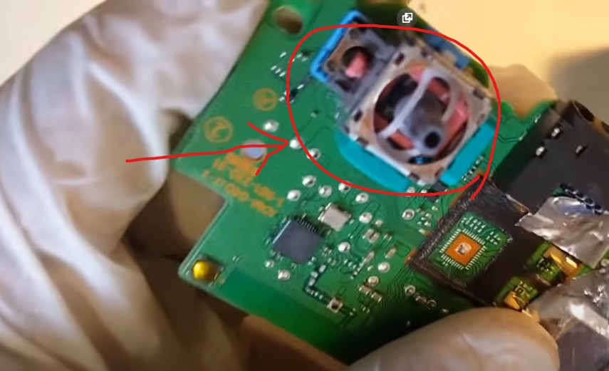

Analog sticks are soldered onto the motherboard of the controller. The conductive film has nothing to do with the sticks. If all the buttons are working properly then i doubt that the film is to blamed here. Just make sure to check that the board alignment is proper. In rare cases, the alignment is not proper and might cause issues [refer the pic attached]. Also while you are at it, give the analog stick a nice bath with IPA and cotton bud. And blow it dry like you used to for old Nintendo cartridges. Dust might have accumulated there. And let it dry completely.

From the inside. Open the controller and take out the motherboard. remove the analog cap and then clean the actual analog stick. You can pour a small quantity of IPA inside that stick.
Right that’s what I meant to ask, sorry. I meant to ask if it was okay to directly pour IPA on the potentiometers

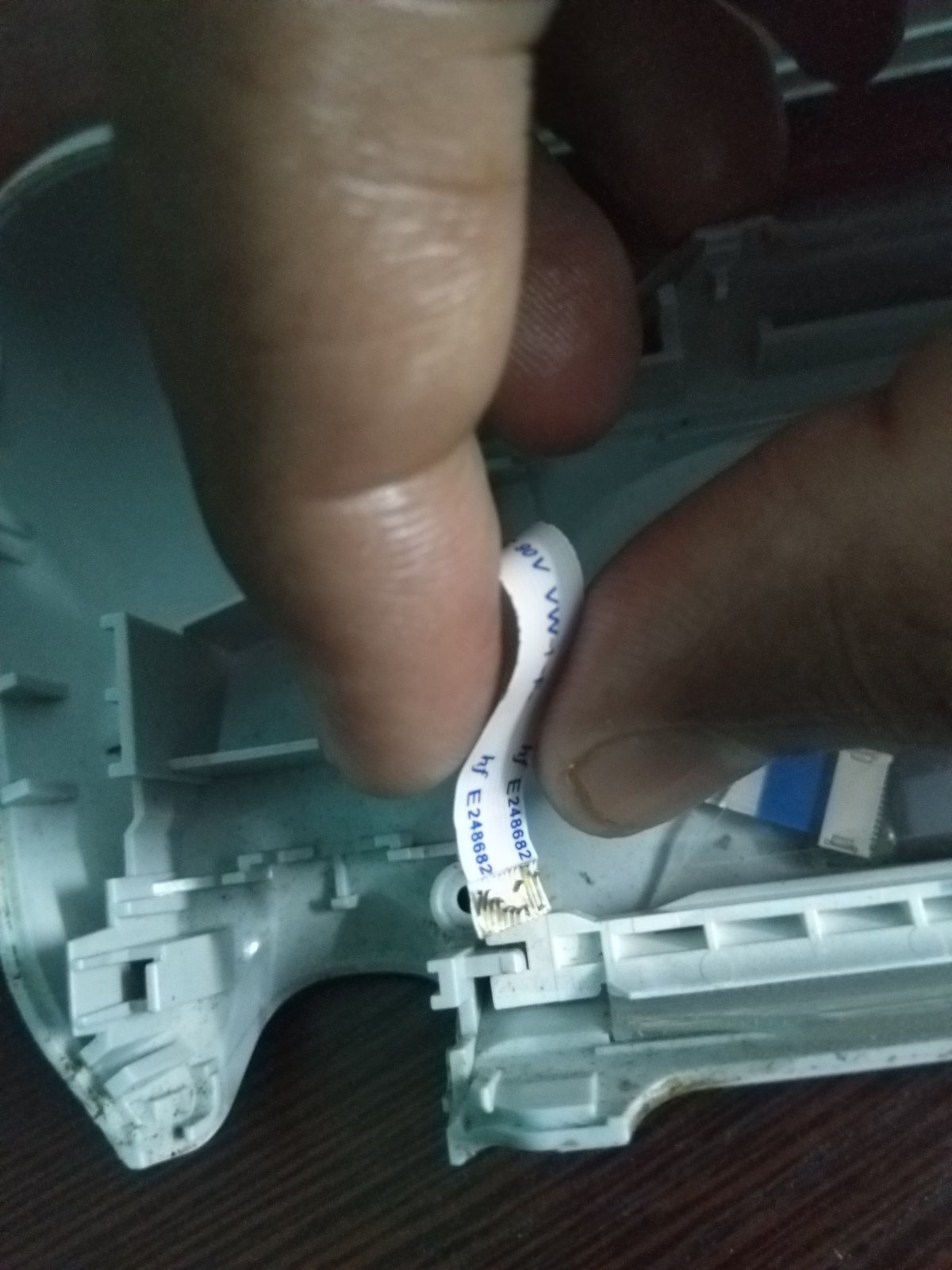

Oh no! The ribbon looks damaged.
It is. The blue plastic retainer popped off, and the cable bent while I was trying to plug it in

The power ribbon is damaged. This probably happened while opening/closing the controller and is separate to your trigger problem. Oh well, still user replaceable and fairly cheap, now you know what to do. There are a few of them on amazon. If you can count the number of pins otherwise joy will have to help you here. If your caps are damaged/worn out you can replace them too while you’re at it. It’ll basically be a new controller at this point. Beats buying a new one for 4k+. You’ll become a pro in no time. DIY is very fulfilling.

edit Oh the retainer popped off. This is beyond my scope. Feel like I jumped the gun and caused your bad luck.
edit 2 Just a thought, maybe you can superglue it but now we’ll enter jugaad territory. There should be a better way to fix this.
