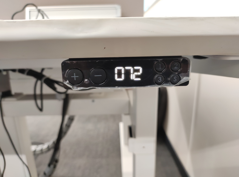

My company desk is one of these.. Height adjustable and some more keys whose functions idk nor those keys work. Cannot ascertain the brand as its corporate bulk contract thing.
The other buttons are for profiles (will get to specific heights set)
