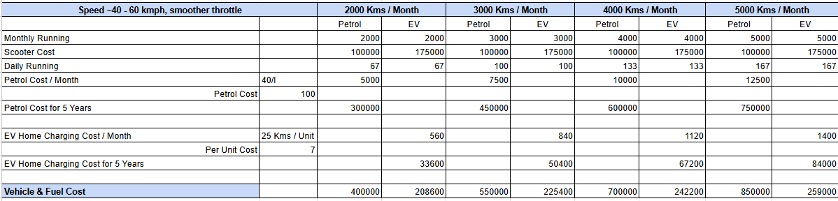

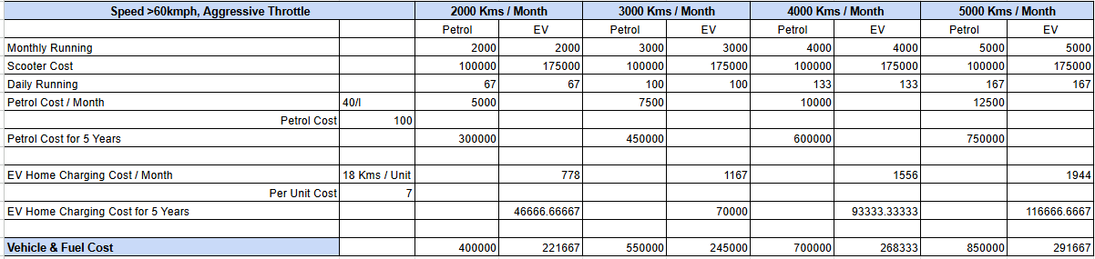

Apologies, I’m not sure how I came to that (could have miscalculated earlier). I use an EV, and my daily run is 50 km, five days a week. I made a similar calculation as attached and decided to buy an EV(Ather), considering a 5-year warranty for the battery.
There are a few things to consider along with this.
  • Service cost would be more / less the same (yes, EV service costs higher without Engine Oil), too much focus on this is bad for the brain.
  • The calculation will show that EV is better, but if the battery needs to be replaced, then it adds up a higher cost (doesn’t mean it will cost more than Petrol, but the upfront/immediate cost would be more)
  • Buying an EV with EMI will skyrocket the overall cost (I don’t recommend this), so if you’re planning to buy a Petrol scooter with a 20% downpayment (Rs.20000), then the downpayment for EV should be the same 20% at least (Rs.37500) so that the Interest rate exponential is at least comparable.
  • Riding aggressively will reduce the efficiency by 25%, hence a 10 to 15% cost will occur w.r.t charging cost.
  • Living in a hot region will affect the way an EV performs; a good EV will perform similarly at speeds <50, but might struggle when you push harder.
  • Last & most important thing to consider is the vehicle, many people go deep in these calculations and then buy an unreliable scooter, this is like saying that I’m the smartest person with the knowledge of stone age.
The rest is personal preference, would be happy to clear any doubts.
