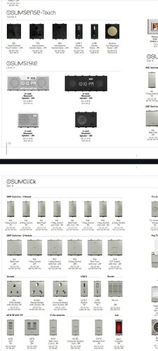

{{Regarding availability of OSUM Click (Conventional on-off switches), they have many stores in each city, but only Big shops usually, who have big turnovers and hence good service.
Btw OSUM is highly reformed series by CONA electrical brand (cheap widely available Indian brand since 30-40yrs))
Check screenshot of Osum Click: Grip Switch series, as it has USB-C, USB-A, RJ45, Cat-6, etc.}}

Btw I had attached catalog screenshot of basic switches in my 1st post. I can send the hi-res catalog to you, unable to attach here due to size limitation.

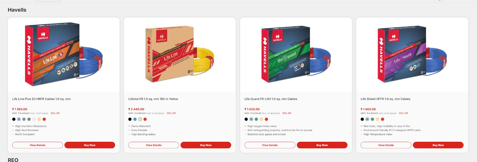

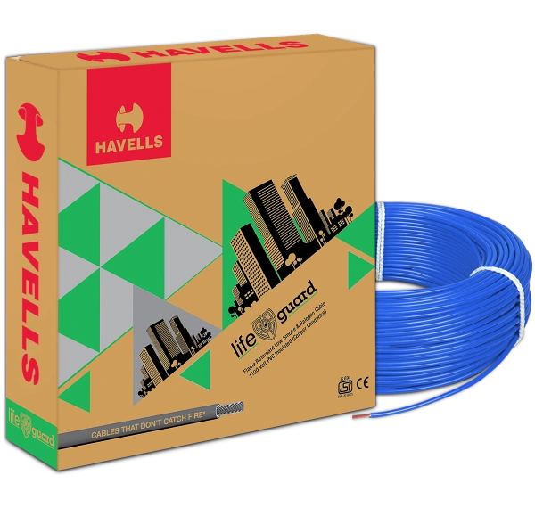

Havells Lifeshield wire melts at 280 degree Celsius.
Normally all brand wires catch fire at 70/80/90 celcius.
Only buy HFFR wires with zero smoke and Halogen properties with good oxygen index.
In switches, companies change their build quality model to model and yearly too.
Goldmedal Nixon has okish FR properties as per the price (25/pc)
https://havells.com/home-electricals/flexible-cables.html?availability_filter=5555&cable_size_filter=4374
Is the cheapest Havells **Life Line Plus S3 HRFR **still a good option?
It’s ok.. Just if you have access to HFFR, and price diff is less than 15% then go for it.
Burning point difference is huge impact. (90 Celsius for HRFR vs 280 c for HFFR)

  1. LIFESHIELD HFFR
    else
  2. Lifeguard FRLSH (same as FRLS in Havells case) (different technically incase of other brands)
