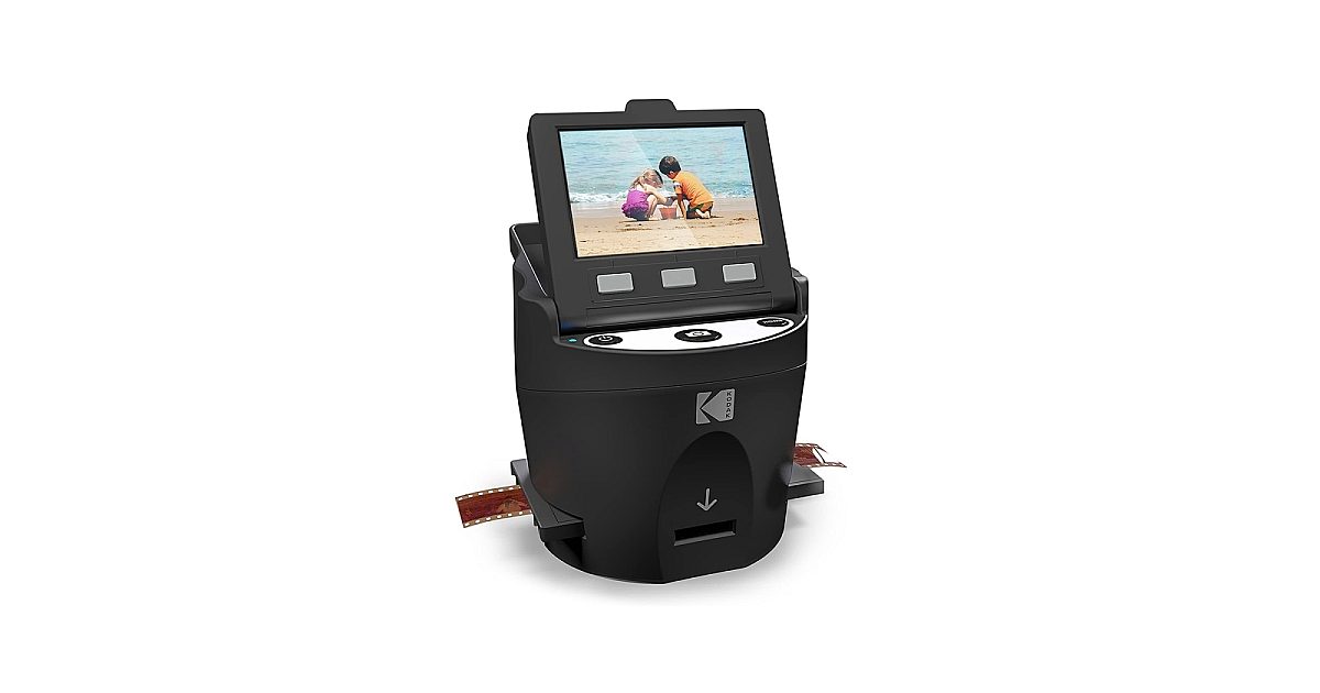

I had hundreds of physical prints of images going back 20-30 years ago and some much older, that were affected by moisture and were ruined. I still have negatives for a lot of these images and am looking for a film scanner that one of you might have had the experience of using. I found a well-reviewed one - KODAK Slide N SCAN but it costs 23k and I’m not looking to spend more than 5-6k, or maybe a bit more if it can get me quality results. I just want digital scans as of now, and printing isn’t a priority.

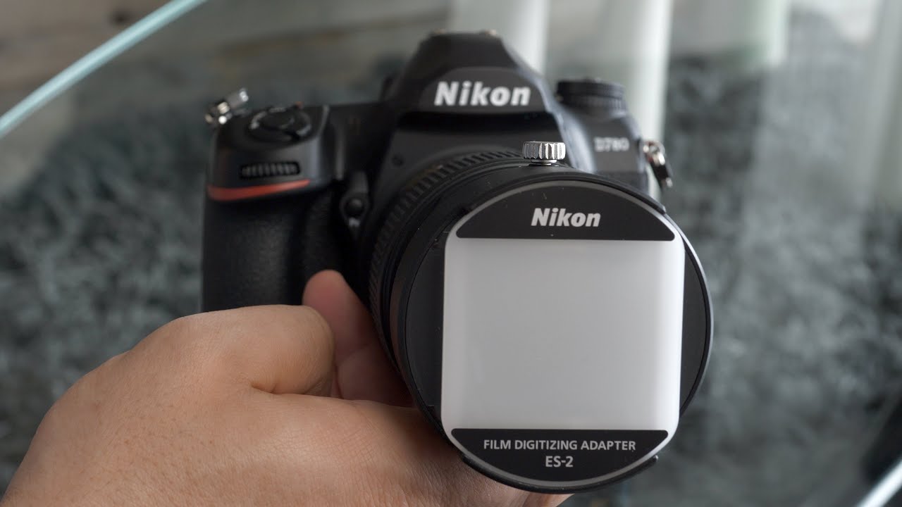

Years ago when I had Nikon camera I rented a Nikon ES2 and a 60mm f2.8 lens to try to convert a few negatives I had. But that solution would be quite expensive if you dont have the camera or a way to rent the lens.

  4. Create a DIY camera scanning setup. Will need a few things to get started but might be the most viable option. Naturally, you need to get a hold of a camera and a dedicated macro lens.

Camera scanning makes a lot of sense if you have the means to get hold of a camera, macro lens and a light source. There are plenty of tutorials in YT on how you can start. With camera scanning there are multiple methods to get the negative and camera aligned perfectly. You’ll of course have to convert them yourself but this will give you the best possible quality.

@Syzygy The Kodak scanner is actually your best bet. If you have someone coming from the US or UAE or thereabouts you can probably get one for a decent price. It works well and is fast.
All the other methods I have used have been either painfully slow, or cumbersome or both!
Even Stacksocial has discounts on several of them
The Kodak scanner is overpriced. It is a rebranded “DigitNow!” film scanner which can be had for half the price of Kodak’s (still not available in India tho).
It’s a convenient option for casual stuff. I personally would not opt for them if I want to preserve old images for long term.
