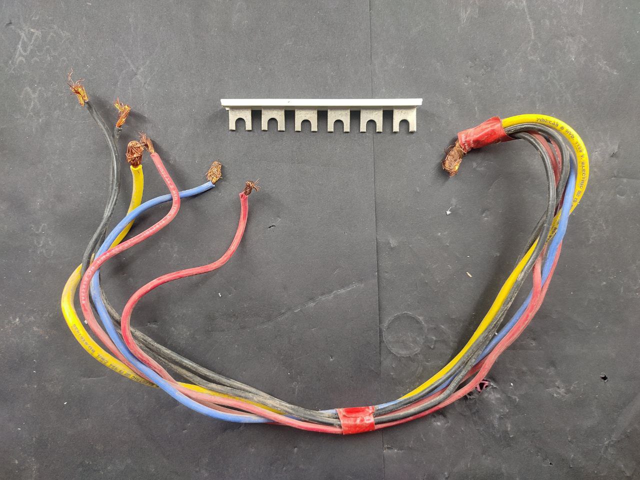

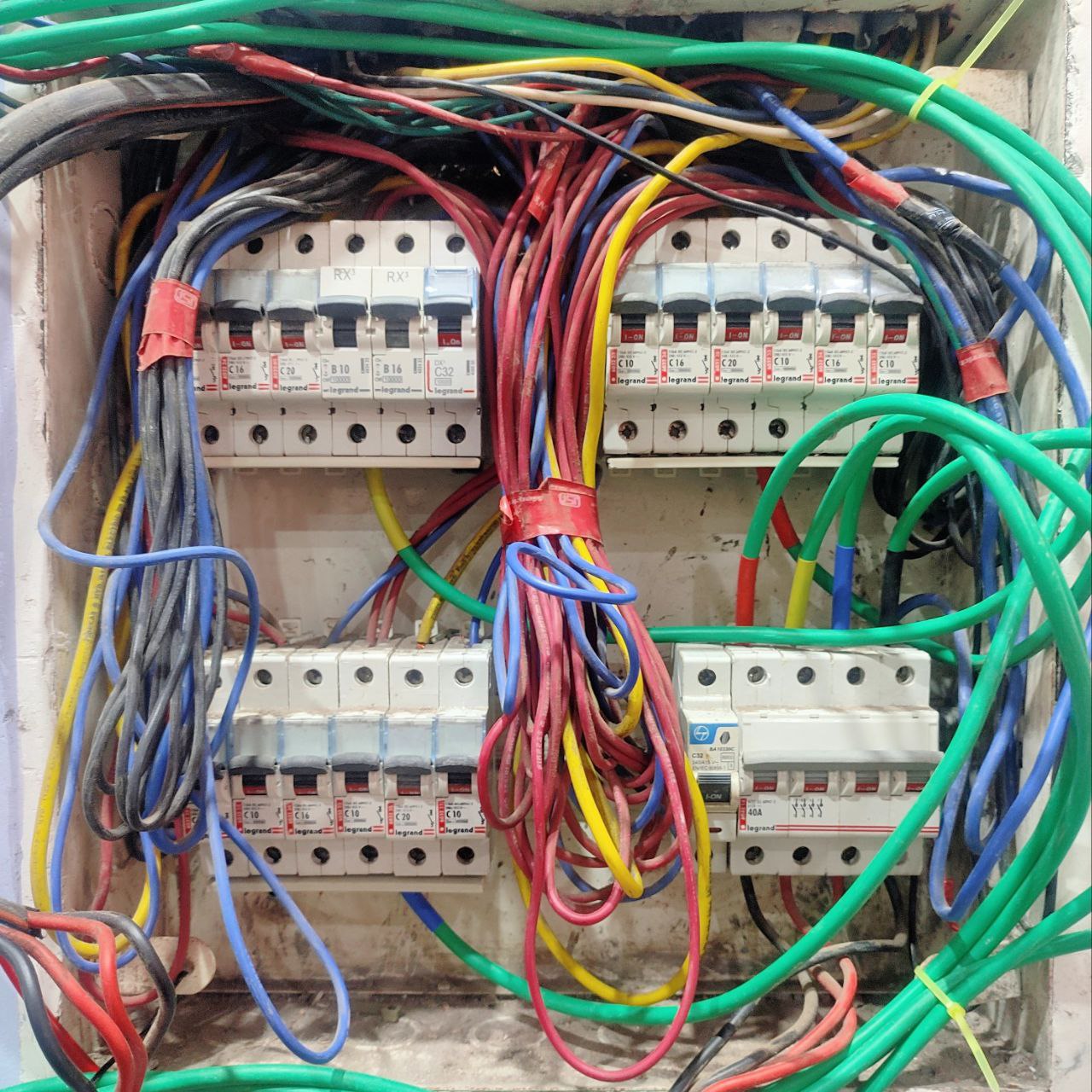

This was messed up, about half the crimped connections in the phase selector box came out during the install:
Really scary, I didn’t realize until I had wired up the mains ac connections!

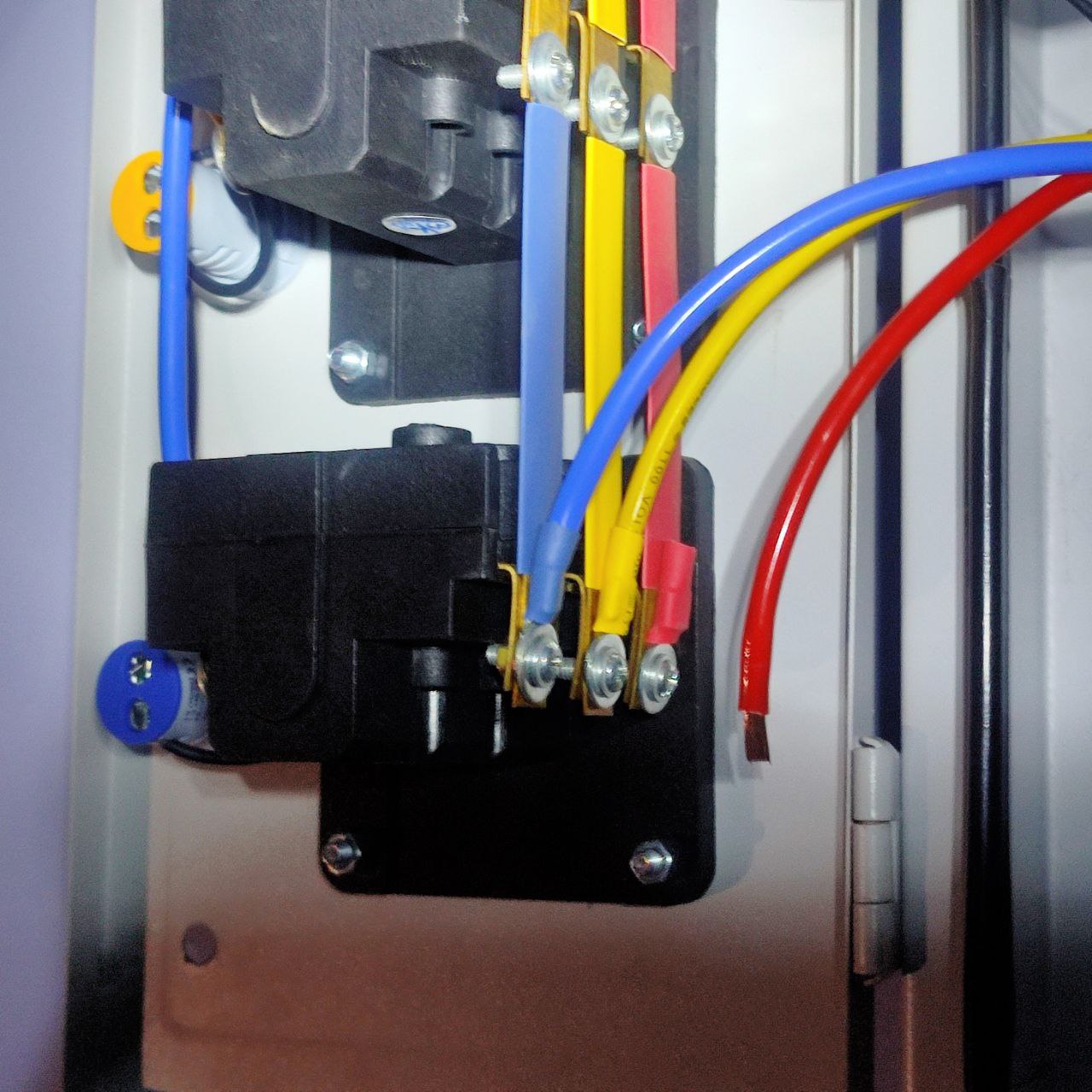

Also used MCB bus bars (tinned copper ones) to clean up the wiring a little bit:
I promise this is an improvement, even if it doesn’t look like it:

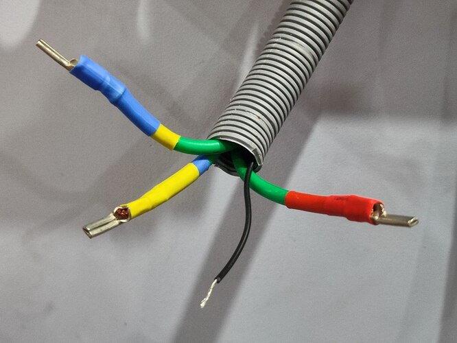

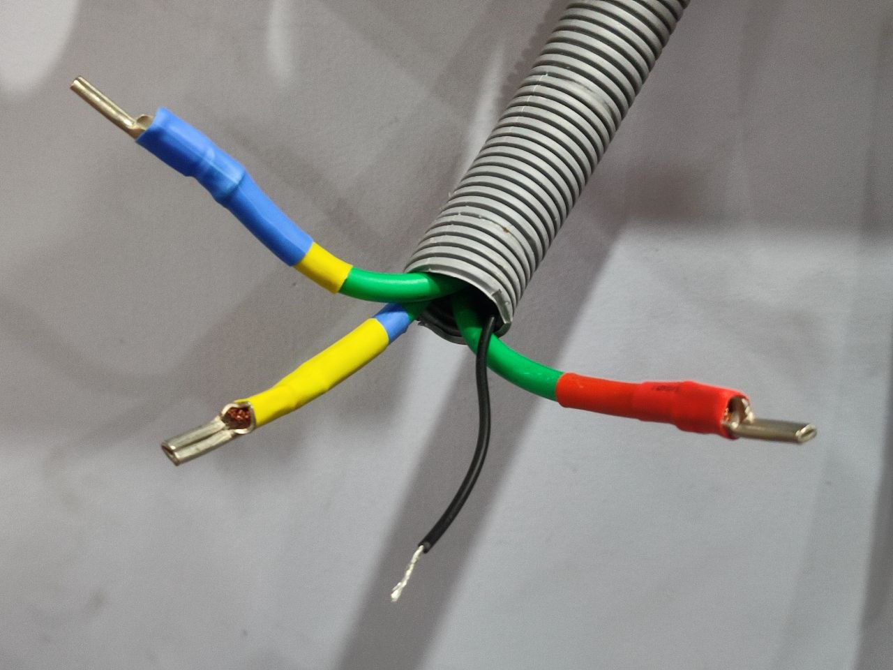

I have to say, I agree with @yugaaa, copper lugs are the superior way to wire up connections, I need to get a lifetime supply of them:
It makes things so much easier, no more fiddling with ferrules that crack when tightened or stray strands of wire!
