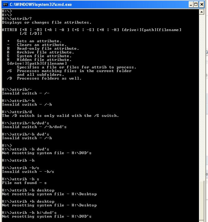

i tried it but its giving message “NOT RESETTING SYSTEM FILE” ..(Refer attached file …)
now what to do??
now what to do??
Are you logged in as an Admin? (Thats XP?)
#mehrotra.akash , yes dear..as admin,and its xp ..
try this : attrib -r -s -h /d /s
#[member=‘CA50’] . Thanks a lot.. it worked…
