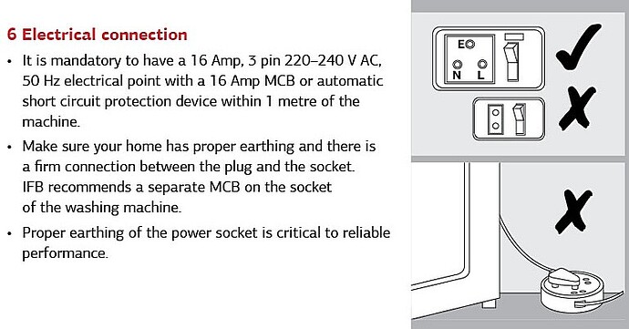

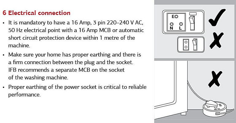

Aren’t there any 16A power sockets in your apartment?
A max of 1,500W is for 6A plug outlets. You can’t plug in a washing machine with a heater into those outlets.
My LG’s heater as well as geysers need 2kW. That is around 8A. Nowhere near 16A but are connected to a 16A socket.

I have installed two of them, one for the rod, other for the washing machine. The electric rod is in kitchen and I have extended the 16A socket from the kitchen mainboard. Earlier, it did trip my meter after using for two days. The electrician said that it is mostly due to rod as it consumes high wattage. He replaced my old fuse near the meter with a new one and it has been working fine for now.
The wires are small in thickness hence the 1500W. He told me that if your rod is working fine then so should your machine. Just don’t run both the machine and the rod together as both are getting the connection from the kitchen board.
The electrician has extended a wire from a kitchen socket to washing machine 16A socket. What is the average wattage for a 7kg machine?

This ‘small in thickness’ bit is the concerning part. Can those wires handle 16A or not? You cannot add a 16A outlet to a wire designed for 6A !!!
Pull out a 6A outlet and check the thickness of its wires. Are they the same thickness as the ones you connected to your 16A?

That means it’s a 6A socket. You can’t run a washing machine with a heater on it.
Not possible.

You can’t get any machine until you resolve your electrical issues.

All FLs are going have same peak power consumption of 2 to 2.1k watts. If you buy TL with heater then it’ll also have same peak power consumption. I think this limit is governed by some ISO standard. Anyway this peak power consumption lasts only for a few minutes. Rest of the time, the power consumption goes down to 50 to 150 watts.
If your 6A circuit is done with 1.5 mm sq copper cable, which is a general standard, it can handle 2.1k watt load. Would I suggest it? No, because this is public forum. Would I do it myself, if there was no other way? yes, with my eyes closed. I would change the 6A socket to 16A though.
You can run FLs without heater too. The peak power consumption won’t go above 200 or 300 watts.

What I think he has done is extended wire from a 6A socket and put a 16A outlet on it. Sounds so dodgy.

Honestly, both seems same to me. The image below is the leftover of the wire used to connect the 16A plug.

Gauge of the wire is written on the wire itself. Usually, 1.5 mmsq gauge wire is laid for upto 10A circuitry. Next is 2.5 mmsq. And it’s used for 16A circuitry. After that, 4 mmsq is used for geysers and 2 ton + ACs. Most of the electricians are uneducated folks. So everything in electricals is build with an overkill mindset. Most of the appliances that come with 16A plug can run fine on 1.5 mmsq. too. Having said that, if your building is old then I don’t think it will have 1.5 mmsq wire for 6A circuit. I don’t think you have concealed electricals considering the age of building. If that’s the case then why don’t you lay pair of 2.5 mmsq wires from the DP to the washing machine? It’s totally doable and it’s easy job for an electrician. It might destroy some wall paint around the pattis though.
If he’s taking 16A switchboard extension from behind the 6A switchboard, meaning direct wire patching then it’s workable solution (considering wires can handle it). But if he’s making a plain 16A extension board which you then plug into 6A socket using 6A plug then it’s a no-no from me. 6A sockets are bad at handling load. 3 decade old socket will be much worse. Just make sure you aren’t directly involving 6A socket.

You just uploaded these photos. This is what I was saying, as taking wires from behind the 6A switch board. This will work for the time being. I think that thick black cable is 3 core 2.5 mmsq. Gauge should be written on it. Just don’t run multiple heavy things at the same time. There’s a way to identify if you are running thinner gauge cables for the loads. If the tube lights in your house dim slightly when you run the water heater rod then yeah the wires are thin. Usually, that’s the worst that can happen. Houses don’t burn down.

Take note
Have found IFB’s manuals to be the best in the industry. User friendly and informative :slight_smile:
Good, this is the proper thing to do. Make sure he tests the earthing. While he’s at it, get him to check all the plug points in the house for proper earthing and polarity
