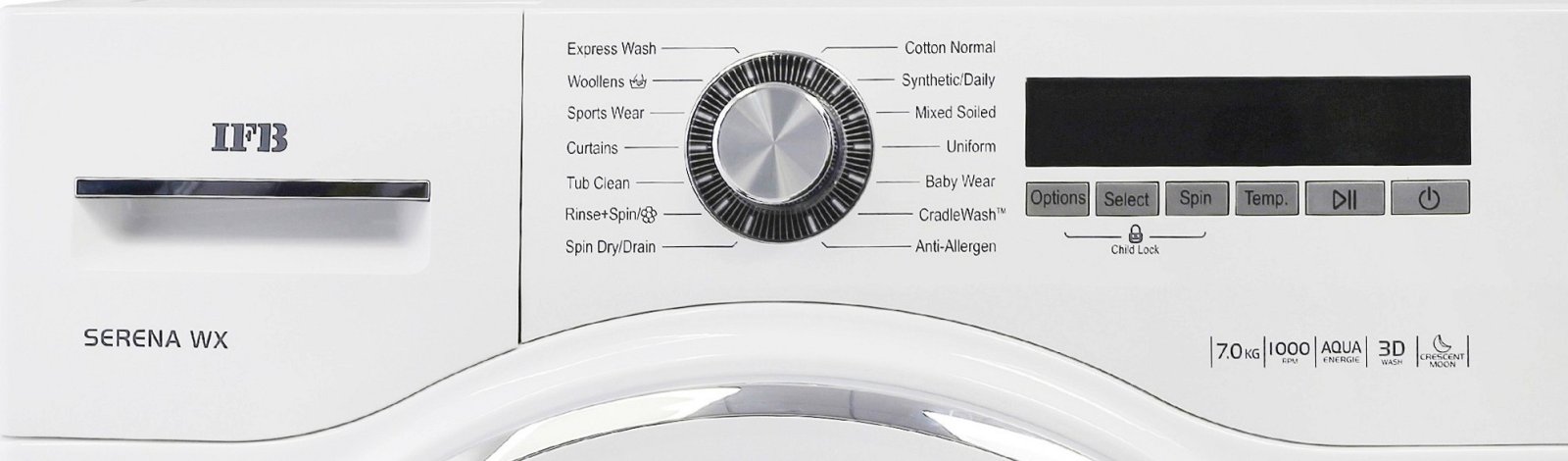

https://www.flipkart.com/ifb-7-kg-5-star-fully-automatic-front-load-in-built-heater-white/p/itmezw2masejjqhr
Original IFB web [listing](’
Serena WX 7 kg 1000 RPM
) from Archive

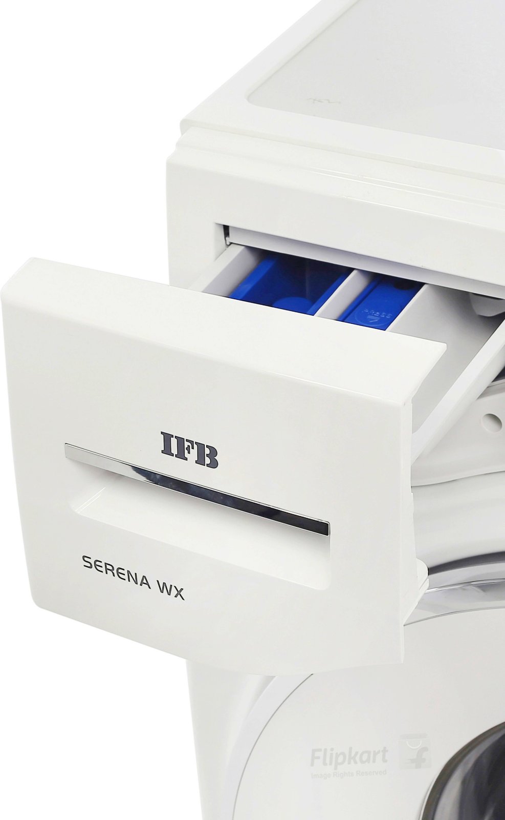

That is one potential candidate. It’s an old model, the FK reviews are from 2018. I’ll post more later. Don’t pull the trigger just yet.
The water pressure is the same as mine at 0.3 bar which confirms those 3d jets are not fed by tubes and don’t require 1 bar pressure like present day LG’s
It displays the max weight for each program which is a handy reminder.
Spin speed selection is similar to mine, 400 in low humidity weather, 600, which I don’t have, 800 in high humidity weather and 1000 which I never use as it just puts wear & tear on the bearings.
Tub clean works at 95 degrees, Awesome :grinning_face_with_smiling_eyes:
There is no favourite program option so you have will have to set things for each wash but I don’t have that on mine and manage just fine. It makes me think about each wash and how options can change based on soil level or the humidity that day.
I like that it has the RInse hold feature that is all but gone on current LG models. It has an extra rinse option so you CAN have a third rinse if you want.
It has the option for a hot rinse which could come in handy in some situations. This is similar to the Medic Rinse on the LG which is really a third warm rinse. Why use it? faster drying in high humidity. Cotton extracts the most water from the fabric when the rinse water temperature is around the 40 degree mark.
