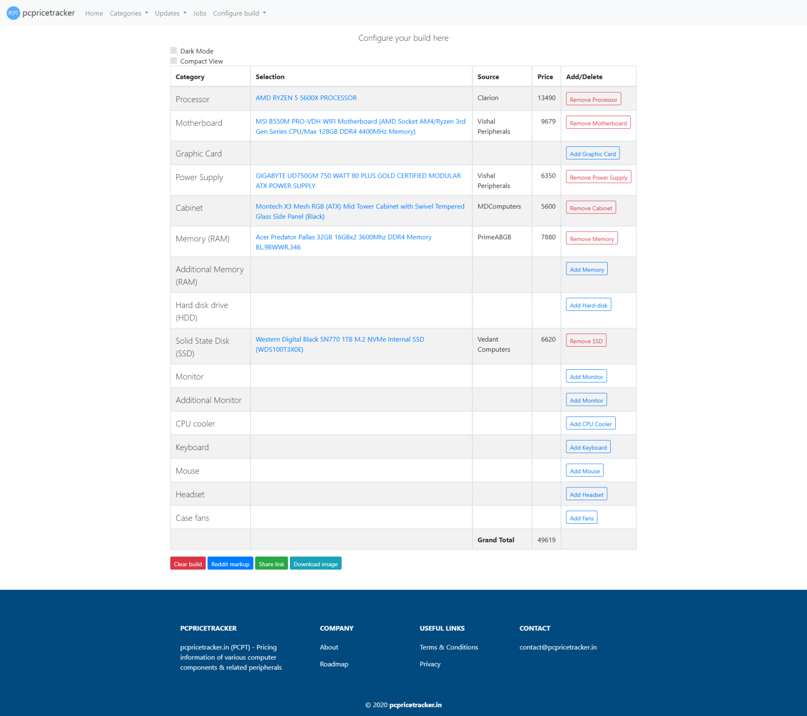

Hey people, I am considering building a gaming PC which can potentially be my work PC as well but I need some advice from y’all to make sure I’m going ahead with the best possible build for me. The budget is roughly 80-85k and this does not include the peripherals. I’d like a used GPU if possible. I want the system to last around 2 years and don’t care about longetivity that much.
Before I list the components, I gotta mention that I have a 4k monitor [(this one)](’
https://www.amazon.in/LG-4K-UHD-Monitor-Display-Freesync/dp/B07PGL2WVS?th=1
) so ideally I want a build which can run native 4k games at 60 frames or upscaled 4k. 1440p is fine for me as well but I’m concerned about the way upscaling will be handled when playing at 1440p on a 4k monitor (DLSS would help me a lot here but NVIDIA doesn’t like giving enough VRAM apparently so screw them).
FYI I already have an xbox series X so I want better performance than that from the PC. This was all in regards to gaming.
For my work use, I already have an M1 macbook air for programming/work and its working just fine for me so I’m not really sure if I’ll use the new build for working as well. I guess that depends on how much better it’ll be compared to the M1 macbook air (the 8 gigs of ram is really showing its age). I might dual boot linux with windows if possible and if its fairly fast to switch between them. Any opinions regarding this?
Now, onto the components I’ve chosen:
Here’s a build list with a GPU (new) added for reference: [pcpartpicker.in](’
https://pcpricetracker.in/b/s/3f8aa425-468b-4498-aad6-9544e3eaf0a6

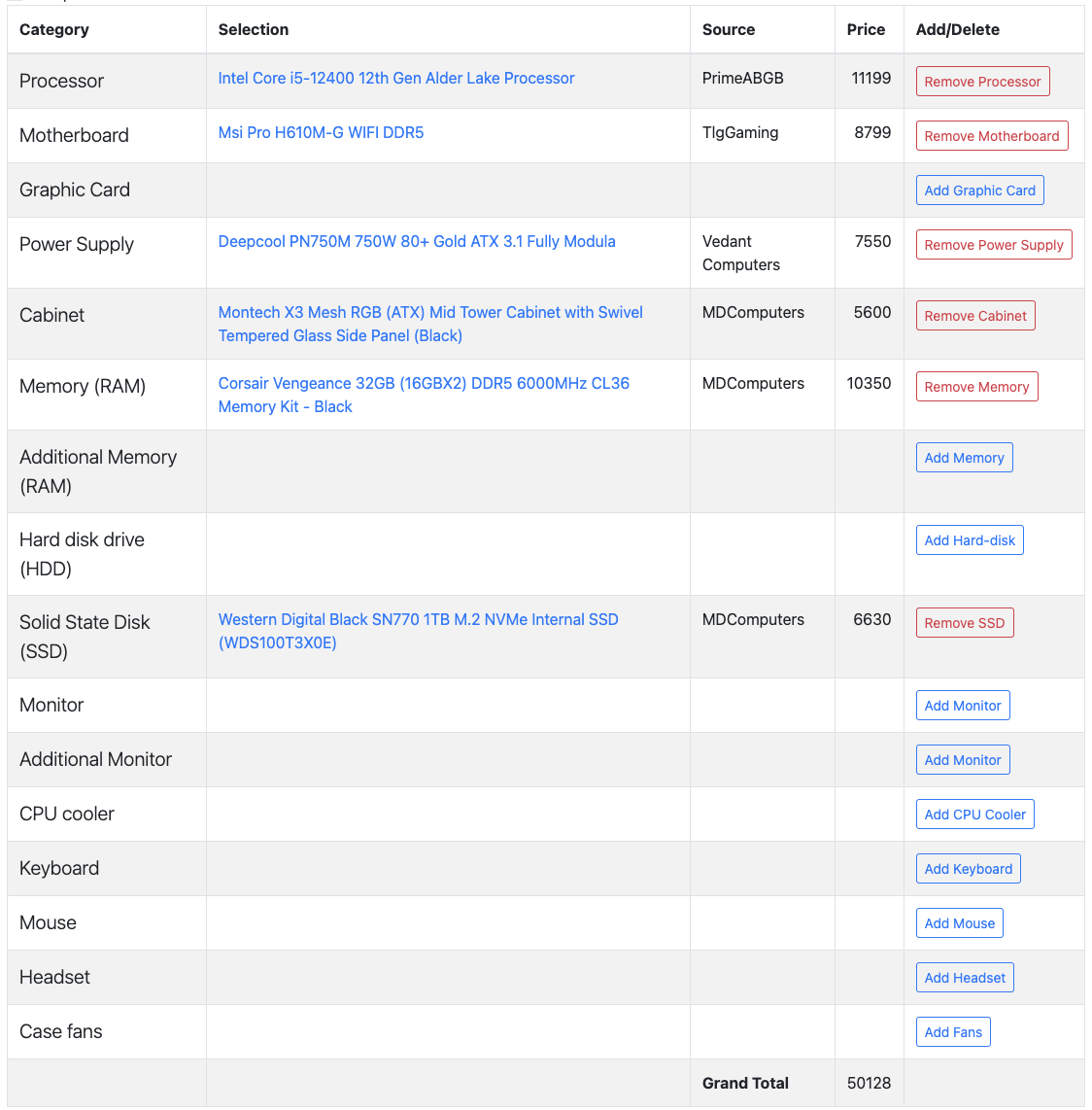

Here’s the screenshot for all the components I’ve chosen along with the GPUs (used) I think will suit me:
Do recommend any changes even if minor to the case, motherboard, CPU etc. if its worth it.

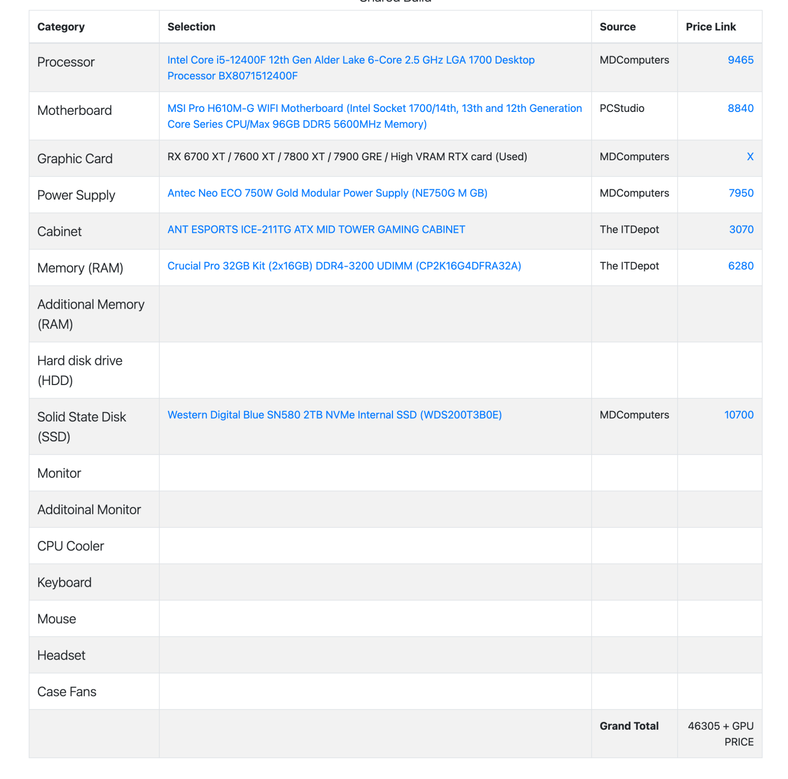

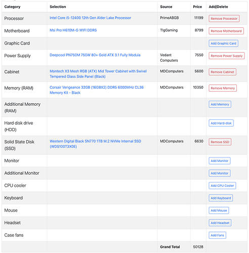

I researched a bit more and have decided to go for i5-12400 with the iGPU along with a used RX 6800 XT or 6700 XT. Also changed most of the small components. [The new build is here.](’
https://pcpricetracker.in/b/s/062010e2-0c45-4acd-ab40-2a739bbebb2d
Total is roughly 42,000 excluding the GPU so the final price with the used GPUs will probably be around 62,000-72,000.
The RAM in your updated build is pretty slow, it’s CL22. Try getting a CL16 for DDR4, like this one
https://mdcomputers.in/corsair-vengeance-lpx-16gb-ddr4-3200mhz-cmk16gx4m1e3200c16.html
The crucial P3 is also a bit of a middling SSD, afaik. Might be better to go for a better one.
You selected a DDR5 mobo initially with DDR4 RAM. 2x 16GB DDR5 6000MHz CL30 costs around 10k for reference.
IMO get i5 12400 for 12k instead because you can assemble your PC & start using it while you search for a used GPU. Also iGPU is handy in case dGPU has any issue. Get a better PSU, tier A ones, like MSI A750GL.
If you want to save money with used 6700XT/6750XT around 20k, then can settle for i5 + DDR4 RAM (3200MHz CL16 at least). If you plan to get say used 3080/6800XT, then maybe consider DDR5 RAM with DDR5 mobo for extra headroom. For 1440p gaming, i5 12400 + 3080 shouldn’t have much bottleneck.
I own i5 12400 + 3070 rig & recently bought a 4K 120Hz TV. I can feel the pain regarding low VRAM. In games like FH5, my 3070 is powerful enough to push 4K ultra natively but I have to keep textures at high instead because of VRAM. Definitely avoid all 8GB VRAM GPUs, situation will get worse for 8GB VRAM GPUs considering PS5 kind of has 10GB VRAM & games will be optimised for that.
Regd. monitor - I feel its response time will kind of ruin your gaming experience. I use gaming monitors & play games at 70-75fps mostly. So I thought a 75Hz monitor would be fine for gaming as well, but I was wrong, the lack of VRR & high response times were noticeable. I recommend buying Acer XV272U V3 in future for a better experience.
If you are going to go for DDR4 ram I suggest using a 5600x as it offers better performance in comparison with 12400 on ddr4 ram and sometimes even on ddr5 ram. The case that you use in your build has bad build quality and also pretty much no airflow, so I suggest using the one above. Using two different ram sticks together which are not in a kit can lead to problems at times that is why I suggest using the kit that I have mentioned able as it is faster and also has much lower latency. The P3 ssd has terrible durability only 220 tbw which is only a third of the sn770 which doesn’t cost that much more. Also you don’t need a atx 3.1 psu so its better to save money there, but if you want an atx3.1 psu I suggest going with an 850 watt one as when you upgrade onto a next gen gpu you will have the power headroom. For the gpu I suggest going with the 6800xt, you can get a used one for around 34k. I also suggest that you consider selling your 4K monitor for a 1440p one as the 6800xt can easily handle native 1440p plus 1440p with fsr looks better and sharper than 1080p and very close to native 1440p as performs (fps) just like 1080p.

Thank you everyone for your help, [here’s my latest build excluding the GPU.](’
https://pcpricetracker.in/b/s/8d8f6aa6-5f23-4ccb-8dce-effa1c4aee7e
If you are going to go with intel I suggest upgrading the motherboard to one which can handle higher power loads on the vrm something like a b660 or a b760. It will cost more but will also offer peace of mind as you wont throttle your performance due to the motherboard power limit and you will also get many more features.
Also go with this ram instead it has lower latency and the same speed also it costs the same:
https://mdcomputers.in/gskill-ripjaws-s5-ddr5-32gb-6000mhz-f5-6000j3040f16gx2-rs5k.html

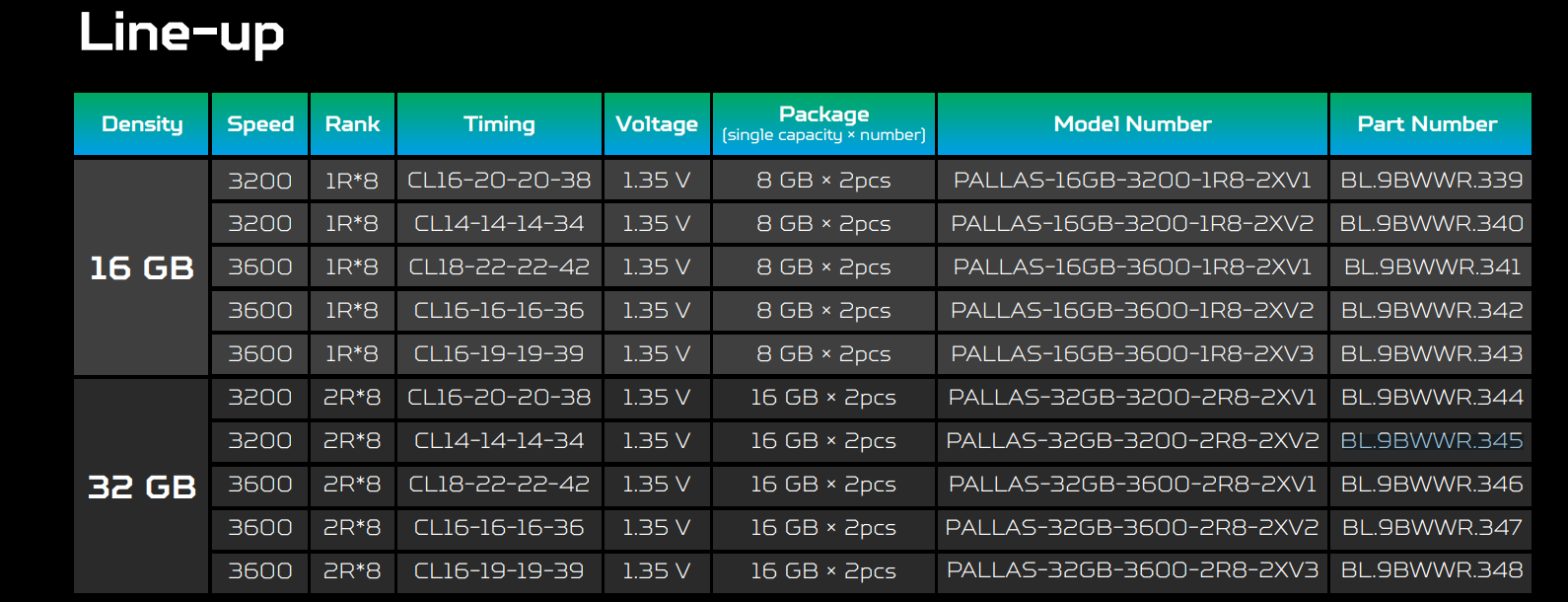

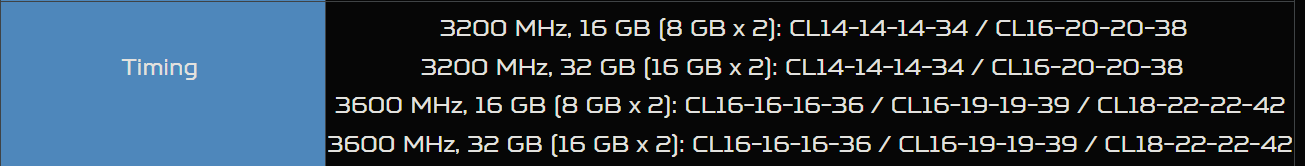

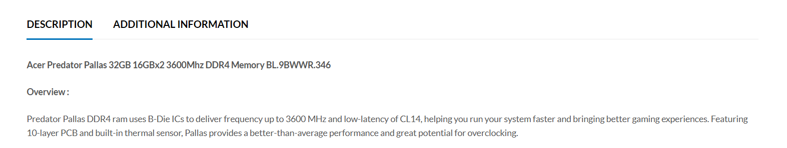

Sorry where do you see CL14 for this? I think this is the same SKU as the one you have in the screenshot
That’s CL18 3600MT/s, which is slightly higher MT/s but same CAS ms latency as CL16 3200MT/s.
They have provide wrong info on their site. There is a similar model which does provide C14 with 3200mhz but I guess this one only has C18.

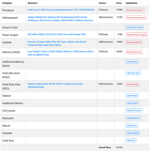

Hey everyone, thank you for all the help! I think I’ve made the best possible build I could with a decent budget (and without the GPU for now). Here’s the [link to the (final) build](’
https://pcpricetracker.in/b/s/b6872442-dd29-4e8d-b19c-1a8bb809e5b3
I don’t think I’ll be modifying this build now unless there’s a compatibility issue or a much better alternative component. I’d appreciate it if you guys could give your final thoughts on this build. Cheers!
Some notes:
I’ll use the Ryzen 7600 with the stock cooler for now.
The RAM is CL30. This is the best one I could find for the price.
Also, is it fine ordering the parts from PCStudio and MDComputers separately or should I buy from a single store?
You should go for this ram:
https://mdcomputers.in/g-skill-flare-x5-32gb-ddr5-6000mhz-f5-6000j3038f16gx2-fx5.html
It has same latency and price but it’s from g.skill so it is more reliable.
And yes you can buy from seperate stores, the only drawback might be different shipping times but then again a same store can also ship components in different batches
This was the RAM I originally went for but I saw some bad reviews about it on reddit like the comments under [this post](’
https://www.reddit.com/r/buildapc/comments/11m8zds/is_the_gskill_x5_flare_any_good_microcenter_free/
Though its possible that most of these issues are related to the motherboard instead of the RAM. Guess I’ll just toss a coin to pick the RAM lol.
