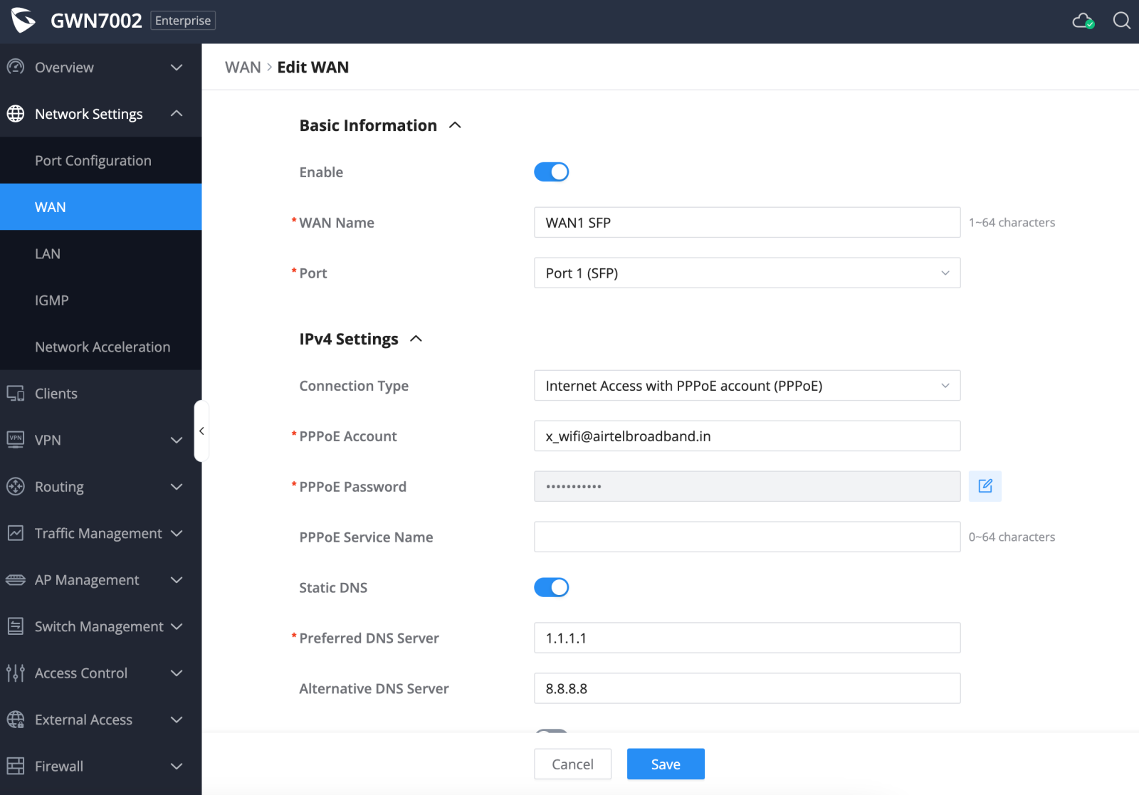

really? my main reason was to get gwn7002 to get sfp module for both main and failover isp however as i am still using my PTP device, i haven’t got the chance. have you tried with a media converter before? sfp port is stupid if it will not work. i checked my WAN settings and it has PPPoe dial so it should work.

This is actually confusing but PPPoE and SFP port are not everything that you need to run stick. Please refer to this
got it but what is the point of having sfp port if they don’t have their own sfp modules? technically it should support any gpon sfp.
This is what I thought of, and I took the lead and contacted Grandstream. According to their technical person, it should work since it is a standard xPON stick; however, he said he is confirming with his main team. He also emailed them; the reply he received was negative, as seen in the snapshot I posted in my earlier response.

Ok so i tested it today. and Guess what?
IT WORKS.
atleast for me with Nokia G-010S-A using Airtel connection. However, i don’t see ipv6 working even after it is enabled.
