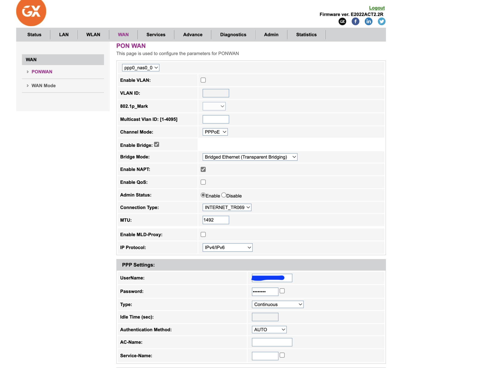

Here are the steps to setup proper Bridge Mode between Genexis Modem and TP-Link or any Router.
At the end of this setup, Genexis Modem will act as Fiber network decoder and acts like bridge to TP-Link router. TP-Link router will connect to your ISP and any other stuff you expect from router.
Connect Genexis Modem and TP-Link router using ethernet cable.
Open Genexis Modem admin page (typically 192.168.0.1 or you can find from your wifi settings). The password is generic based on your ISP
Open Admin page and go to wan settings and typically you will find the following configuration

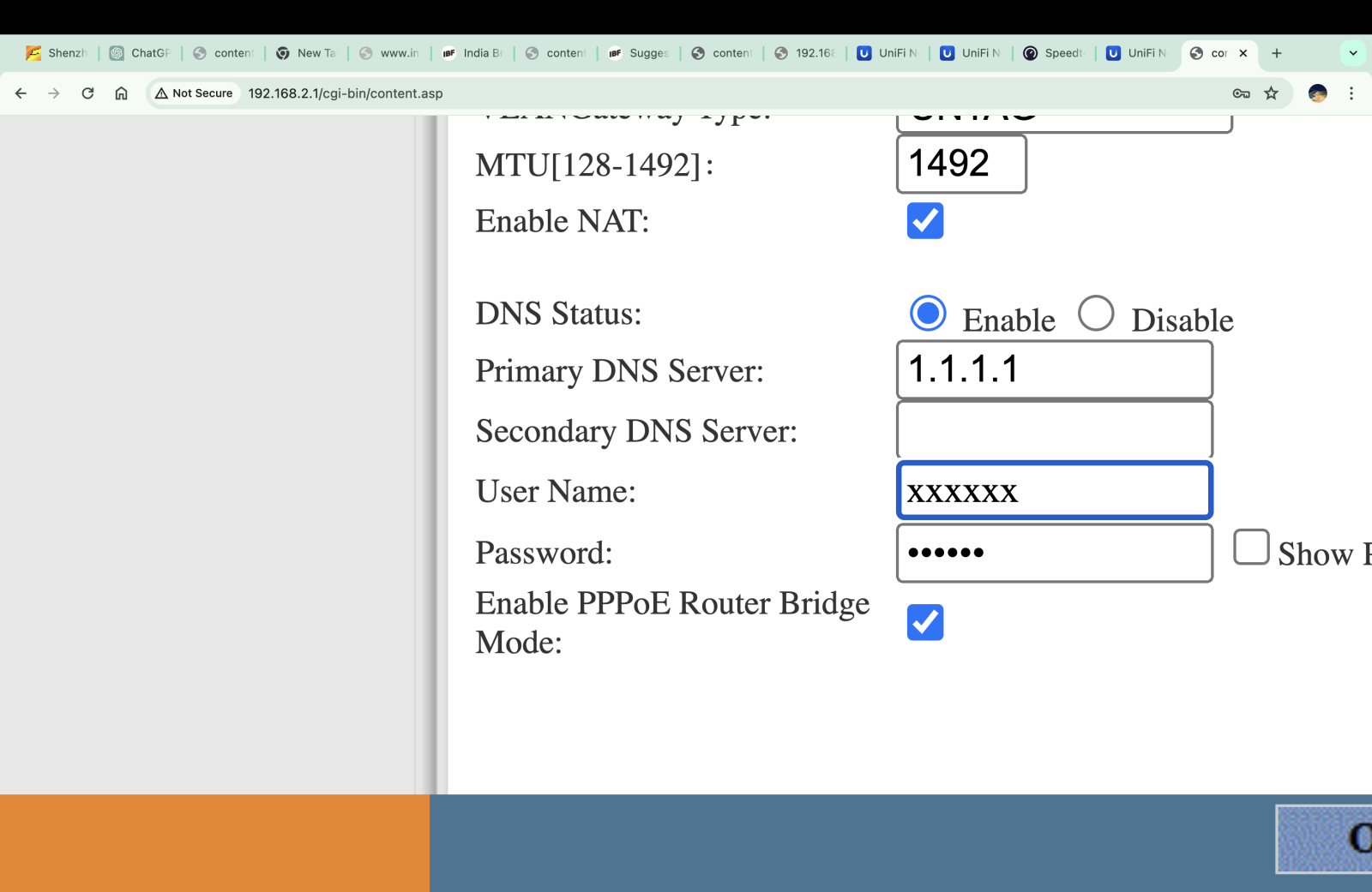

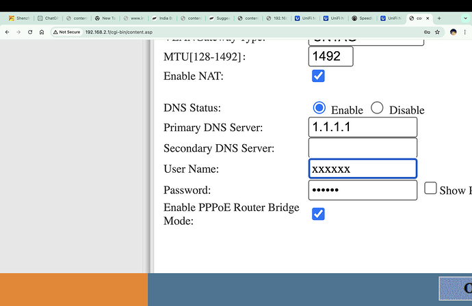

i have the same router as yours and I was able to bridge it , although no 3rd party onu works with excitel [ although they just use mac cloning]
I get ip on my router but it drops the connection after every 2 minutes , too weird.
use this enable pppoe router bridge mode
