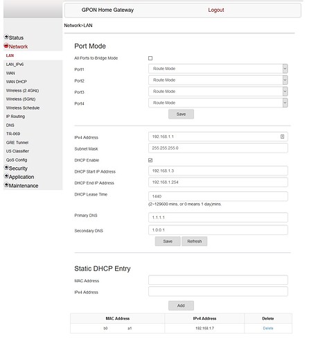

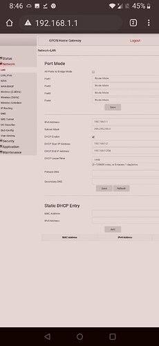

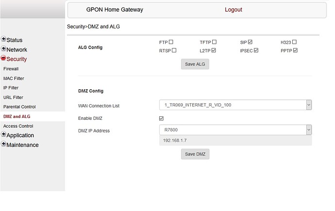

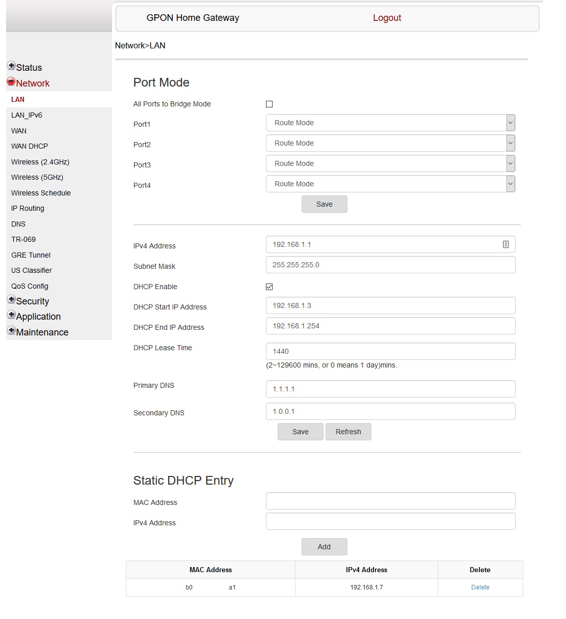

1 - LAN Settings: To get your other router working seamlessly first you need to know the MAC address of the other router you are connecting to the airtel one. This is usually written itself on the router at the back. This is because you need to setup DMZ on your airtel router for your other router (step 2). For that you need to give that router a static ip from your airtel router. Use any one from its DHCP range (i set mine for [192.168.1.7](’
https://192.168.1.7
) for example).

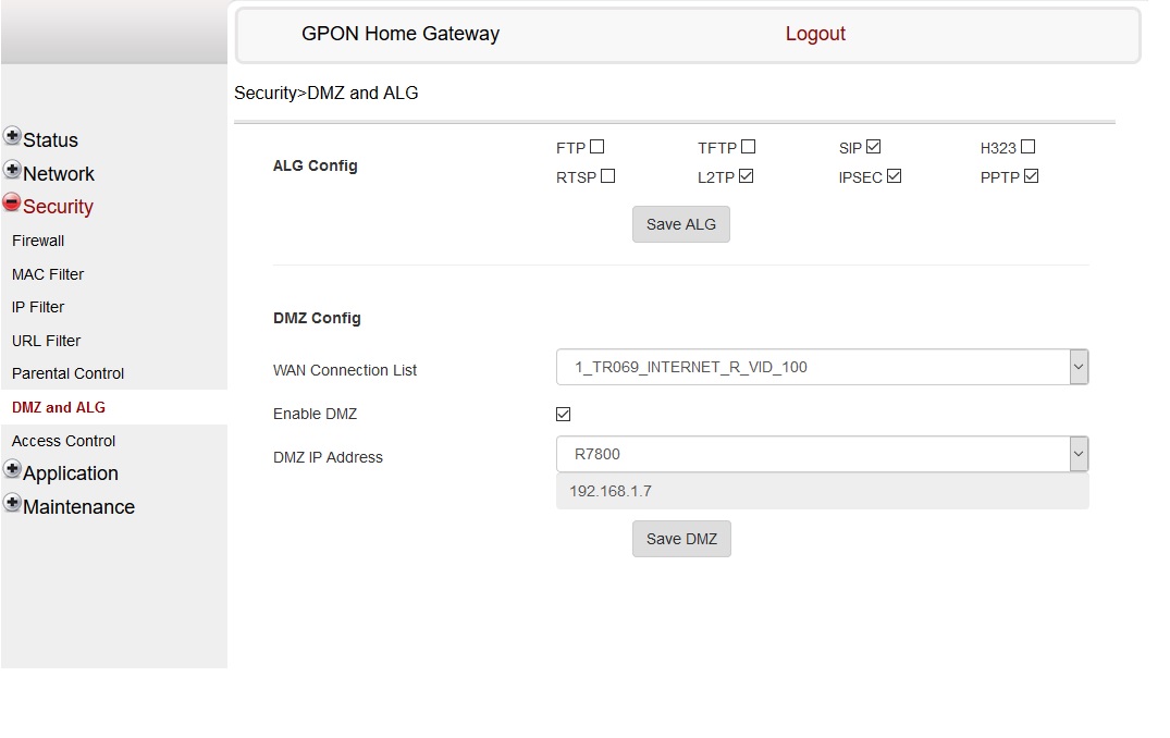

2 - DMZ: Enable DMZ as below after you have added a static entry for your other router.

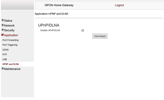

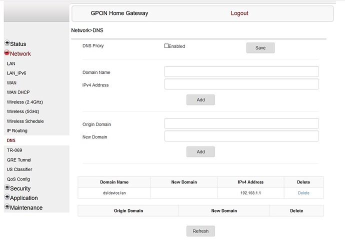

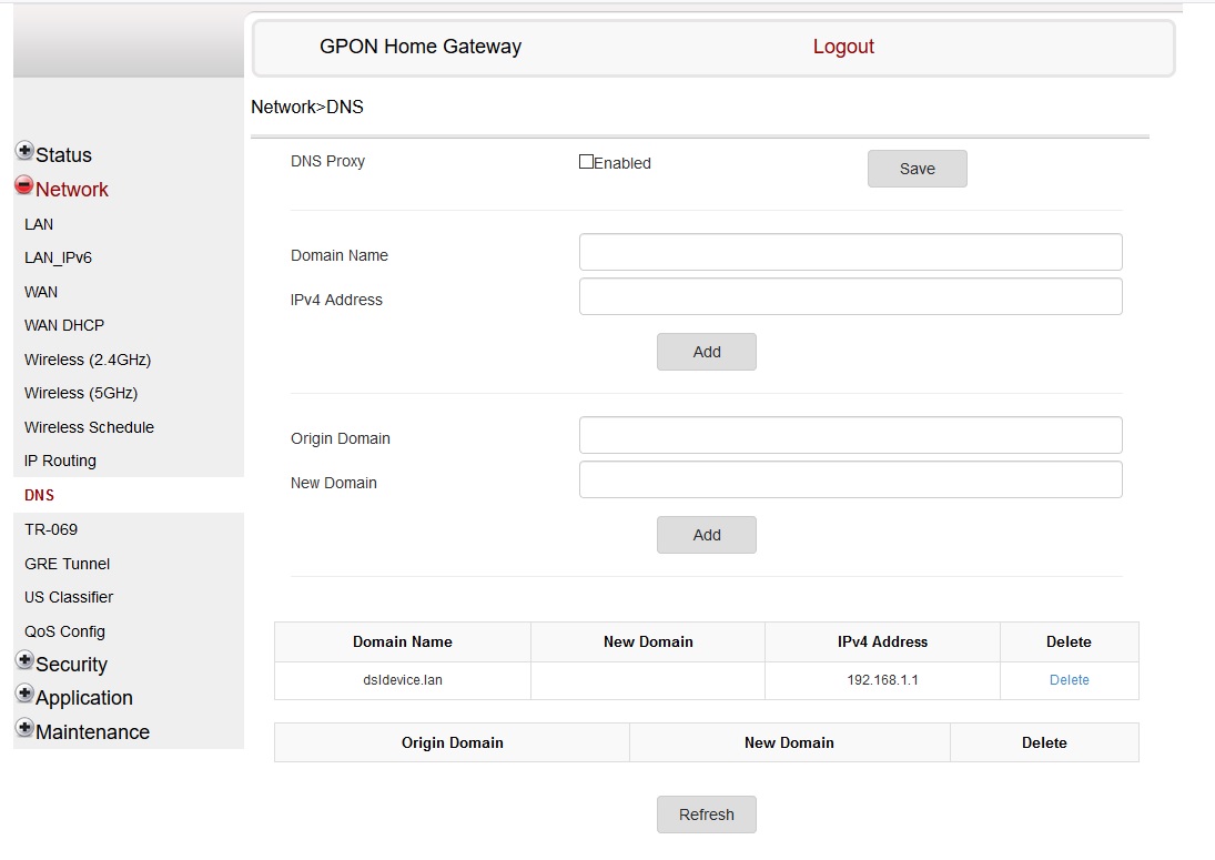

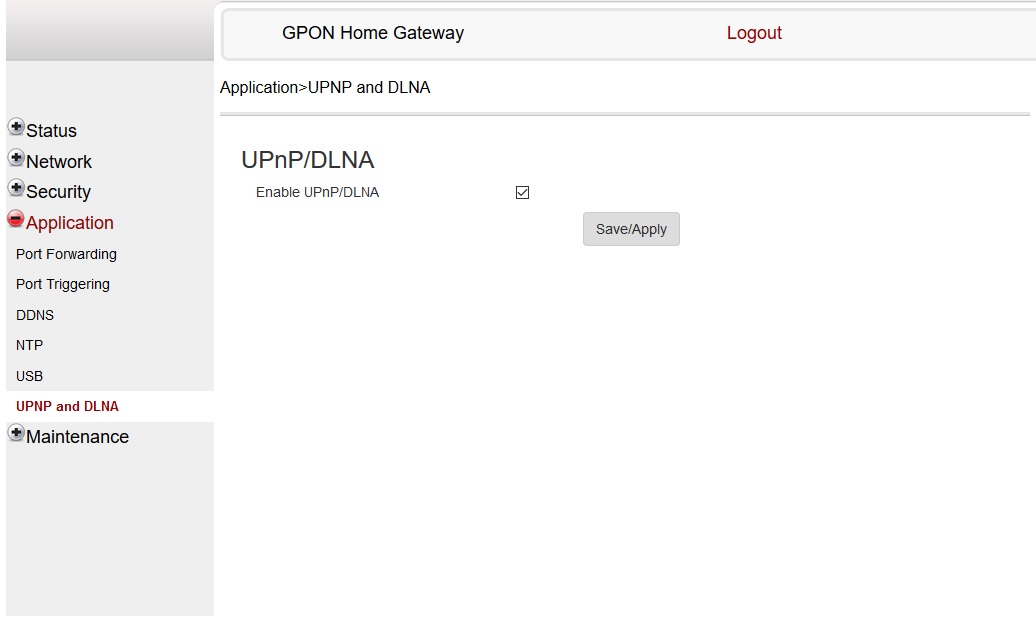

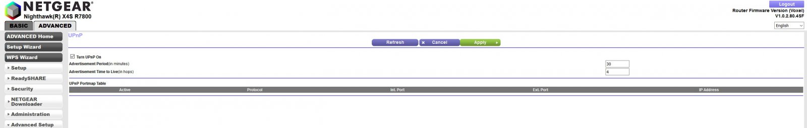

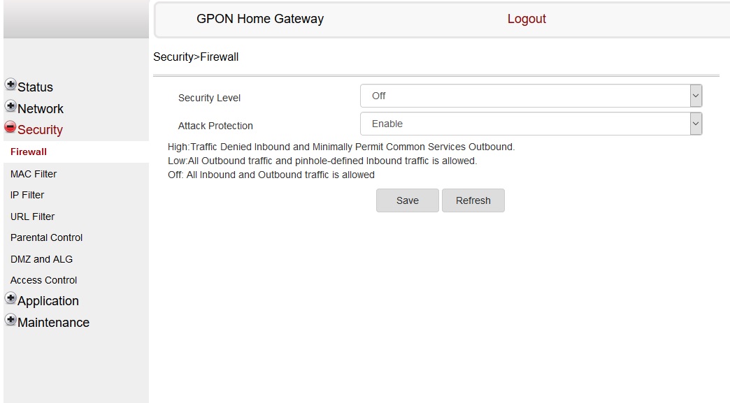

3 - Finally DNS, Firewall and UPnP settings need to be like this (if its not already)
Rest of the settings don’t need to be touched.

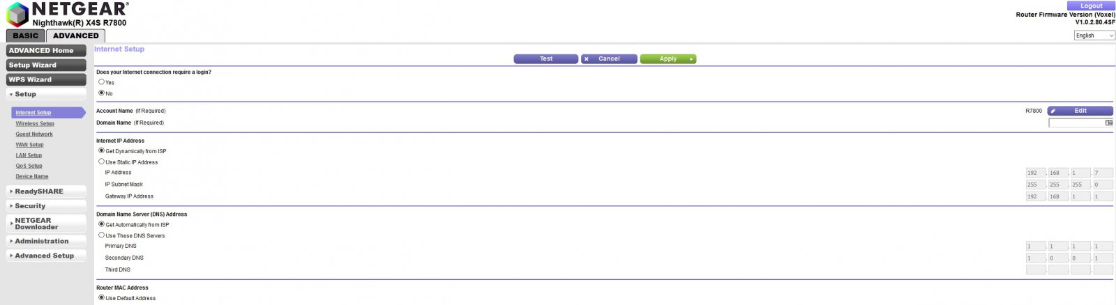

4 - Internet Setup (WAN): Since Airtel will be making internet connection you don’t need to using your ISP login settings on your other router and let them remain on default. Here are mine on my Netgear for example:

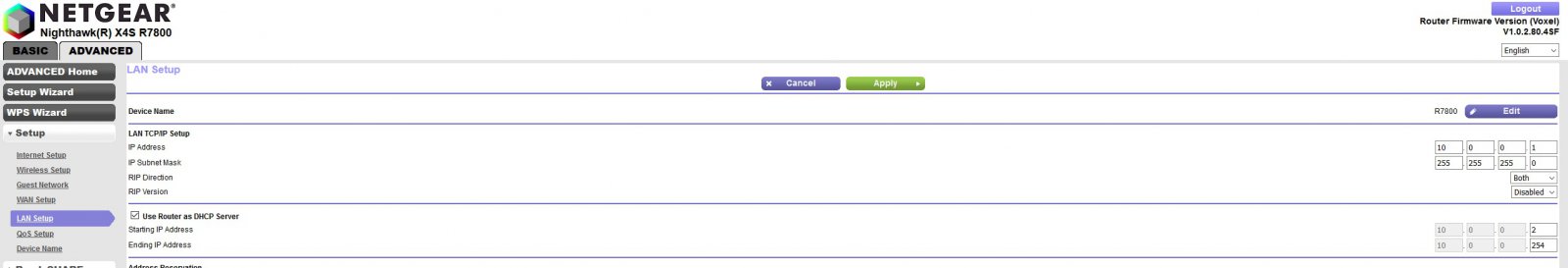

5 - Lan Settings: My netgear auto-switched from [192.168.1.1](’
https://192.168.1.1
) to [10.0.0.1](’
https://10.0.0.1
) once it detected a conflict with airtel. You can use any ip adress you want like [192.168.2.1](’
https://192.168.2.1
) or [192.168.0.1](’
https://192.168.0.1
) etc

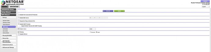

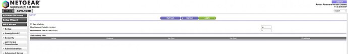

6 - Nat and UPnP: Nat should be disabled on this router as it creates a conflict with airtel where it is enabled

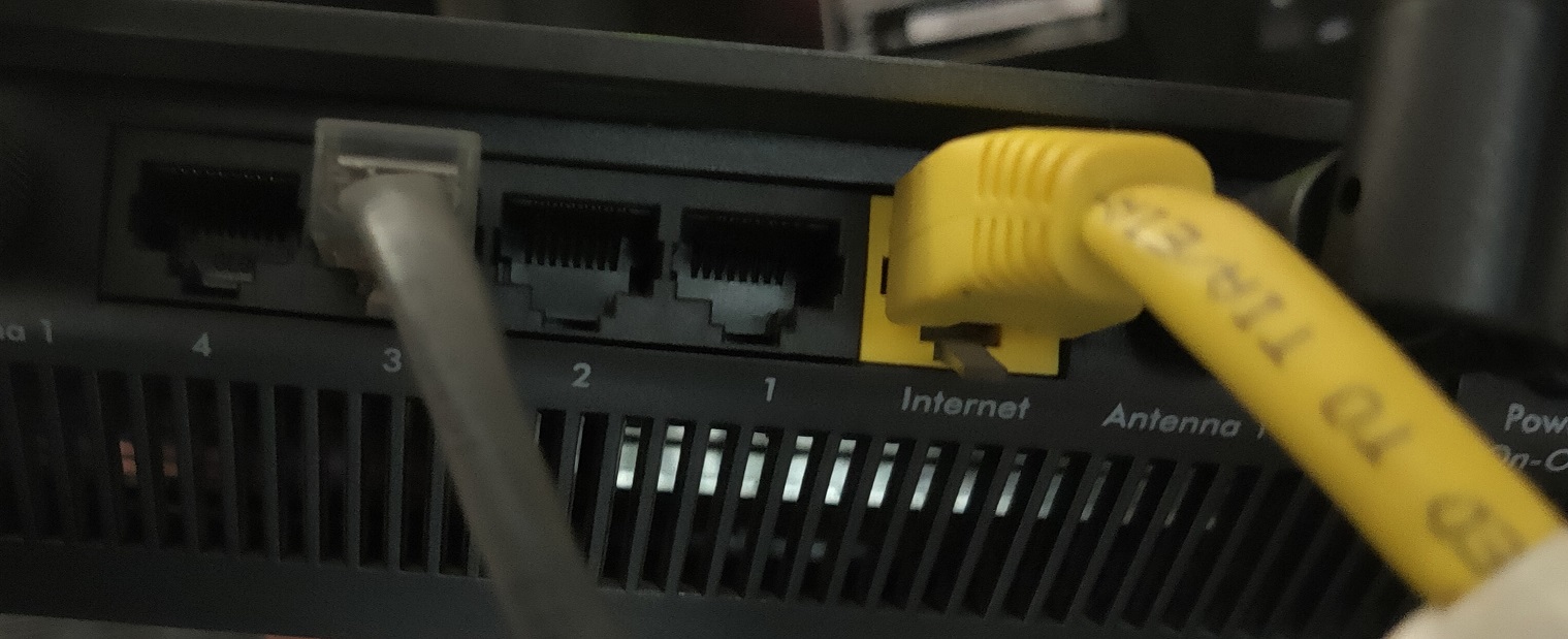

7 - Now with both routers configured connect them using ethernet cable. The cable should go into internet (coloured) port of your other router.

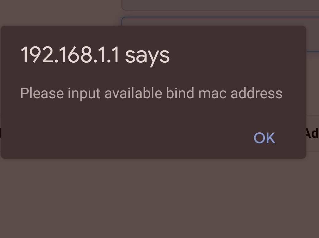

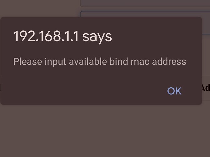

Hi, I have nokia g 2425 g, router given by airtel, I would like to use asus GT AC 2900 router, instead of the nokia router. I followed the instructions as shown, but I can’t add the MAC address of the asus router. Can you help me, please. Thanks
What’s the problem happening? Should be able to add under static dhcp?

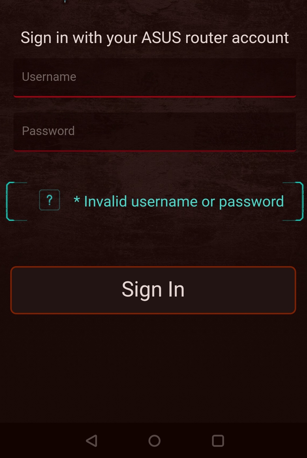

I am unable to add the MAC address of my asus router. I am attaching the error screenshot.
Connect that router with the airtel one either through cable or wireless then you should see the device’s mac as one of the connected devices. You should be able to add then. I think that error is coming as you can only add a static dhcp to one of the already connected devices.

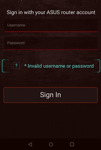

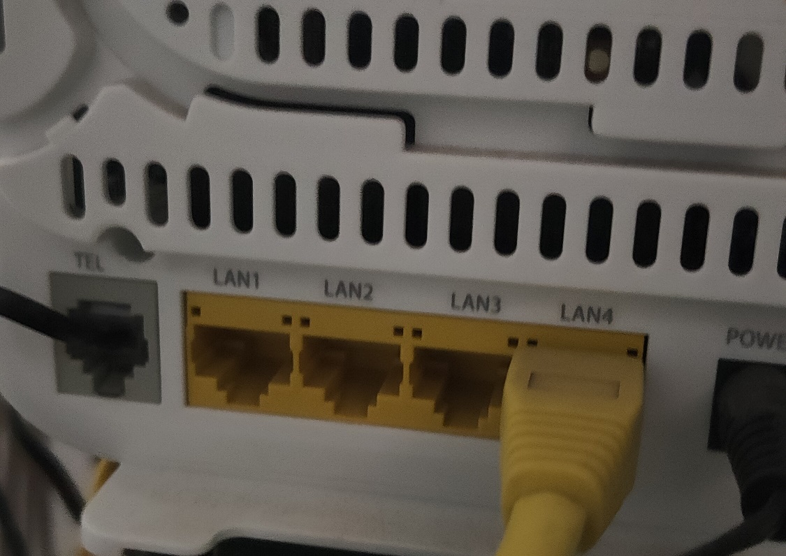

It’s connected to LAN port No 4 of nokia router to WAN port of asus router, but still the same error is displayed. I reset the asus router and simply reconnected the cable to WAN port and I got connected, I could see and use airtel, 2.4 ghz and 5 ghz, and also asus 2.4 ghz and 5 ghz bands. But the issue is I am unable to login to router page of the asus router. Any help would be appreciated. Thanks
Hi, is there any fix, I am happy to use your methods, but getting MAC binding error, please help me. Thanks
to login to your asus router you will have to put manual ip in your pc which should be in same subnet as your asus router and then try to login
