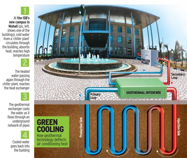

This image is from one of the links in your post. Looks like an interesting concept but I doubt it can be done efficiently on a small scale. This is something that has to be factored in at the initial stages of the property development and will make sense only for the centrally air-conditioned buildings.
This will especially make sense as more and more companies move towards water cooled data centers. Which is a relatively new concept still.
I’m guessing you still need an AC i.e. a heat pump? The ‘chiller plant’ in the image would indicate so. From their description it sounds like the heatsink fins in the AC’s ODU will interface with the geothermal unit underground instead of exchanging heat with the hotter surface air.
Had readup on this somewhere - it works if you have large scale needs only. On a smaller scale - it is not going to be efficient.

Yeah - but AFAIK, it still is efficient. And he would need a water source.
