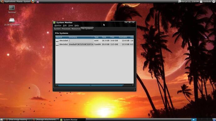

How to figure out name of boot hard disk in ubuntu? Is my boot hard disk dev/sd6?
So the command will be this??
Sorry I can’t access that image, work blocks such sites :). I’ve never tried krishnadu’s method but I’m not sure if it would work. Anyway, to answer your question your drives probably looks like this:
  1. /dev/sda == this means that this is the first HDD detected by Ubuntu. As you mentioned /dev/sda6 is probably where the /boot partition is.
  2. /dev/sda1 == is the the first partition and probably has Windows installed on it. So you’d want to go with /dev/sda1
In that image I forgot to mount my partition on which Windows is installed.. :face_with_tongue: (Anyways I’ve attached the correct one).
Hmm so my Windows is installed on /dev/sda1 I think.
So command will be:-
Correct me if I am wrong.
Yep that should do it! Now save the file somewhere and restore it after windows install with an ubuntu live cd. Just to be sure though, back up your data!
