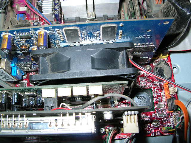

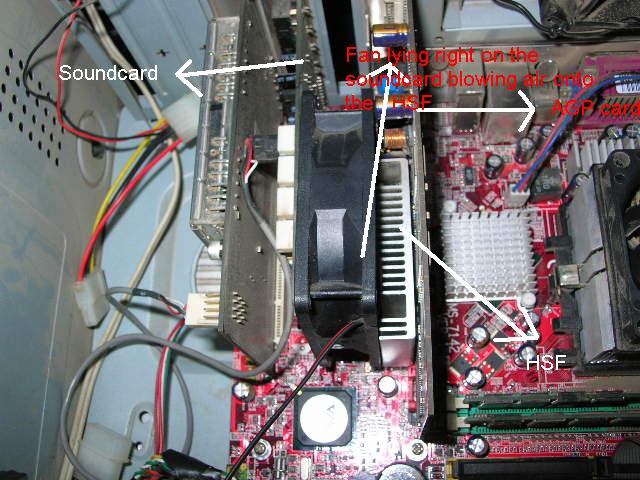

as u can see from the pics below…ive just placed a 80mm fan on the PCI card bwlow i (sound card ) to blow the air directly onto the HSF of the AGP card… . can anything more be done …which can be worked out cheaply?..
some smaller fan or anything??.
better fir the fan perpendicular in the card … as in this arrangement fan can’t suck the air coz of sound card… 5200 usually doesn’t get much hot
Ya , the fan cant blow air on ur card since its blocked from behind.

According to the PIC given, your FAN setup is 100% wrong. It is even worse than without the FAN.
Reason:
It can be clearly seen that the SOUND CARD+FAN+AGP CARD all together has created a airless zone on the Heat-Sink of the AGP card.
After all, the FAN needs open space of drag air and throw it to the card, which is totally blocked by the SOUND CARD.

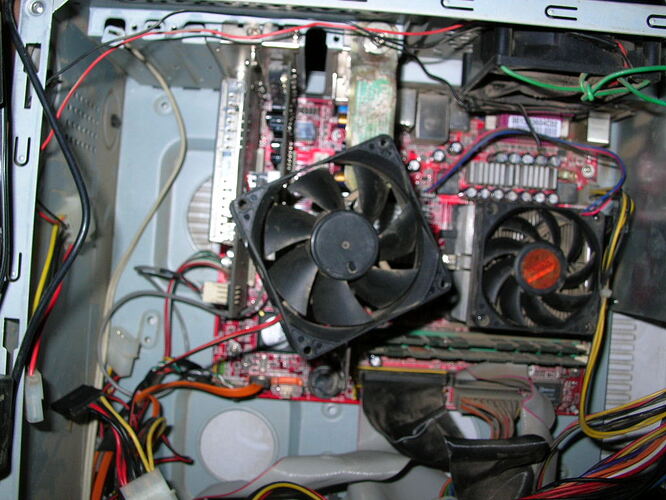

ok.heres’ how it is now…had to put a small extension to make the fan come close to the HSF of the GPU… :face_with_tongue:
the temperature of the HSF (acc to the analog thermometer i have ) is ~ 34 degrees :blush: @idle…will post the load temp after a few hrs of CSS..:slight_smile:
done… :blush: …working fine for me…after 2 hrs of css..~38 degrees..:slight_smile:
