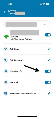

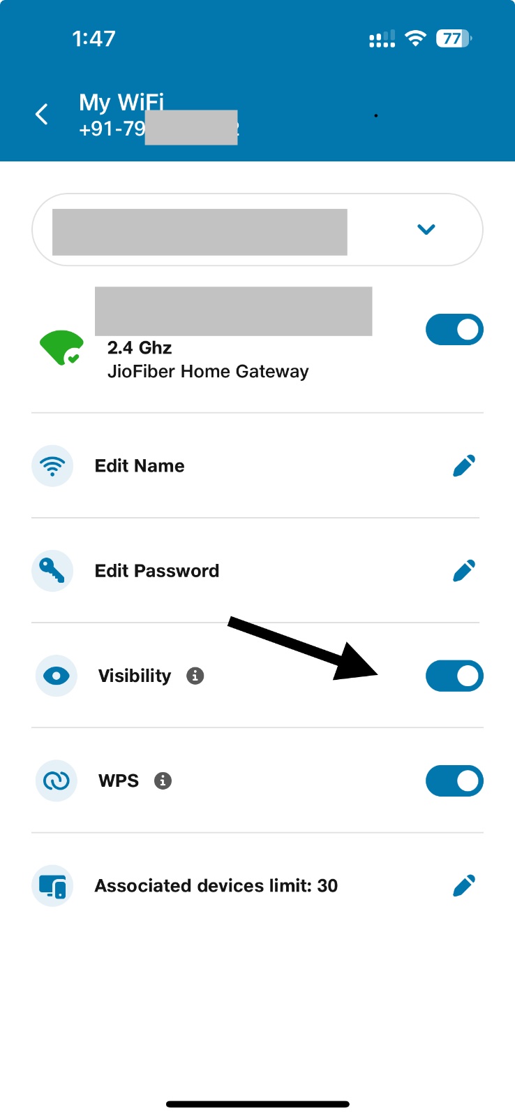

You can do it from myjio app if you are not able to find the settings in router ui.
Yes, earlier it was possible from there also. But now they keep toggling back ON on their own after refreshing the page.
