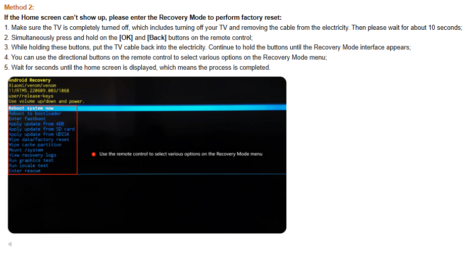

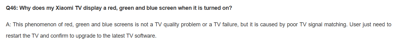

Couple of things I found.
thank you will try these and update on the situation
