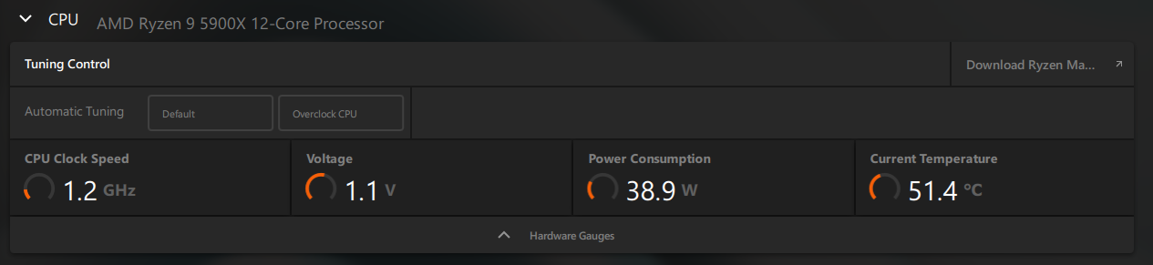

try the power saving option when on desktop mode. My 5600x sits on 2.2 Ghz than 4.2 Ghz and hence is on lower temps and saves electricity as well.
When I want to game, I put it on high performance
I do something similar too. Instead of full power saving I keep max CPU state to 99% instead of 100% so it doesn’t boost as high and min is 5% (like intel). Idle consumption is just under 20W and normal desktop usage goes upto 35W.
not relevant. I am on 4.2ghz oc on all cores. but normally its 1.7 or 2.2 or anything lower ( 0.3mhz is the least I have seen ). it is done by amd automatically. why manually change it ?
the above is when my youtube is one and I am also working and plus I was posting on this thread :face_with_tongue:
Any specific option to tweak in Power saving mode or you selected the mode with all defaults..
What tool is this?
by default only. thats ryzen master
Its by default. Ive never seen it go lower than 2.2 . Maybe Im missing something in power saver settings or in bios.
How did you manage to go so low or is it by default ?
MIne too always stays stock @1.7ghz if I enable power saving mode and it lags a bit so switched back to my custom setting profile.
I too thought but it isnt even if its written..may be themed version.
This is how Ryzen master looks usually.. and no theme change option as well.
