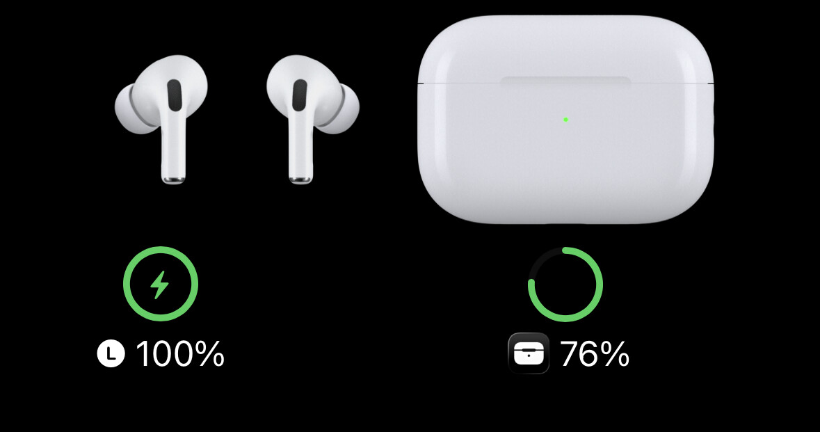

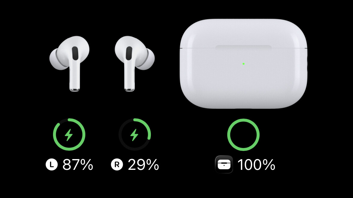

Couple of months ago, I started having an issue where the right AirPod charge percentage would be different than the left one. Based on initial reply over the Apple Support app, I did a reset, and it seemed to sync for a while.
However, in recent weeks, the issue reoccurred, and a full reset was of no use. The right one was either fully dead or at 20-30% when taking out of the case. I applied IPA to the contacts and again for a week or so it seemed to be fine.
However, now the right one doesn’t charge at all.

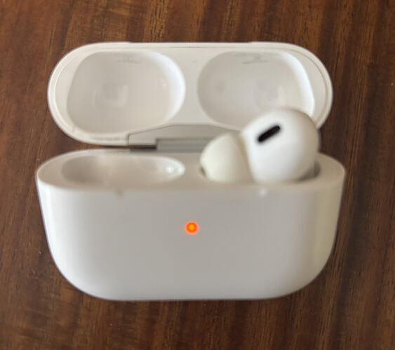

If I put the AirPod in the charger, the LED lights up orange indicating that it is detecting the AirPod and that it is charging but it never appears in the menu. I tried putting it in different positions and cleaning the contacts again but that too isn’t doing anything.
Does anyone have any suggestions as how to proceed further?

Hold it down (pressed with finger) and see if it charges, if it does then its the bent pin situation.
That was the case initially, where it seemed that certain angles worked every time. I also had applied tape at one point to ensure a certain position but now nothing seems to work. The pins in the case are still springy and as I said the case detects the AirPod every time it is inserted.

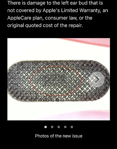

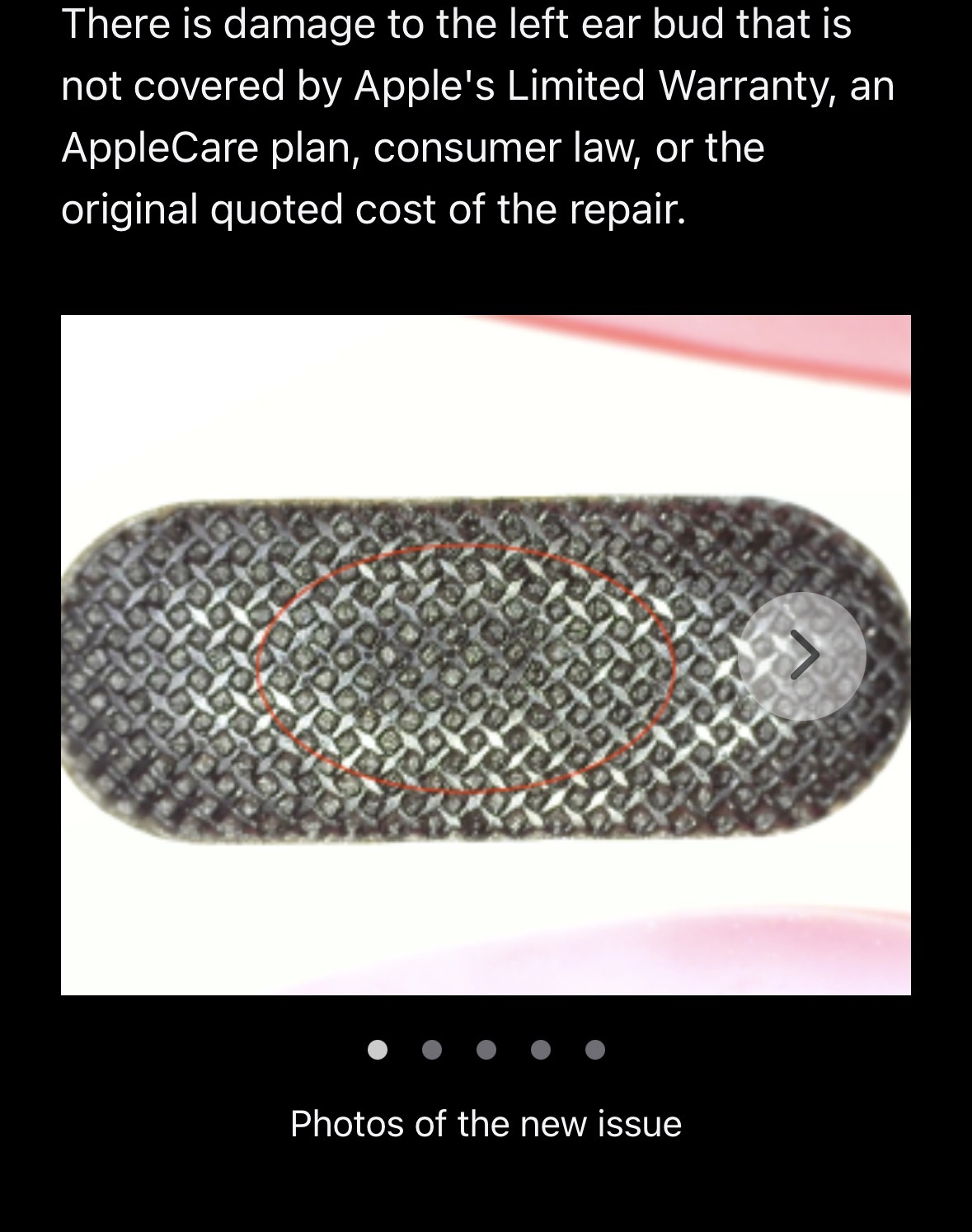

However, I then received a message stating a new issue being found with the working AirPod.
Apparently this is not covered even by AppleCare as it is a corrosion issue. So now I am expected to pay over 10k to get everything repaired or receive the AirPods back in the same condition.
Seems like a waste of money either way and their refusal to fix one issue and not the other doesn’t seem like much of a choice.
Anyway paid for it as it seems to be the only option considering I have to pay more for new options in the same ballpark, while without repairs the existing one is useless considering it is not pairing with any device at all.

Unfortunately, it gets worse. Received the replacement today, and they only replaced the AirPods while sending back the old case. So the diagnosis by the service centre on the fault being with the case seems to be wrong as I suspected.
The price I paid (around 10.4k) is apparently for only AirPods replacement. What takes the cake is that while they came up with the out-of-warranty issue with the left AirPod, the right one is mentioned as “not powering on”. So it seems I was made to pay for the AirPod which should have been covered by warranty.
Apparently, when they said “in addition to existing issue” they meant only the right AirPod which I said was not working and not the issue diagnosed by their service centre.
