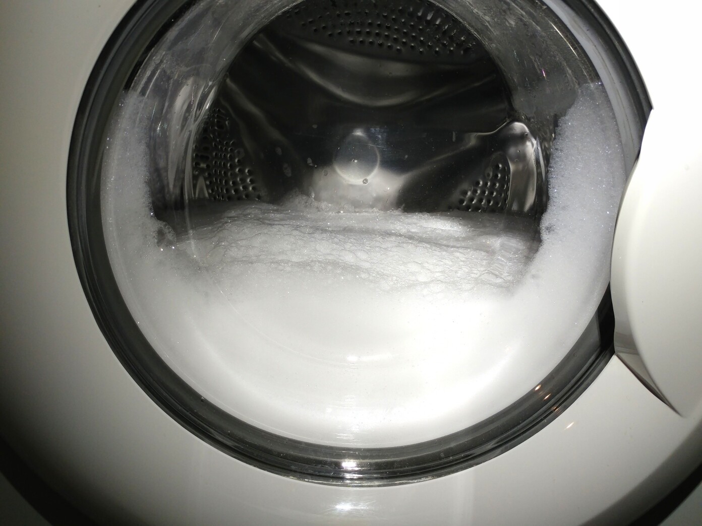

The above is using that 'Atomic’ cleaner. Completely full of foam. Not compatible with LG’s tubclean cycle. This will also happen if you use just 20gms of Vanish powder with no fabric. This is bad because that foam goes to the back and can affect the bearing seals. You never want this to happen.

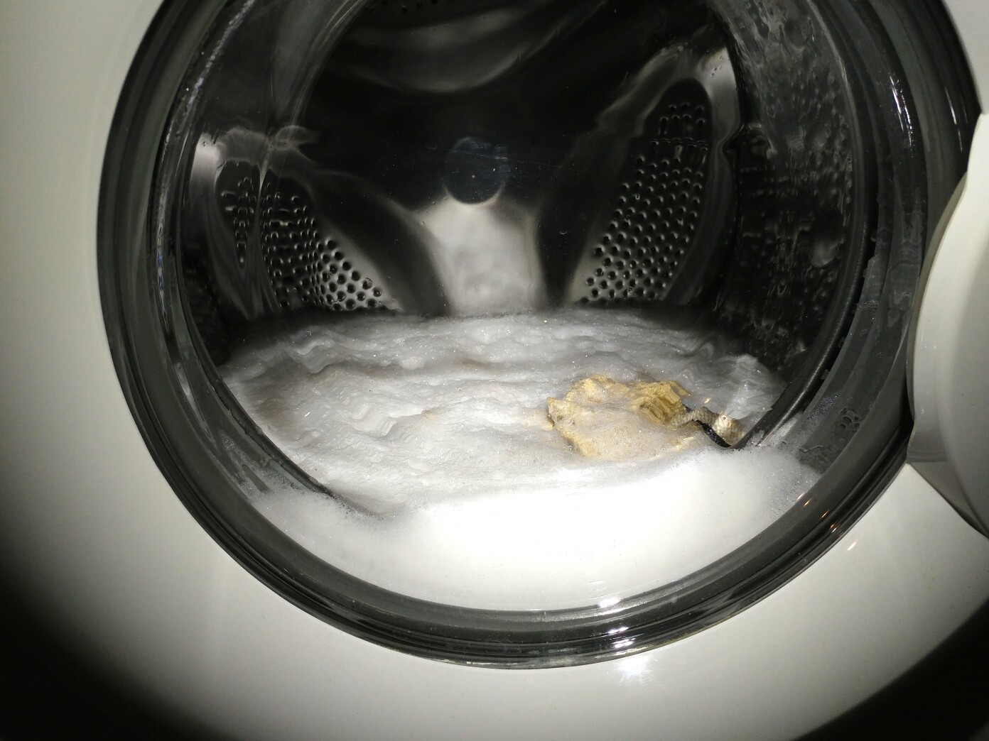

Using mops and 20gms of Vanish. The foam is more controlled.

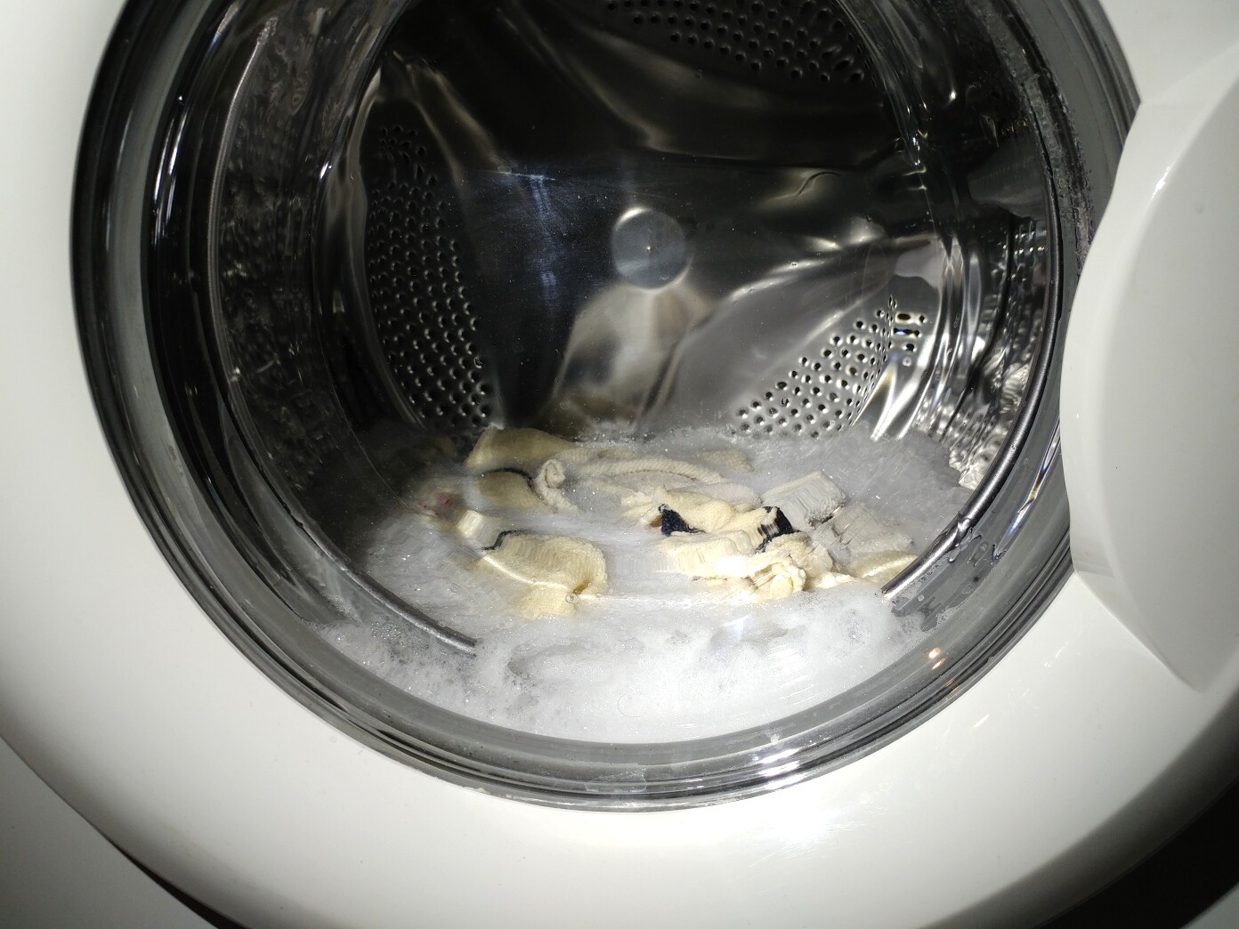

With mops and 50gms of Vanish. Much more foam but still controlled.

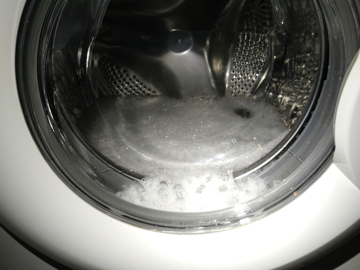

With this one i pre-dissolved 50gm Vanish powder in some tap water and poured it in the detergent drawer before starting the tub clean cycle. Seemed to have brought down the foam. I don’t think it affects cleaning efficacy as it will get dissolved with water few minutes into the tub clean cycle anyway. The previous ones i was just putting measured amounts of powder in the detergent drawer.
and finally this is 50gms of the Labogens percarbonate. There are no mops and yet the foam is not much. I would still recommend using mops in there as it will clean better.
When doing this process after twenty minutes pay attention to the foam that collects in the door gasket. Use a torch to look at it. I noticed some black dots the first time i ran this kind of wash. I knew it was working as it had pulled off some residue. I never thought to look for that before. A bright torch helps see things better.
