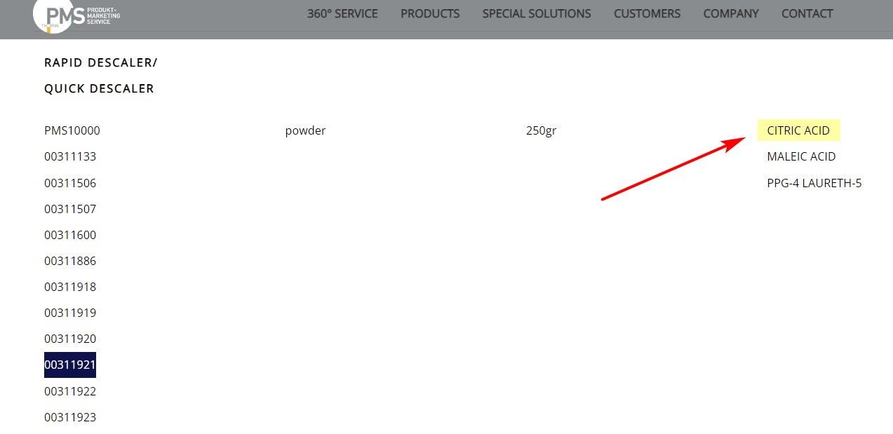

The magic number is 00311921, plug that into [website](’
https://www.pms-thomin.de/verzeichnis_inhaltsstoffe/
) of the company they outsourced this from and see attached for what the ingredients are. Having seen other descalers ingredients you can presume Bosch’s own descaler is 90% citric acid with the remainder maleic and a pinch of the last one.
