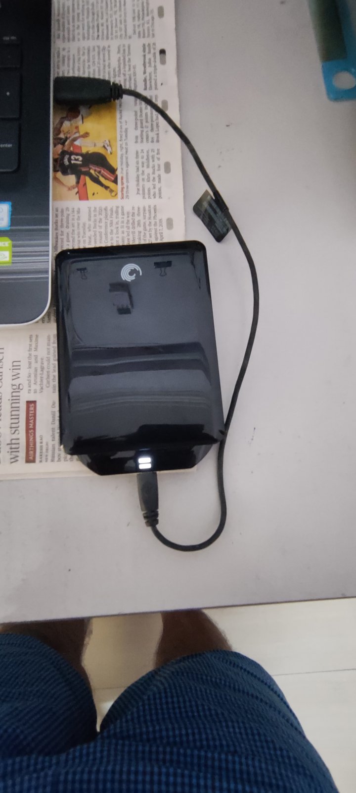

Guys.. I have Seagate Free agent Goflex USB 2.0 hard drive 1 TB which is in working condition. However due to the loose/bad USB cable it loses connection with the PC. I was wondering if it’s possible to remove Hard drive from the present casing and put it in another enclosure which has a dedicated cable. Something like this.. https://www.amazon.in/ORICO-2577U3-BK-Enclosure-Capacity-Business/dp/B07222HQKP/ref=sr_1_3?crid=7CB9APBP3NPS&dchild=1&keywords=hard+drive+case+usb+3.0&qid=1611294775&sprefix=hard+drive+case,aps,366&sr=8-3
Further reference to my hard drive.. https://www.flipkart.com/seagate-freeagent-goflex-2-5-inch-usb-2-0-500-gb-hard-drive/p/itmczcrym85pdps6

After seeing this adapter, I have dropped the idea of removing hdd from the casing and instead will just remove the existing adapter and replace with the new one. From what I see, there should not be any problem.
Let’s see, I should get it today.. will update my results.
Only gripe is, if it doesn’t work, there is no return policy, only replacement :roll_eyes:
Update: So it won’t fit with the existing case so will have to remove the drive from the case..
@@Nitendra Singh are there any plain cases available where I can Use the new adapter with the plain case. I would not like to keep hdd open due to fear of getting spoiled.
So I have practically tried all the 2.5 inch hdd cases available from Orico.. None of them would fit despite being in-line with the dimensions. It seems that the height of the drive(the thickness of the top protection mechanism) is a factor which won’t allow the external drive enclosure to close properly. Are there any options for me now?

I still don’t get this… When I measure the thickness from top to bottom of the drive it shows 1.5 cm. But when I put it in tne case, the top enclosure just won’t fit.
https://www.amazon.in/dp/B07222HQKP?ref=ppx_pop_mob_ap_share
https://www.amazon.in/dp/B0765473F3?ref=ppx_pop_mob_ap_share
Tried all of the above. It seems none exists for thickness atleast 1.5 cms. The second one was atleast close but even that didn’t work out.
Since the drive is now working (earlier I thought the drive was dead, turned out the adapter was causing issues), I can use it for regular use. But with no case available, have no option but to use it with the new adapter.

Since none of the cases which I ordered online would fit, I went for USB to data cable. But leaving it inside the pouch would rattle its head so I would be using a bubble foam to prevent it from moving within the case in case the drive is mobile.
Seriously disappointed with Seagate. It measured thickness is 1.4cm and all enclosures with thickness greater or equal to 1.5cm won’t fit my drive.
