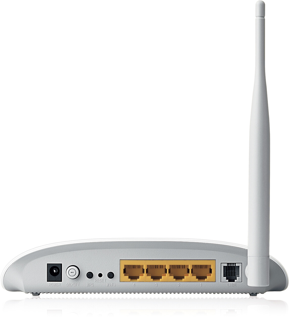

That is the problem. It has no WAN port. Only 4 LAN ports and 1 DSL port (RJ11)
Its not possible check closely, on one of the ports (mostly first or fourth) , WAN will be written within brackets or something…

Well according to this picture , the WAN port is not mentioned on the router , but there is one , manuals might help you !

The only problem is figuring out , which is the WAN port !

I sure there are no wan ports?
Look closely..
The wan port is the ADSL port!! I sold of mine. I tried everything and it did not work. Even the technical support says its not possible.
The problem is the NAT only works with ADSL. tp-link has models that do NAT off WAN as well as ADSL. This isn’t that model.

Yes, your model has the EWAN (tp-link speak for ethernet wan connections).
Whereas the 8951 does not have ewan.
I thought there was another model that also had ewan but it seems the 8968 is the only one.

another thing you need to take into consideration that dhcp won’t be enabled as long as you are using regular rj45 as WAN. you can connect it to a LAN port and configure Static/Dynamic IP for the WAN
Won’t work unless the router can NAT to those addresses. That won’t happen with a model that cannot do WAN on the ethernet port.
