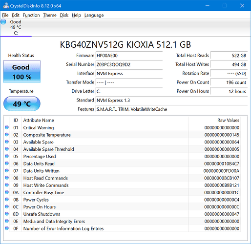

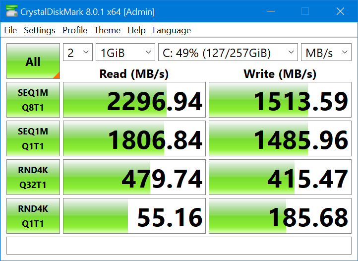

Main Specs:
CPU: Intel Core i5 11th gen model 1135G7 with integrated Irix Xe iGPU
RAM: 16 GB (2x8) dual channel 3200 mhz. (not sure if it’s soldered/upgradeable)
SSD: 512 GB NVMe m.2 PCIe 3.0 (not sure if it’s x2 or x4)
Display: 14 inch LED IPS 250 nits 45% NTSC spec Full HD 1080p
Wifi: Intel AX201 with BT 5.1 chipset
OS: Windows 10 Home edition (single language)

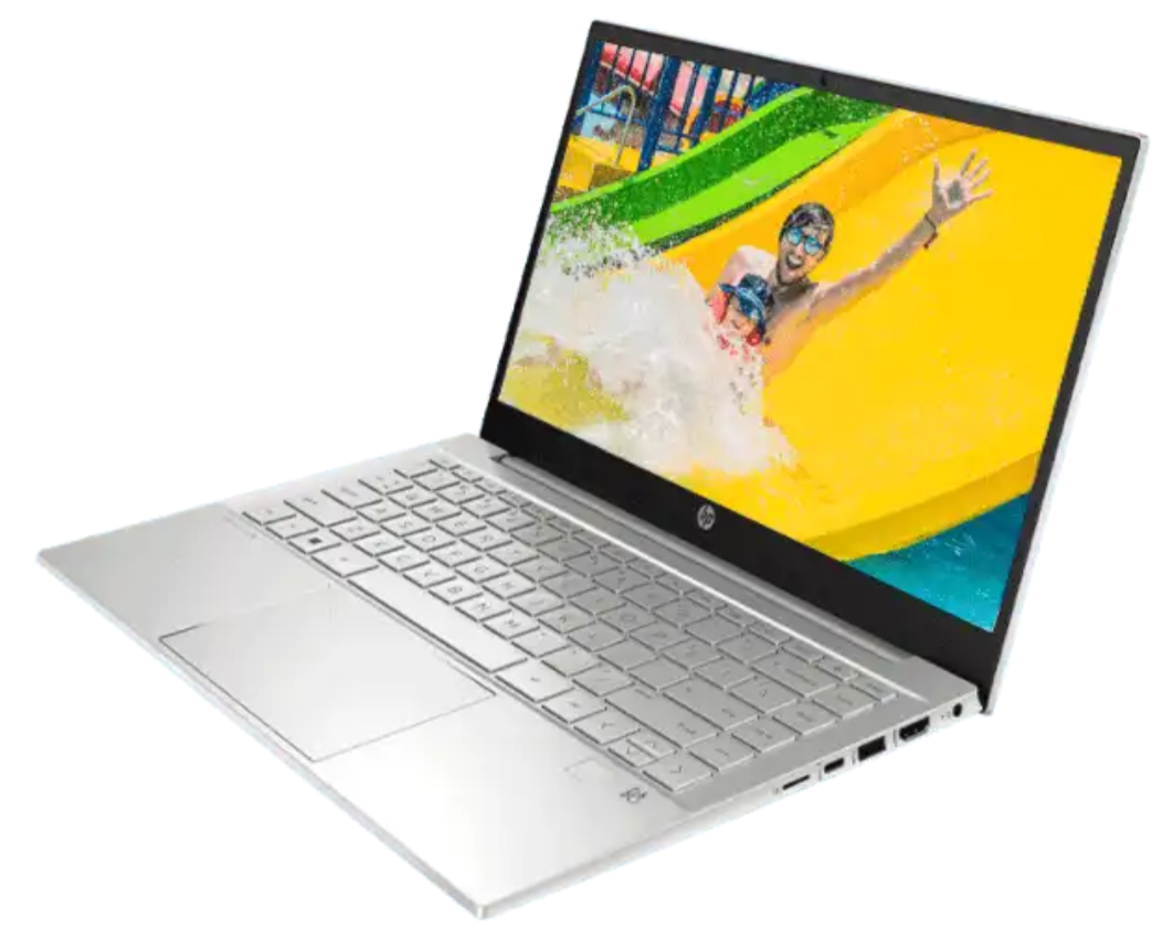

Quick review notes:
  • Body/shell is supposed to be plastic but feels like aluminium, good enough build quality.
  • Display is not bad for 250 nits 45% NTSC - even bright enough outdoors in bright sunlight (not direct sunlight though). Hardly any backlight bleed on my unit.
  • Keyboard is US layout - does not have the India Rupee symbol - but that is OK as you can just select English-India keyboard layout in Windows/Linux.
  • Display bezels are pretty narrow - this 14 inch model is about the same size as my previous 2015 model HP Envy 13 inch laptop.

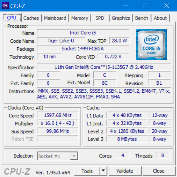

CPU thermal performance:
Ran the CPU-z stress test for a few minutes on battery and observed some numbers in the HWinfo64 tool.
Idling CPU power was under 1 watt, as low as 0.7w and at load was 15w with Windows power setting to “better battery” and 18w with it set to “best performance”. Did not try while connected to AC power so far, maybe later to see if the CPU goes up to the rated 28w limit.
Clocks were around 800 mhz to 1.5 ghz at low to light load and around 3 ghz at full load.
Temperatures hovered around 40-45 C at low to light load and around 70-75 C at full load. The surface and bottom of the laptop got very mildly warm to the touch, not like the scorching levels of my old HP Envy with the Intel Core i5 6200U skylake dual core 15w CPU while running single thread loads!
The fans hardly spun up (or I didn’t hear much sound) for the few minutes that I loaded the CPU.
Oh I should mention for single core load it briefly boosted to 4.2 ghz and settled at 4 ghz while running the CPU-z bench run.
