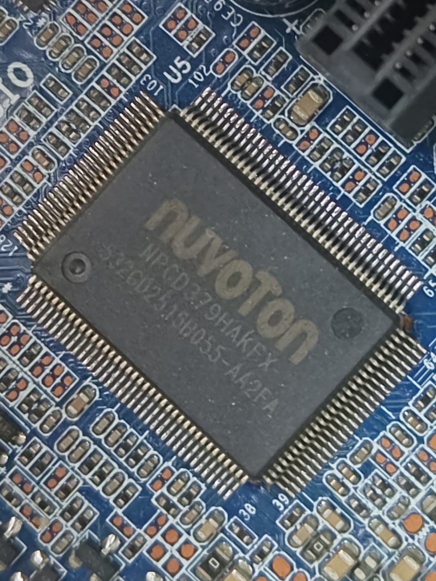

  • After doing some research, I found out that the HP Z440 theoretically supports a TPM 2.0 module (part number 863078-001). However, upon opening my workstation, I discovered that the TPM chip (a Nuvoton NPCD379HAKFX) is soldered onto the motherboard. This chip is commonly associated with TPM 1.2, making it impossible to upgrade to TPM 2.0.
If anyone here has successfully upgraded their Z440 to TPM 2.0 I’d really appreciate your insights. Maybe I’m missing something obvious or need to dig deeper into firmware configurations.
Thanks for reading! Looking forward to your suggestions or guidance on this.
This is prolly the TPM chip on my motherboard
Any input?
